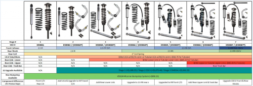

So I am hearing and it came and and I priced at 2. I'm looking at acquiring the vehicle next year when I have myself set and ready. After that using the stock ome vehicle and enjoying some little trips. Overtime acquiring stuff 2 enhance the experience but definitely not in all in one go, I somehow win the Powerball lottery. Then you'll see a lot of post here of videos and pictures showing off what can be in asking for people's wish lists of builds lOL.Icon difference is luxury

I was agreeing with you on your previous comment. but i'm not looking to max out the 4runner. but you made some great points for me to think about. Also i heard hear about some folks not liking icon, why is that? and the history of the company.The suspension setup I listed had nothing to do with looks and everything to do with safety while carrying 500 pounds of weight in an SUV that had suspension capable of a mall run from the factory. Also chose parts on the basis of low maintenance and high reliability.

WHAT? ARE YOU KIDDING ME? PRICY YES BUT IN MY OPINION WORTH IT!!!!I was agreeing with you on your previous comment. but i'm not looking to max out the 4runner. but you made some great points for me to think about. Also i heard hear about some folks not liking icon, why is that? and the history of the company.
thats good to hear. i was worried the company may have had some misgivings in the past that made some bad blood with the community. YES i saw those prices and they are high for sure lolWHAT? ARE YOU KIDDING ME? PRICY YES BUT IN MY OPINION WORTH IT!!!!
you will always have haters on anything! people like to bitch!thats good to hear. i was worried the company may have had some misgivings in the past that made some bad blood with the community. YES i saw those prices and they are high for sure lol
