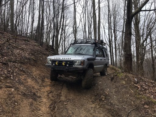

Made it to hurricane creek this past weekend. I always forget to take pictures. So the first two are mine third one is from a guy that snuck one in of me, I normally hate being in pictures, so it’s probably best i didn’t know he was taking one. Still waiting on the Fox shocks to show up. Soon as they are here this thing is getting lifted!
