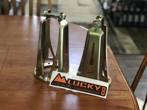

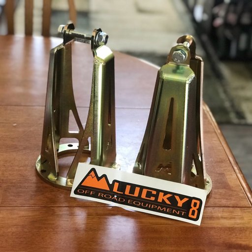

Got the new driveshaft in, what a world of difference, definitely fixed the problem. I was going to install the lift but then I found the shock mounts were delaminating. So I ordered some teraferma skeleton shock mounts. So maybe next weekend I’ll get the lift, extended brake lines and abs sensors installed

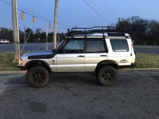

Hello, this is my thread for all the plans and current mods on my 04 discovery. My plans for the rig are being able to hop in it and go where ever I want and not have to worry much about reliability or its off road capabilities. I picked the truck up last September (2017). I was told by the seller that it had no issues and was ready to go out and enjoy. And it was for maybe 100 miles or so. The truck has the 4.6l bosch engine that are know for overheating and cylinder liner issues. Previous owner had pinned the liners to help fix the liner issue. It was pouring oil out of the pins, as well as the front main seal and the oil pan. Since September I have retapped all the pins and added in bigger stronger pins, replaced the oil pan gasket and the front seal. Engine has now developed a nice ticking noise and I plan on installing a new engine with top hat liners. This should take care of my reliability issues. The previous owner has also fabricated some front and rear steel hd bumpers. The bumpers are pretty great except the front one was not designed with a winch in mind, so it will be replaced at some point soon. As far as the off road capabilities goes, the truck has the factory center dif lock and a fully functioning traction control. I plan on adding in a rear air locker, limited slip front diff, and switching to some hd axles, as well as a hd ring and pinion. This way I can switch up to a 35" tire and not worry as much about breaking axles. Hope to see some of you all out there I go to uwharrie on a regular basis.
Mod List:
Engine
pinned 4.6l bosch engine
Cane Toad Snorkel
Rear exhaust resonator deleted for clearance
sealed factory air box
Drivetrain, Steering, and Suspension
Factory Center diff lock
Terra Ferma Hd steering bars
Terra Ferma steering dampner
2" terra ferma suspension lift kit (will be swapped out for ome 3" hd)
lucky 8 1" body lift
Extended abs sensors
Off-Road Accessories
Steel Front and rear high clearance bumpers
Safety Devices Roof rack
LR Genuine rear ladder
(4) 6 led light pods mounted to roof rack ebay branded
(2) led spot lights on front bumper ebay branded
265/75/16 milestar Patagonia tires
Planned upgrades:
rock sliders
HD axles
HD ring and pinions
Rear air locker
Front limited slip diff
New front bumper with 9500lbs minimum winch
New nicer lights
Rooftop tent
New engine with flanged liners
CB radio
Fold out table on rear door
Awning mounted to roof rack
jerry cans and mounts
Hi lift jack
3" ome hd lift kit
35" tires
new seats
vinyl wrap
rear work lamp
side work lamps

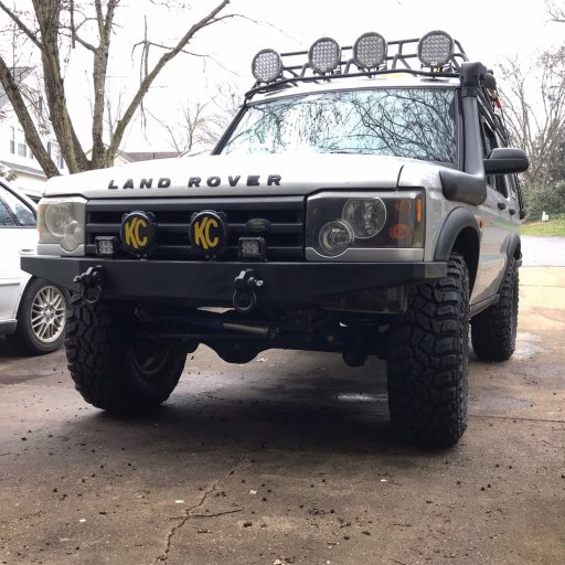

Question, why don't you just add a 2" spacer kit to your existing springs. For 35" tires you will need a longer front drive shaft, longer brake lines and possibly more. Do you watch Brummy Prepper video's ? I really like your bumpers (both) and planning to have mine built by a local welder using my own design. Would like to see a close up of your bumper mounting points showing the bracketry if you can ever get around to it. Will you build your own rock sliders ? That would be a nice addition to your picture file as an how too thing. Good luck with all your plans mine are not quite so extensive, but then I wont be going to places you are probably going. This Lanlubber loves his 2000 LRD2too !!
I actually have a Tom Woods driveshaft installed, as well as extended brake lines and abs sensors. I need to install my new OME 3” lift springs and Fox shocks. But at some point I will either go get some sliders made or just buy a set. I’m will add some spring spacers if the new springs and shocks are not enough lift. And no I’ve never heard of those videos I’ll have to look them up when I get a chance.

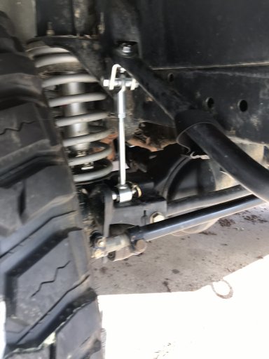

I did manage to get the swaybar quick disconnects installed yesterday and man what a difference in handling. It has way less body roll, I didn’t realize how shot the factory ones were. Think I may buy another set and put them on the rear. Feel like things are coming together nicely on this old rover. If money doesn’t end up going into one of my Subaru’s soon I may try and get some arb air lockers for this thing.IMG_3653.JPG

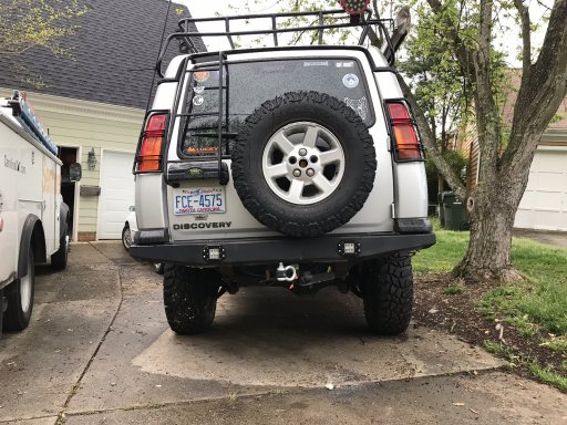

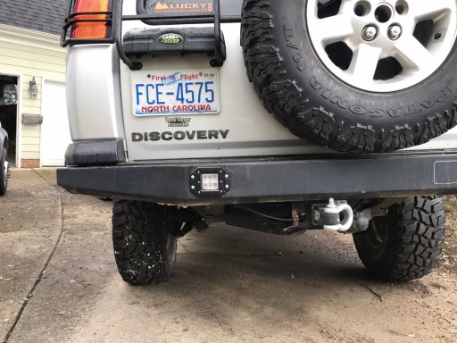

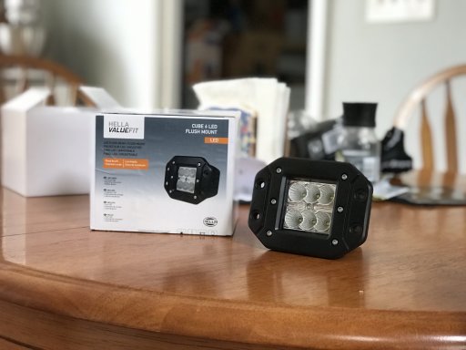

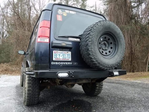

Got off work at a decent hour yesterday so I had a little bit of time to mount some lights on the rear bumper, I will finally have some reverse lights/ lower work lights. The previous owner had removed them when he built the bumper, and it has gotten me into a bind a few times trying to back up in the dark. So if I can get work wrapped up at a decent hour today I will go home and wire them up as well as the roof mounted work light. IMG_3683.JPGIMG_3684.JPGIMG_3682.JPG

Ordered a some sliders today and accidentally bought a new rear bumper too. When ever I get some free time I’ll mount them up and post a few pictures. Kinda taking the hot summer season off from camping and wheeling.

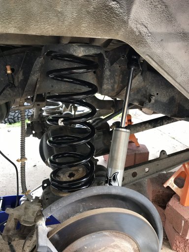

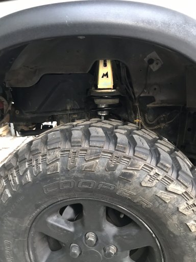

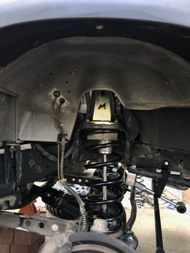

Well I was able to get done with my real job today at a reasonable time, so I came home and dug into the rover. I installed the springs shocks and new shock towers, it rides pretty decent unloaded, but I’m hoping the real difference is when it’s loaded down for a trip. View attachment 91529View attachment 91531View attachment 91532View attachment 91533

Yes I did just add some hella valuefit rear mounted bumper lights. The last owner of my truck built the front and rear bumpers. The new bumper that I bought has rear recovery points built in, side mounted tree protectors, and deletes the rear trim pieces that I’m always worried are going to fall off. Nothing wrong with my current rear bumper I just wanted something different and what I wanted happened to pop up for sale locally. Any suggestions as how or who could ship such a large piece out to you? IMG_3860.JPG

Yes I did just add some hella valuefit rear mounted bumper lights. The last owner of my truck built the front and rear bumpers. The new bumper that I bought has rear recovery points built in, side mounted tree protectors, and deletes the rear trim pieces that I’m always worried are going to fall off. Nothing wrong with my current rear bumper I just wanted something different and what I wanted happened to pop up for sale locally. Any suggestions as how or who could ship such a large piece out to you? View attachment 104390
View attachment 104391View attachment 104392
