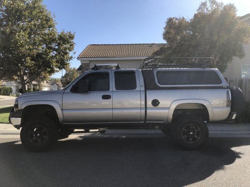

This is the setup I want on my 2011 Silverado. What topper is that ? Which Yakima rack it that ? It looks comfy and cozy in there !
ARE Z Series I think....I'll double check that.
The mattress I made custom (I've done it for a few others too) but basically it is 4" memory foam inside a giant envelope made from 90D ripstop nylon that is breathable but treated for water and dirt resistance - I got the fabric from www.ripstopbytheroll.com
It is Yakima rails (Aeros) and a Rolle basket on top...so far I like both but I'd recommend the ARE rack system after all my experience....it installs directly on the rails and is lower overall height.
With the Decked System, I can put stuff I need at night in the cubby holes at the corners, plus hang stuff if I need it. I am currently playing with velcro-backed organizers but I have some work to do on that.
And it is very cozy...now keep in mind that is a shortbed. I am 5 9 so it's not an issue, but just barely. Keeping the side windows open has been enough to keep it cool in 95 degree Houston weather. Snow is not something I have to worry about.
One other issue is spare tire management. I am playing with a DYI drop-down spare carrier right now, just need to find a place that will run a quick weld for me here in Houston. I'll publish the details on it, but basically it takes two different e-trailer parts. A little cutting and two welds and you have a rear-hitch mounted spare carrier that folds down. Cheap too. Pics to come soon.
Happy to answer any other questions...

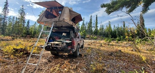

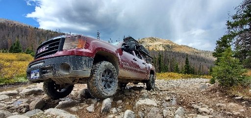

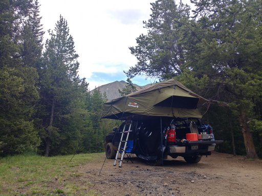

I have super chips tun with that deactivated, 91 octane tune for 33s. I love it. Much better fuel economy heres a recent pic of my rig

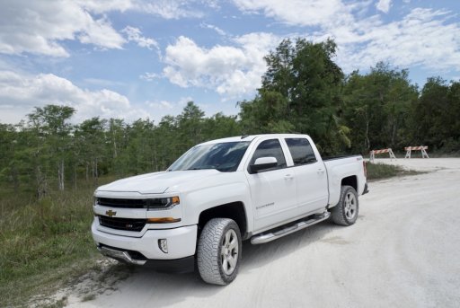

Awesome truck!!!

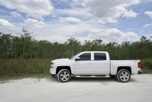

I joined this forum specifically in search for more information on outfitting my 2017 Silverado Z71. It is definitely slim pickings when researching Silverado and Overlanding in the same sentence. There is a lot of aftermarket support for other aspects of offroading with the Silverado...but not for overlanding.
I get that full size rigs are harder to get through certain trails...but to your point, that applies to all full size rigs...not just the Silverado.
Can‘t wait to move forward with the next steps in building my rig...here’s a current pic with very ltitle in the way of mods...

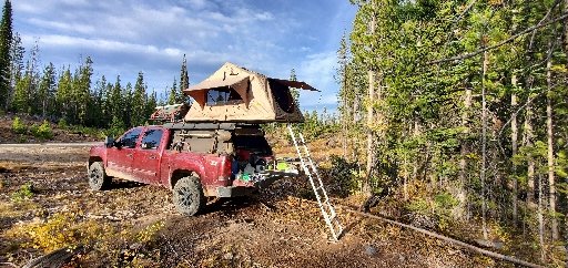

Here's a few more of my rig on my 10 day trip. Everything overland related I've custom built my self. Full slide out kitchen and roof rack set up that can be tilted to tuck an atv underneath when the softopper is down.

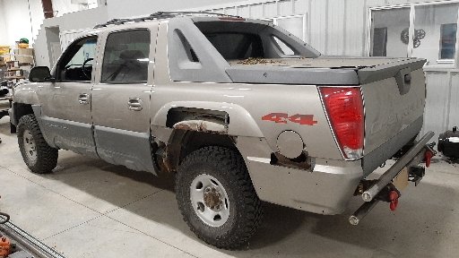

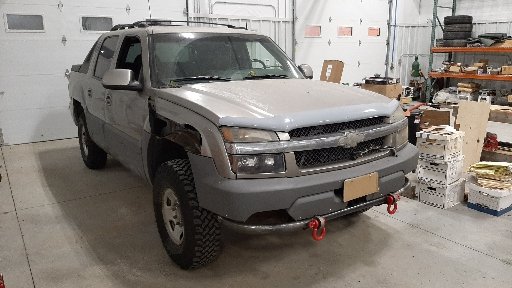

Here is the Avalanche. Taking advantage of a rusty front fender to add a snorkel. Other rust repair in the works. The salt on the winter roads in Nebraska is terrible so did not feel a winch would survive long without lots of maintenance. Added receivers front and rear for a removable winch.
