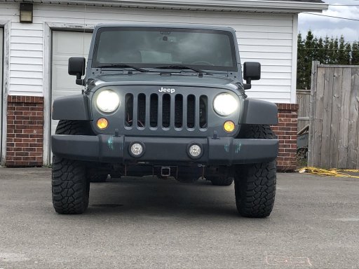

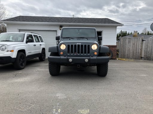

A little before and after of the LED install.
I have not tried them out to see what the actual improvement is as I am asleep before night fall. LOL.
No doubt it will be a "night and day difference" haha
Looks like they will be a vast improvement though for sure.
I think I'm running 8-9k lumins in my X and no need for any other lighting to be honest. Only thought would be some yellow led fogs for when the fog hits and snow.

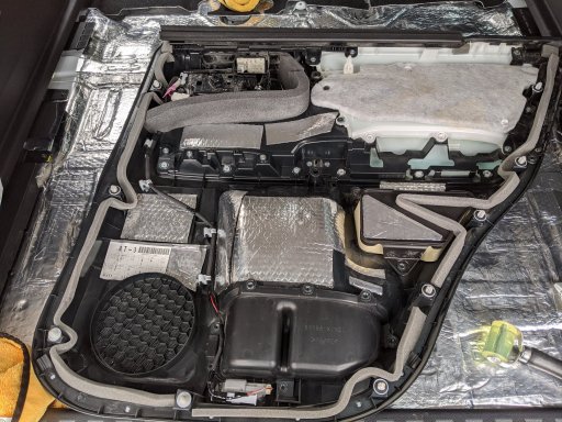

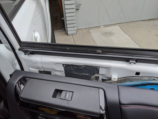

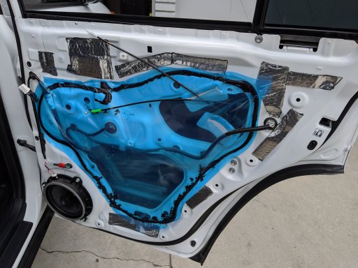

I spent the morning, you guessed it, adding more sound deadening. Since I had some left I decided to hit up the rear door cards and rear inner door parts. The outer portion of the doors were taken care of during the initial stereo install. Tomorrow I move on to the front doors. Removing the door cards is fairly simple. Getting them back on is an entirely different story. I learned that the trick is to remove the weatherstripping piece from the door card and install it first. Then the door card will just snap in to place. Trying to get that weatherstripping to seat properly is a b**** when it's still attached to the door card.
I am going to go with yellow rigid sae fog kit in the stock fog location, for fog lights. As for not needing more. We have more moose per sq km than any other place in Canada, yes you need more light, I think I'm going to run my tried and proven hella 500 driving beam with 55w 4300hid in them. I am going to swap the headlight housings to ece hella and led as well.

Sound like a solid setup!
Forgive me I was referring to my own rig and not needing more lights ; ) there is an elk herd along the stretch of hwy I commute to an from work. I've seen several accidents involving people hitting them and I could only imagine what a moose would do :frowning:
Yes, I got what you were saying. I have hit a moose. It was a calf and it did 18k worth of damage to my rig. Moose kill alot of people on the highways here since, 1. They don't slow down in the night, and 2. They don't use axuilary lighting. It should be mandatory here. I went for a quick scoot last night, I'm very impressed with the new bulbs. About 90 percent of what my truck lites did in my last jk. For 59 bucks. I'm happy. Adding the same lights to our patriot now.

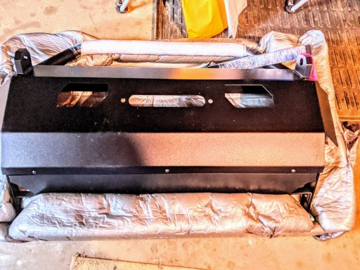

Not so much what I did today, but what I will be doing this weekend. I ordered it right around Black Friday and finally showed up yesterday.
I have a winch to go with it, but nothing cool about a cardboard box. lol
Enjoy that install!
