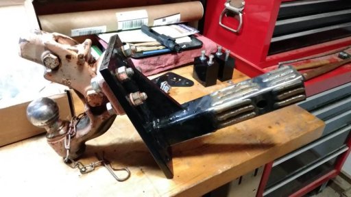

Ok a farmers trick, but one way or another, this pintle mount is no longer super sloppy in the Tahoe's hitch receiver. Added weld beads then fly cut on the mill 10 thousandth at a time until it just fit. Now a little wire wheel and paint, and ready to tow with tomorrow. I wish you could buy something that just fit!

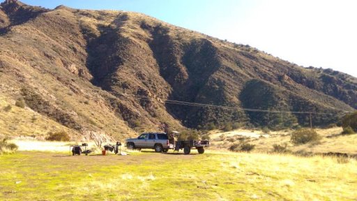

2nd amendment day out on BLM in south San Benito County CA. Couldn't get to Tumey Hills, the impossible when wet sign was spot on, road was snot on hardpan and the water crossing too deep for the Tahoe. Backtracked to Griswold Hills near New Idria mine and found a good spot. The heavy rains last night kept most people away, it was a good day.
