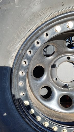

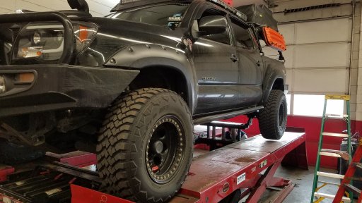

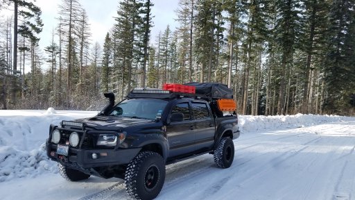

Were the nuts just loose or were they missing completely (like maybe vandalism) ? Because the wheel bead lock holes are not damaged it looks more like they were not tightened enough and just worked their way out. I think I'd be talking to the installer about that. That's why you bought those expensive wheels, to avoid bead lock loss !Merry Christmas to all....!!!. Well my adventures started on Monday on my way here. Had to stop off and check air pressure on tires in Madras Oregon because of vibration. Found that one of my beadlocks was eating through bolt heads and losing air . Swapped it out for spare to get back on the road and avoided something ugly. Got it fixed yesterday by Ben who helped build my truck so I could play in the snow today with my closest friend Tim. I drove him to the Mountains for a white Christmas. View attachment 132289View attachment 132290View attachment 132291View attachment 132292
No vandalism. Just a huge tire pressure change due to weather conditions. Should have checked the tire pressures before getting on the road. The actual bolts are and were still in the back ring. The heads were just missing from the shifting of outermost ring when it started losing tire pressure at a more rapid pace. Just glad I trusted my gut and stopped to check them. Ben did fix it and replaced the whole wheel with new bolts at no cost to myself.Were the nuts just loose or were they missing completely (like maybe vandalism) ? Because the wheel bead lock holes are not damaged it looks more like they were not tightened enough and just worked their way out. I think I'd be talking to the installer about that. That's why you bought those expensive wheels, to avoid bead lock loss !
16986
With bead locks how low can the pressure get before there is failure ? What is your side wall ply rating. Does sidewall ply rating make a difference in how low you can go ? My tire dealer said I could go as low as 15# safely W/O bead locks bit I don't think he was talking about a road with big rocks. Do you know if the width of a tire has anything to do with how low the pressure can be ?No vandalism. Just a huge tire pressure change due to weather conditions. Should have checked the tire pressures before getting on the road. The actual bolts are and were still in the back ring. The heads were just missing from the shifting of outermost ring when it started losing tire pressure at a more rapid pace. Just glad I trusted my gut and stopped to check them. Ben did fix it and replaced the whole wheel with new bolts at no cost to myself.

Real beadlocks can be run all the way to 0 psi without the tire coming off the wheel, but to keep from damaging the wheel a minimum of 5 psi is recommended.With bead locks how low can the pressure get before there is failure ? What is your side wall ply rating. Does sidewall ply rating make a difference in how low you can go ? My tire dealer said I could go as low as 15# safely W/O bead locks bit I don't think he was talking about a road with big rocks. Do you know if the width of a tire has anything to do with how low the pressure can be ?
The real issue was speed and the fact that I'm on pavement. Doing 70 mph on the freeway with less than 20 psi in the tire didn't create ideal conditions. The lock was starting to shift and expanded beyond its optimal operating standards. Failure was imminent.With bead locks how low can the pressure get before there is failure ? What is your side wall ply rating. Does sidewall ply rating make a difference in how low you can go ? My tire dealer said I could go as low as 15# safely W/O bead locks bit I don't think he was talking about a road with big rocks. Do you know if the width of a tire has anything to do with how low the pressure can be ?
16986
If thats the case what do you think the reason is for @Chadlyb having the bolt heads come off his wheels. That's a failure I have only seen on severly bent wheels based on my past racing experiences.Real beadlocks can be run all the way to 0 psi without the tire coming off the wheel, but to keep from damaging the wheel a minimum of 5 psi is recommended.

Like @Chadlyb said in his fallow up post, excessive speed on the pavement cimbined with lack of preventive maintenance (not checking tire pressure and wheel bolt torque) before going on his trip. Beadlocks aren’t made to air down at road speed on the highway.If thats the case what do you think the reason is for @Chadlyb having the bolt heads come off his wheels. That's a failure I have only seen on severly bent wheels based on my past racing experiences.
