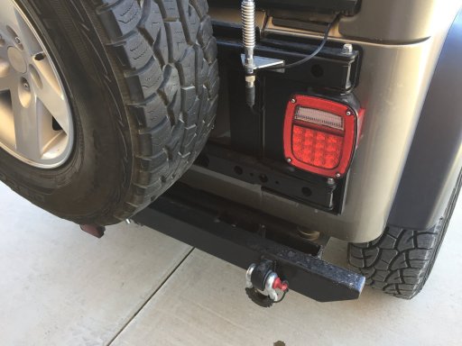

Several items:
Rock Hard 4x4 bumper w/o swing-out tire carrier (now I can fully open the tailgate after installing the Morryde hinge & tailgate reinforcement, very solid feel) and the Morryde antenna mount (for the CB):

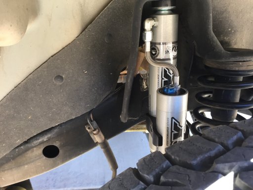

Fox shocks at all 4 corners:

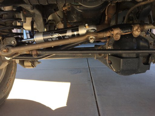

Fox steering stabilizer (that was fun, thought I was going to have buy a new drag link until the post finally cried uncle and stopped fighting!):

How do you feel about the shocks? Worth it?

In my opinion, yes. I think the base model would drive/feel the same but went with the reservoir in order to keep up with my brother in his JKUR (he has the same installed on his) on the washboard dirtballs (weeped the front driver Teraflex shock during the trip to Canyonlands in October) might be overkill for my needs but what the hay. After driving her all week, much better road manners compared to the previous shocks (Teraflex 9550). The steering stabilizer made a huge improvement in highway speed bumps.

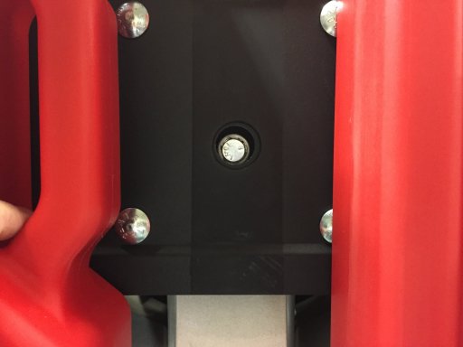

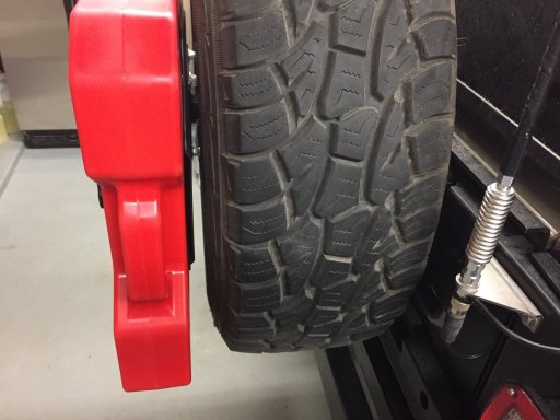

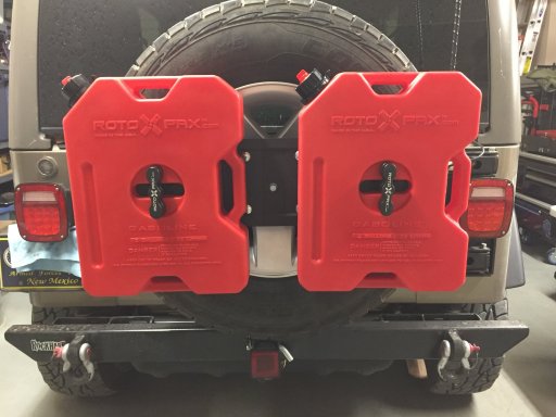

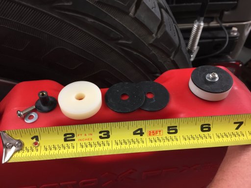

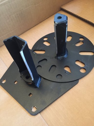

Modified an EVO Manufacturing License Plate Relocate/Rotopax Can Mount (EVO-1163B) designed for the JK to fit my TJ Rubicon spare tire/rim. Flapwheeled & painted the edges to fit inside the smaller diameter TJ Rubi center hub. Also drilled a hole (1” hole saw bit) in the Rotopax mounting plate to make accessing the bolt easier. The stock Rubi rim doesn’t push the tire out enough to contact the Rotopax mounting plate so I assembled some hardware from the local Ace to make a contact point with the tire.
Pic when completed later tonight...

Slick set up, I wonder if I can do something similar to my LRD2. How much gas do your tanks hold.

Those are the 2 gallon G2 tanks. I’d like to carry at least 6 gallons from past week-long off-roading/camping experience. After testing the tailgate setup with full tanks, I might get a couple of smaller tanks to double mount. This is the response to removing the ~90 lbs of swing-out tire carrier with 2 jerry can holders.
