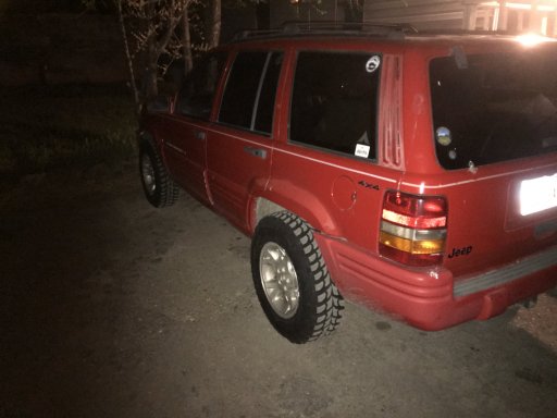

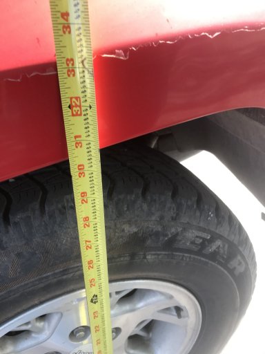

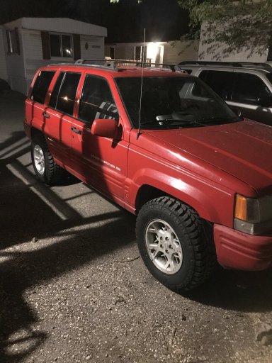

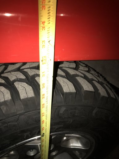

Thanks it really took me two weeks to find these tires I was hoping to get a little bit of a lift because of them but wasn’t expecting 2 inches had to trim the front bumper a bit about an inch but that is something I had planned to in the future to accommodate a 33 inch tire after I do a 3.5 inch lift. I am doing some recovery HOOKS tomorrow. Yes shackles look cool but I don’t want stuff swinging around banging into stuff denting scratching scuffing things up so stationary hooks it going to be. I am not going to buy the bracket kit I think I am going to bolt the hooks to a piece 3/8 inch hardened steel and bolt that in place to the I guess it’s the sub frame right behind the bumper and have the hook extend through the bumper and bumper cover. It is a little more work but I think it will be a little stronger as well. I wasn’t going to put a roof cargo rack on but until I finish building my trailer I am going to need the space. So if I finish that by Saturday. On Sunday I will start doing the electrical stuff let’s see old school KC lights, fog lamps mounted in the factory position ( I found the factory wiring today while the tires were off) so with any luck that switch still works. I will also be installing a second battery, a 2000 watt inverter, a 15 liter drawer fridge mounted to the top of the drawer system, a ham radio, a cb radio, 4 USB ports, a 150 psi harbor freight compressor(I want to install a two gallon air tank someplace on the undercarriage) all the new accessories are going to be old school fuse and relay systems s-pods are cool but I don’t know how to fix them but I can rewire something replace a fuse or relay fairly easy. I know I am forgetting a lot and over simplifying everything but it’s late and I should be sleeping

Rick, an easy and economical lift can be had for around $200 if you can do the work yourself. I have coil springs on all four corners too. I used the 2" spring lift spacers and they work just fine. They are easy to install and you could do it yourself. It takes about 2.5 - 3 hours to install if you know what your doing.
I didn't have to buy new shocks, longer brake lines or alter the length of my front or rear drive shafts. Because I couldn't do the work myself I had to pay my mechanic $240 to install them.
A comparable 2" lift using taller springs would have cost close to $560 plus $240 installation. With an increase in tire size (like you) I gained 1" and 2" with the spacers I have plenty on ground clearance (almost 16") for the places I will visit.
With only a 100" wheel base I think it's perfect and it handles great. Actually I have more ground clearance than my Dodge D250 with 31" tires and heavy duty suspension. More is not always better and comes with a lot mote cost. Your good with 2" more I believe.
