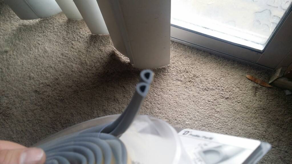

Items needed are as follows:
Plano Box
EPDM rubber weather seal D profiled 5/16 wide 1/4 thick (see pic)
Super glue
Scissors
Ball point pen
Alcohol wipes (not pictured)
Weather seal and profile:

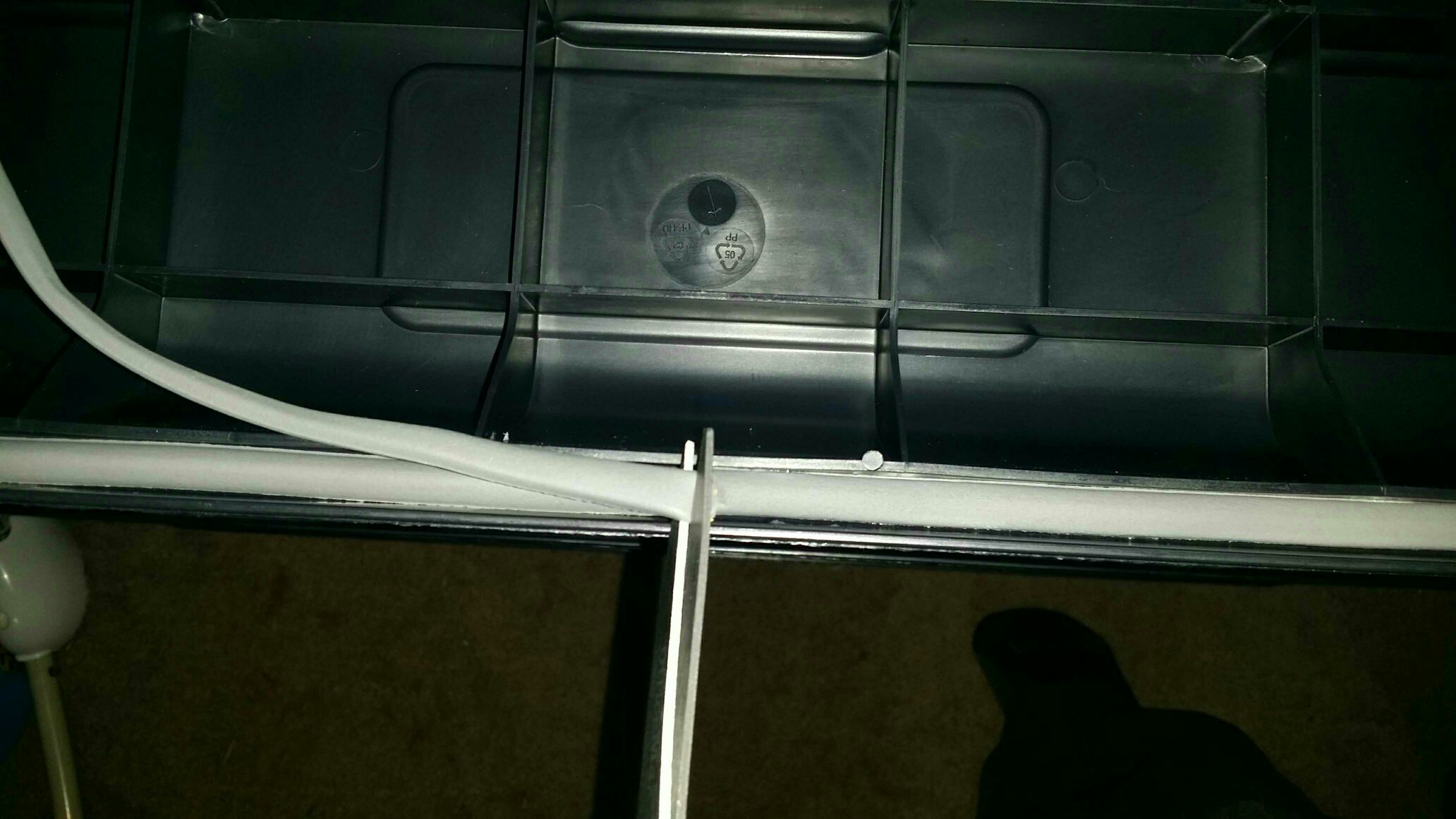

Step 1:
Start by flipping the lid over and cleaning the surface of the lip using alcohol wipes.
Step 2:
Place super glue in the straight channel of lid and allow a minute for the glue to start getting tacky. Note do not apply to the corners as the glue actually prevents the gasket from sealing against the plastic.
Step 3:
In my case I needed to seperate the two gaskets. They are both 5/16 wide and they simply pull apart. Apply gasket to channel using ball point pen to press the gasket into place. Note this can be done using you're finger if your don't have sausages for fingers.
Step 4:
Trim gasket as close to the starting point as possible.
Step 5:
Leave lid upside-down for 1 hour minimum to allow glue to set.
Step 6:
Reinstall lid and enjoy.
