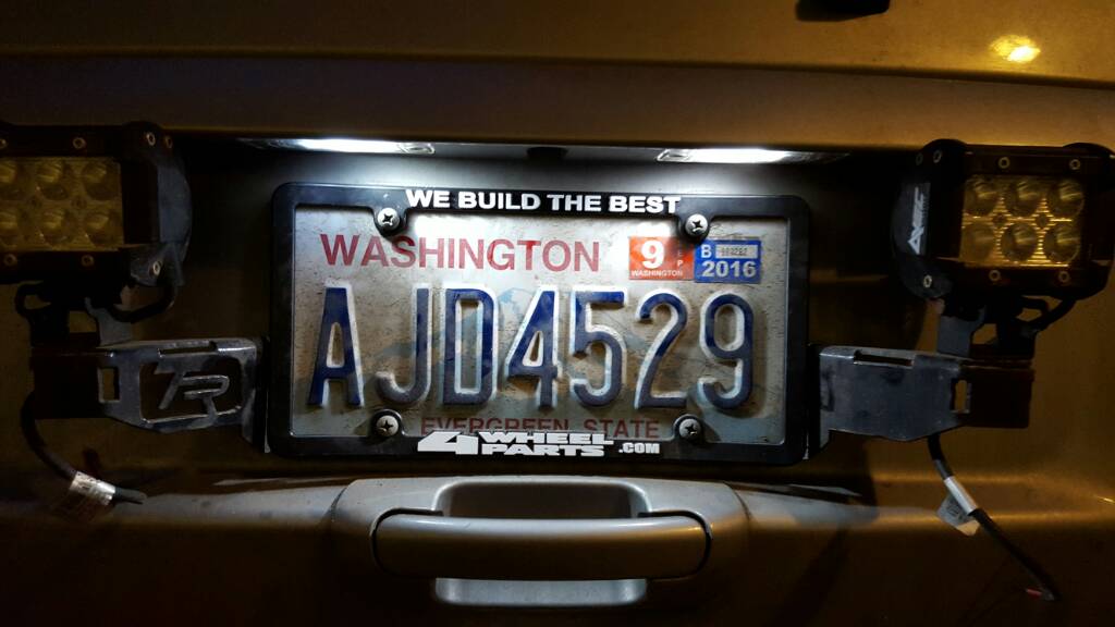

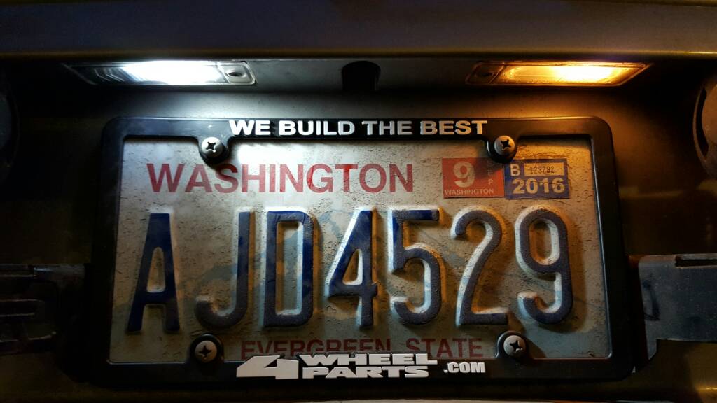

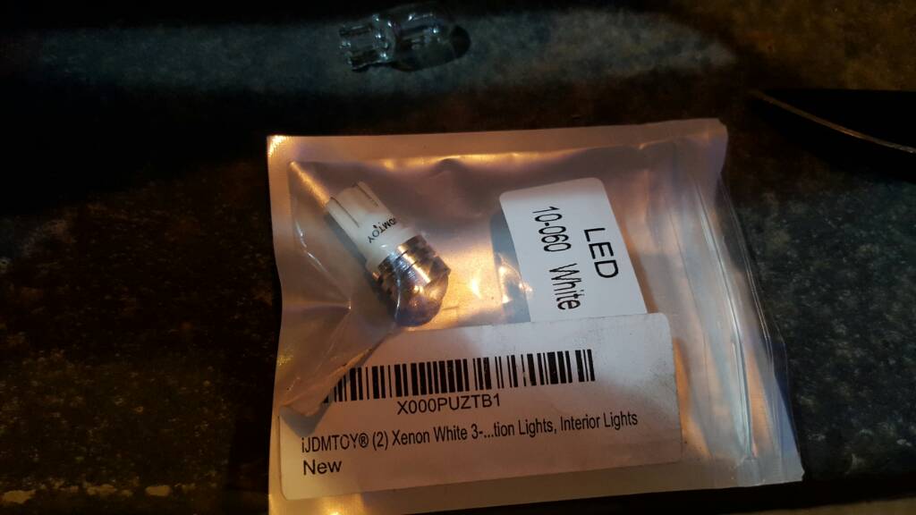

Wife got me some led license plate bulbs for valentine's day

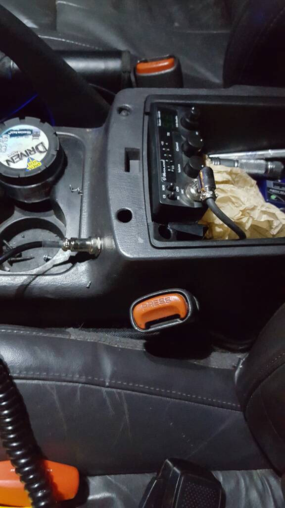

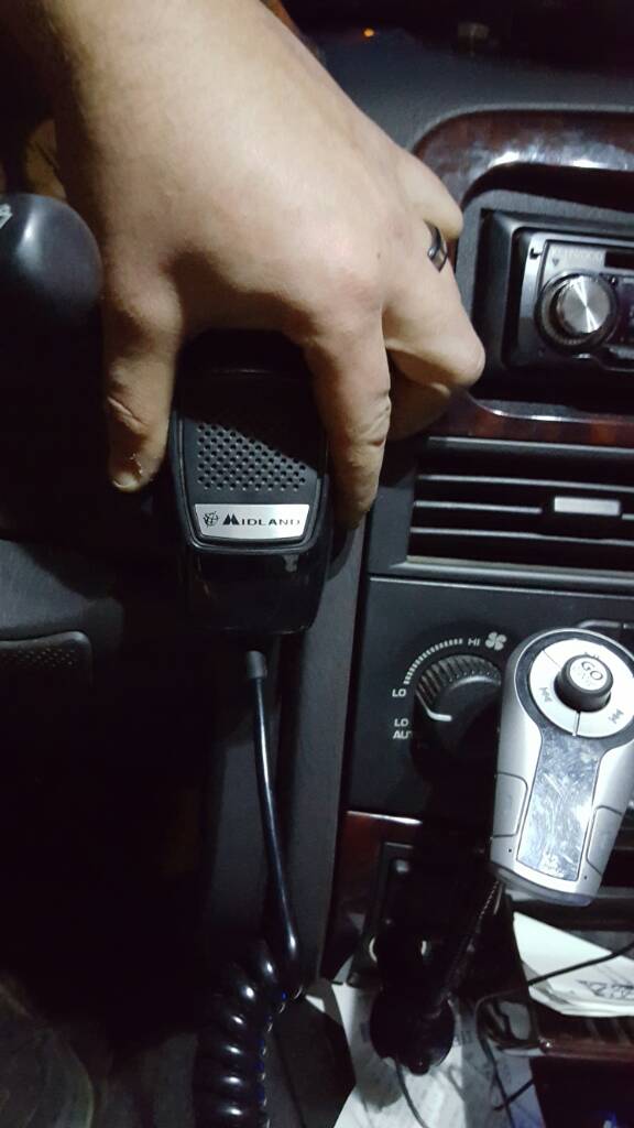

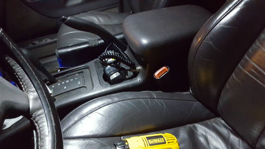

Also saw someone with a wk do this neat little mod so figured I'd give it a shot. Need to find a mic bracket and then should be good to go.
Where I will want it
And lazy temp lol

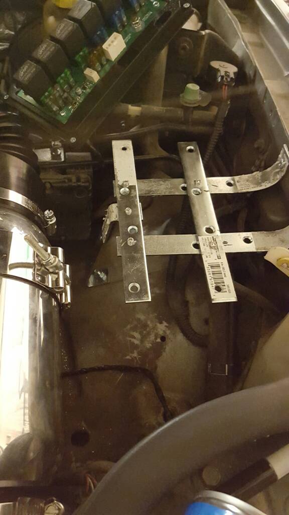

Added a brace to the spod mount to help sturdy it up. Super strong now lol
4 down 2 to go and to drill a giant hole in my firewall....

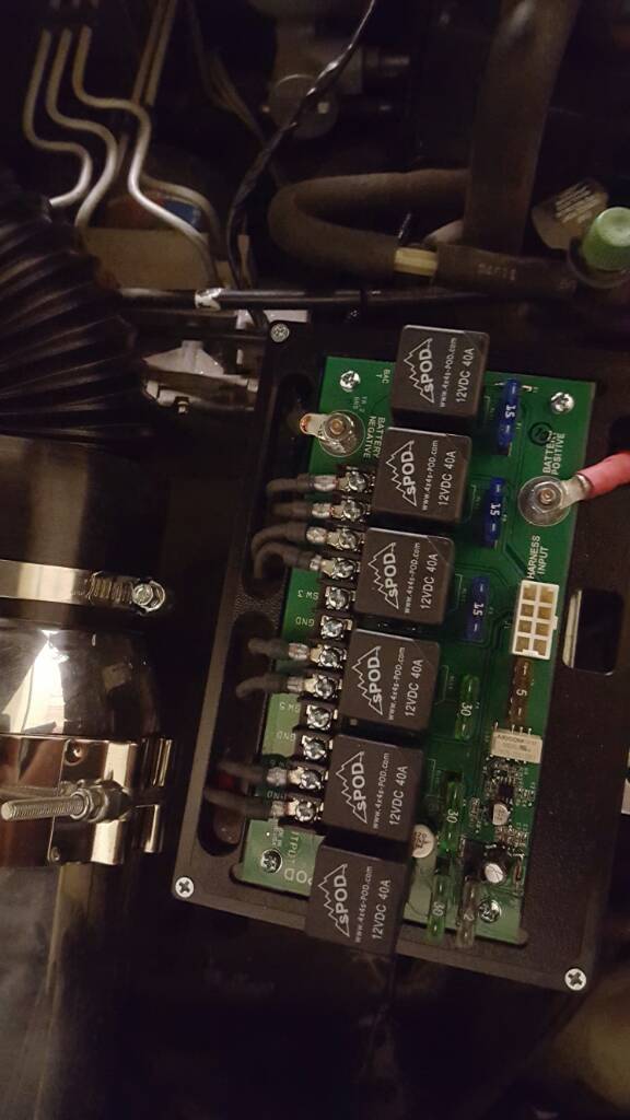

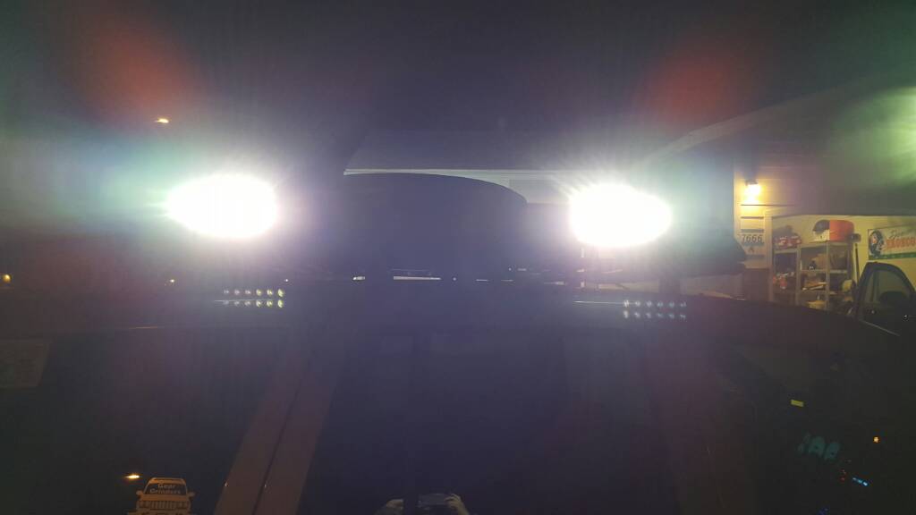

Well after some hick ups and amazing help from spod, I have all my lights finally wired in (except roof rack and rock lights)
Just bumper and pillar cubes
All cubes and hi beams

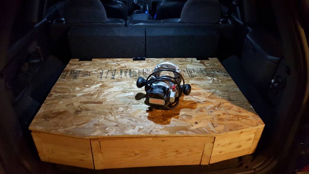

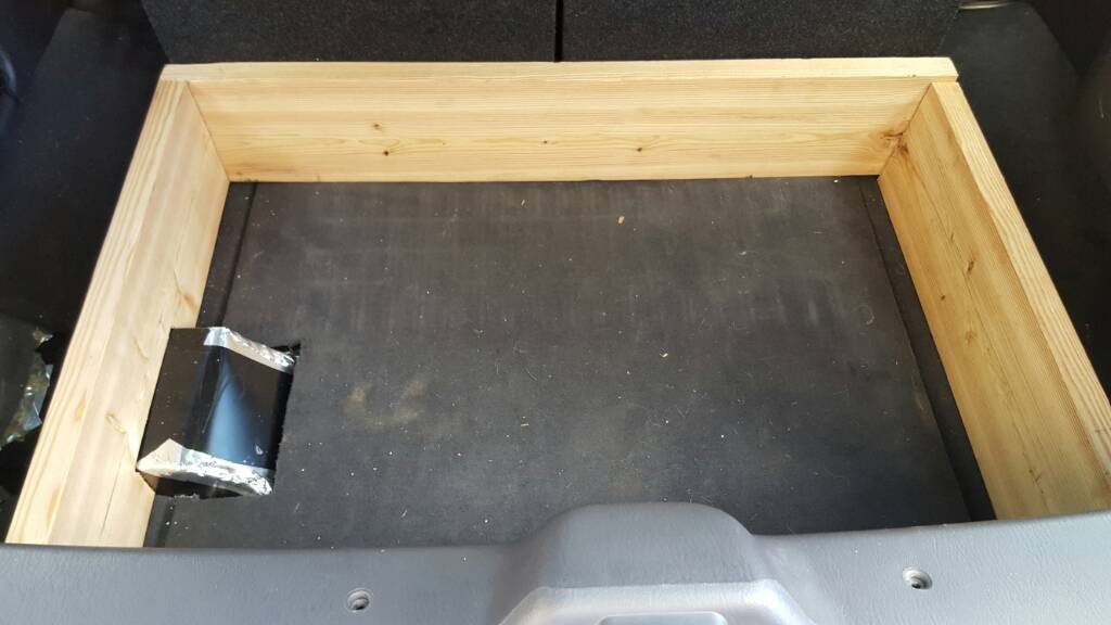

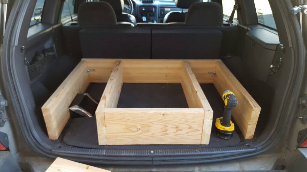

Also got my cargo area completed. Still have to make a latching system wrap the outside in carpet and paint the inside.
Sent from my SAMSUNG-SM-G890A using Tapatalk

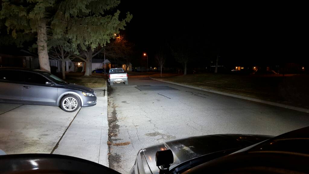

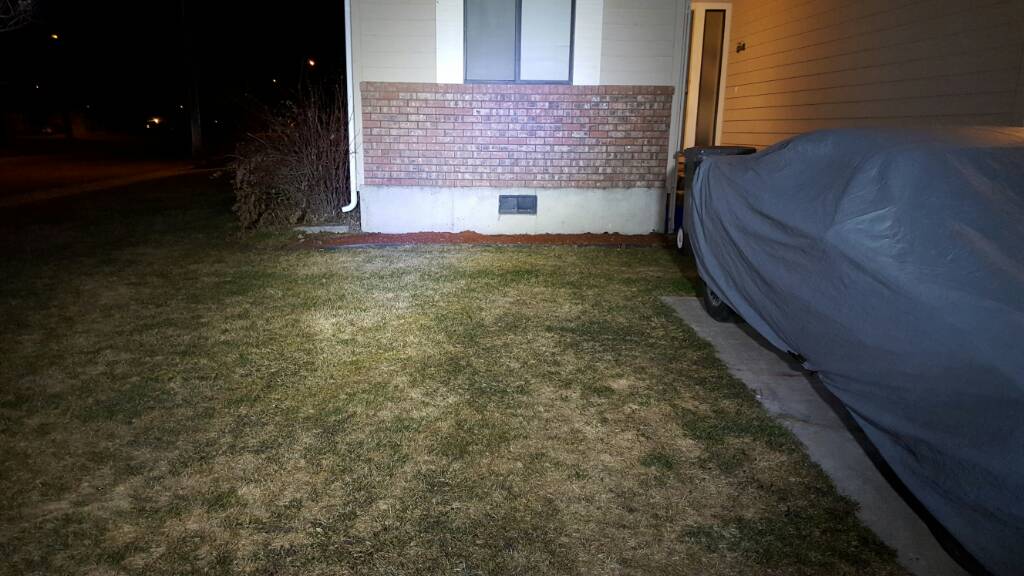

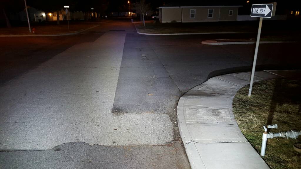

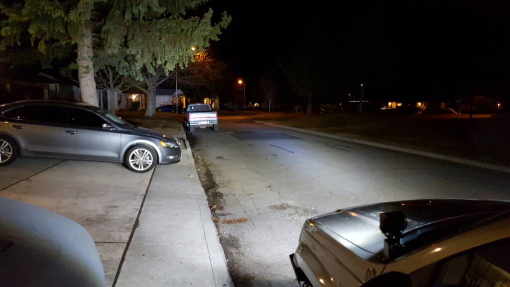

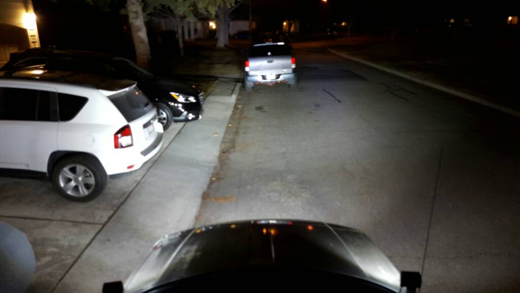

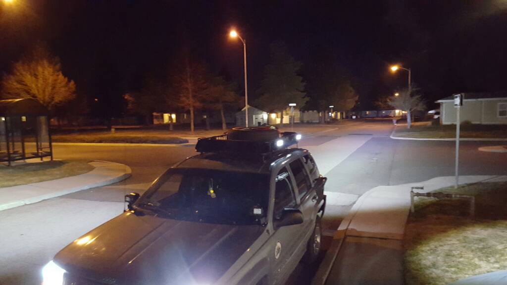

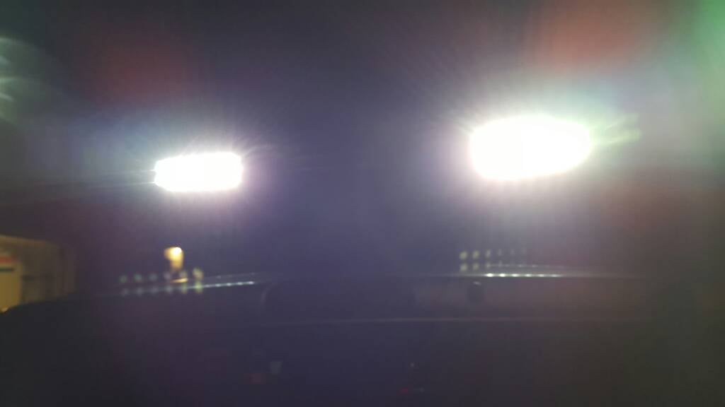

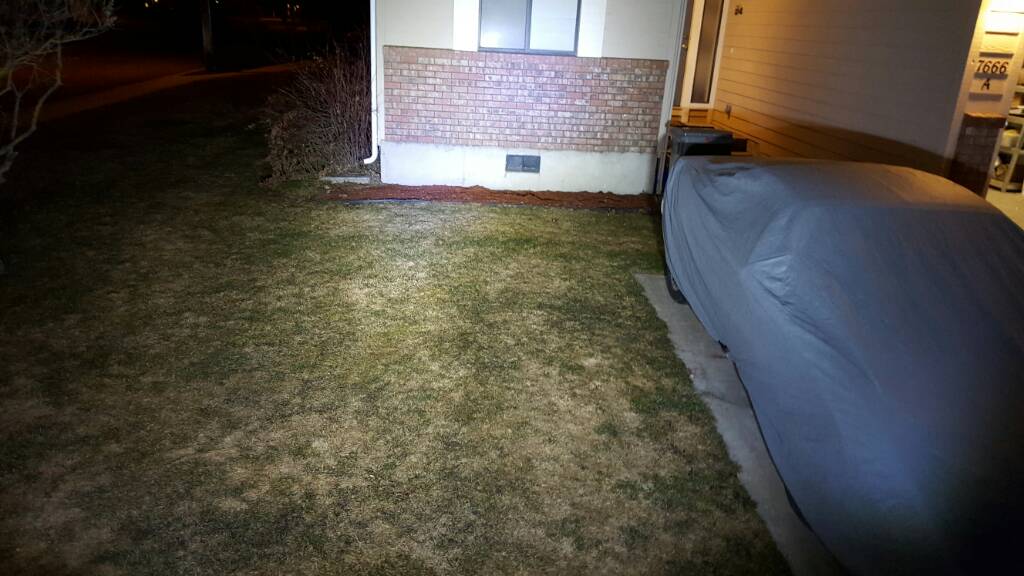

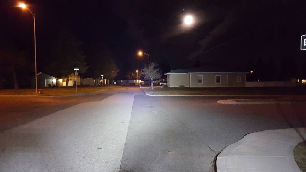

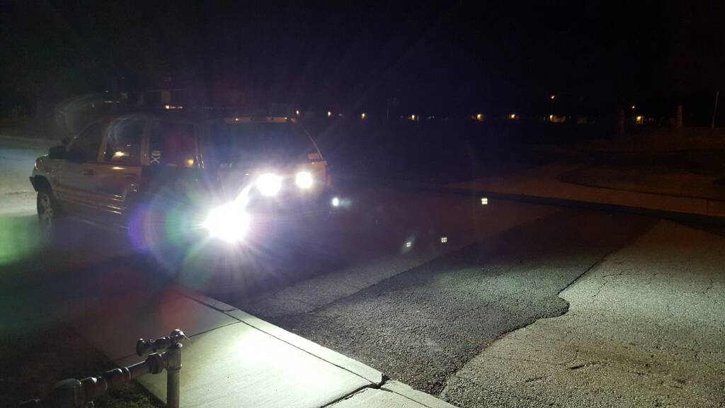

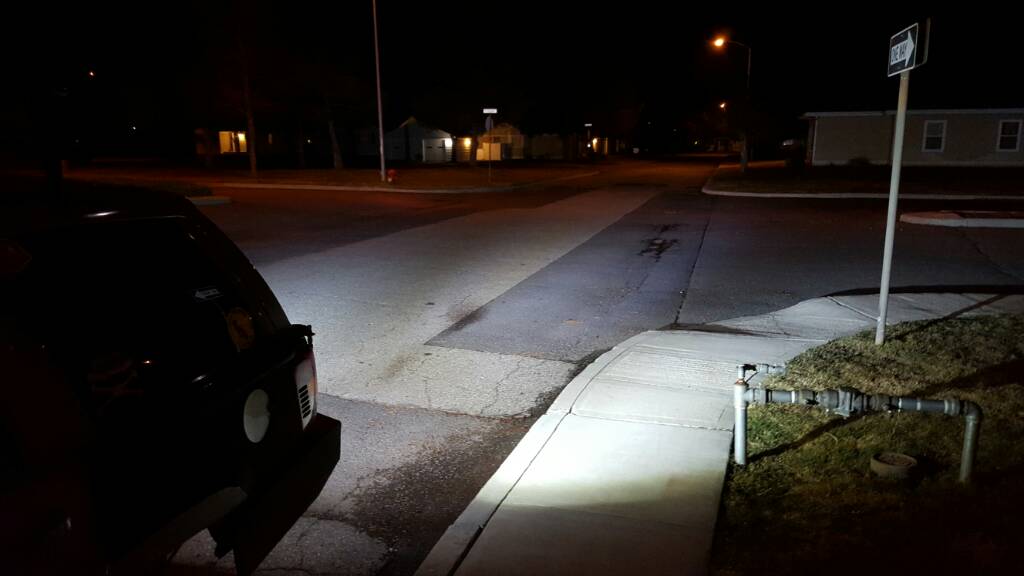

Well got my roof rack lights all mounted and wire in. Love this setup!
All on (only roof rack)
Driver side
Bright!
Rear
Passenger
Sitting on the roof with all 6 lights on (Roof rack, license plate aka assholes lights, and then lower bumper)
Passenger side from the roof
All 6 on the front from the roof (fender, bumper, and headlights low beam)
Driver side from roof

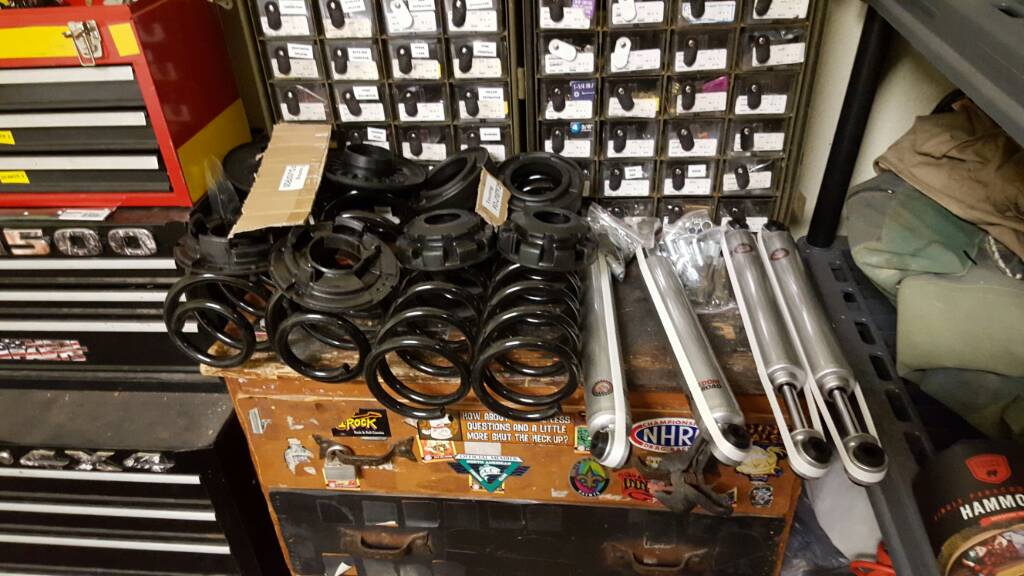

Also my freedom offroad 2.5/2 inch lift came in as well as new isolators all around.
Hoping my jeep rides way smoother now compared to the junk rough country shit on it now.

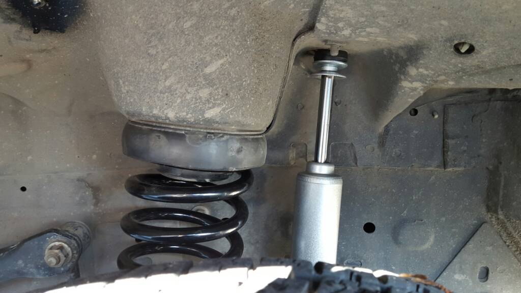

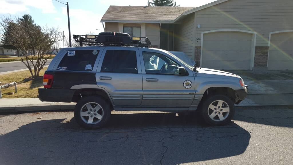

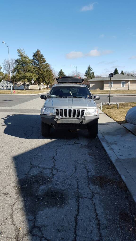

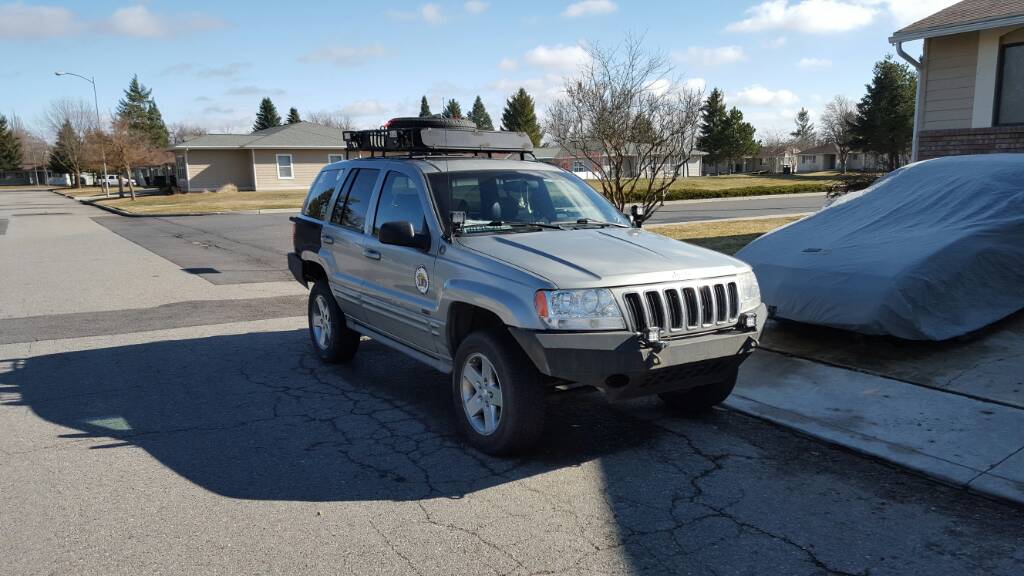

Well got my freedom offroad 2.5/2" lift installed.
Measurements are weird as hell in the front (they vary by about .5" lol)
All in all gained about 1.5" all around tho. Keep in mind I had a 2" puck lift before so it was sagged out about an inch.
Anyways pics
The shafts on these shocks are rather big compared to the garbage rough country ones.

Check to see if the left front lower spring isolator is still seated on the coil step plate and see if out may have crushed or otherwise deformed. I had that problem when I first put my 3 in IRO lift on.

Before
Driver front: 19 1/8
Passenger front: 19 5/8
Driver rear: 19.5
Passenger rear: 19 1/8
After
Driver front: 20 1/4
Passenger front: 20 7/8
Driver rear: 20 3/4
Passenger rear: 20 7/8

Filled the tired with air they were all off alot lop
New measurements are this
Driver front 20 1/8
Passenger front 20 1/4
Driver rear 20 5/8
Passenger rear 20 5/8
So only 1/8 difference now
Checked the isolator and the coils all seems to be in correctly.

Good to go then! :sunglasses:
