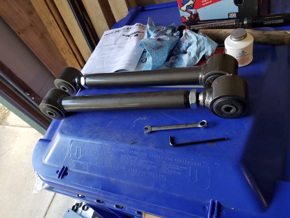

I will be interested to hear how you like the Core 4x4 control arms. I am considering those as an upgrade.

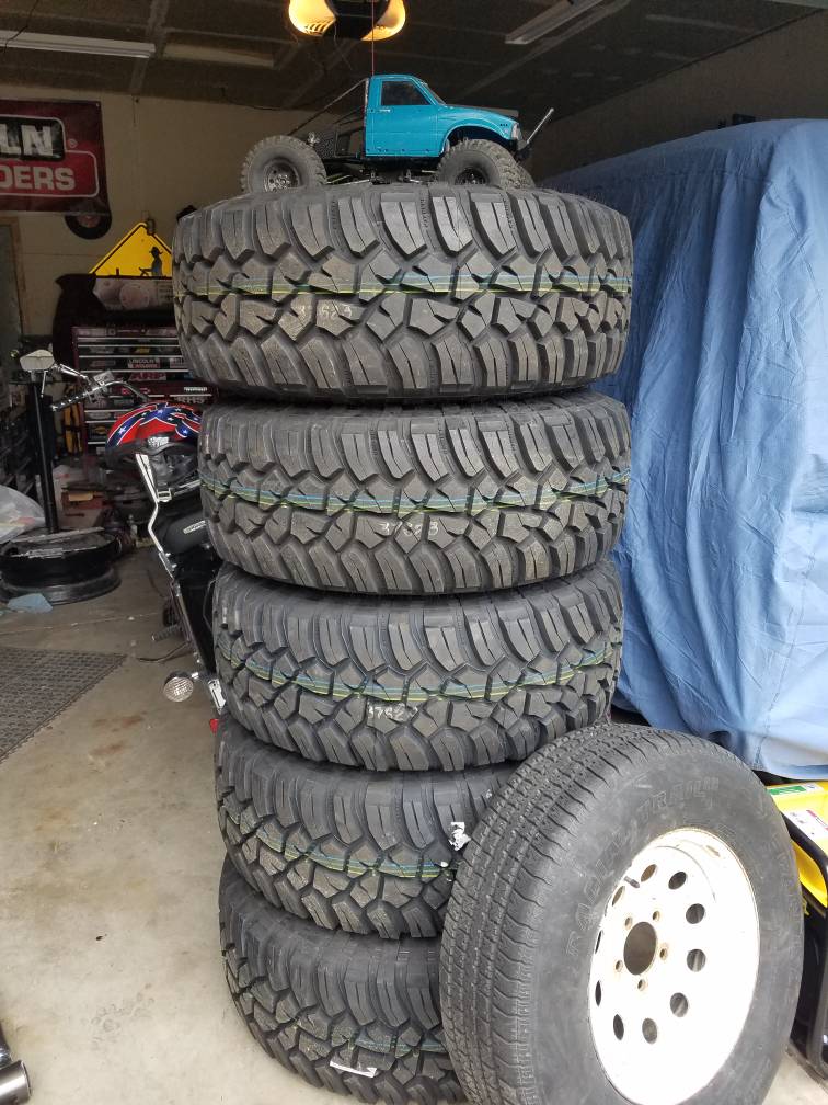

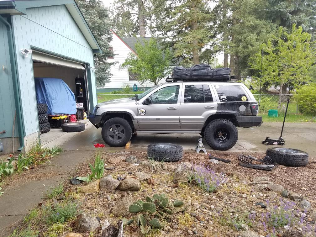

Tires mounted and Bead weights installed. Lift will be going on tomorrow!!! Can't wait

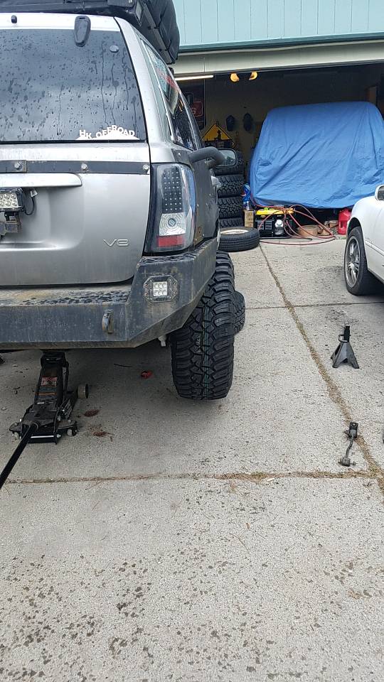

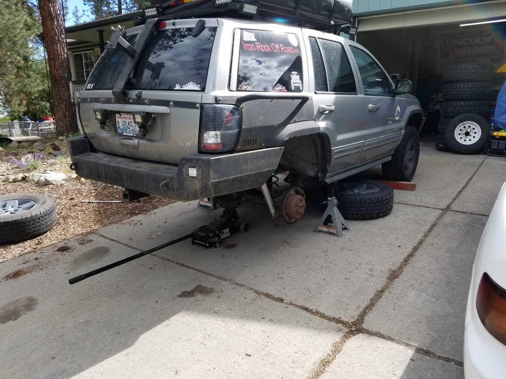

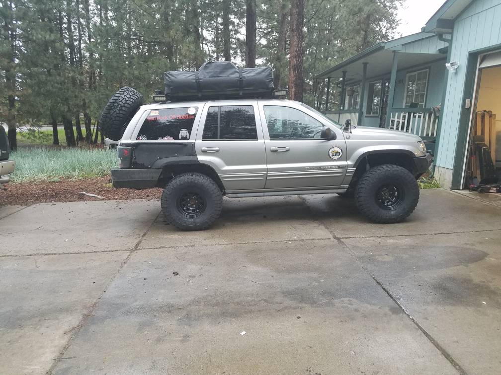

looks like you may need a 2" coil spacer in the rear or a more HD coil... we were having the cali truck issue with our WJ and the RC springs I used 2 inch coil spacers for now.. plan to get some clayton 4.5 lift springs next year maybe.. they have a way better spring rate I think RC's are 180 and the claytons were 225... yeah..
looks Great!
timberwolf_120
3,059
Ridgecrest, CA
0115

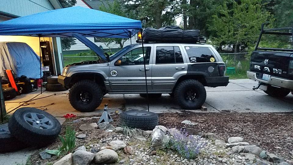

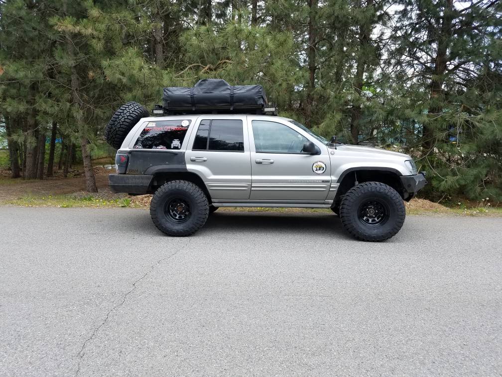

I got iro 4" coils.
The driveway is at a gnarly angle and there's a lot of shit in the back of the jeep right now. Including the old lift lol
Here's a better pic on flat ground
And a pic of the back of the jeep

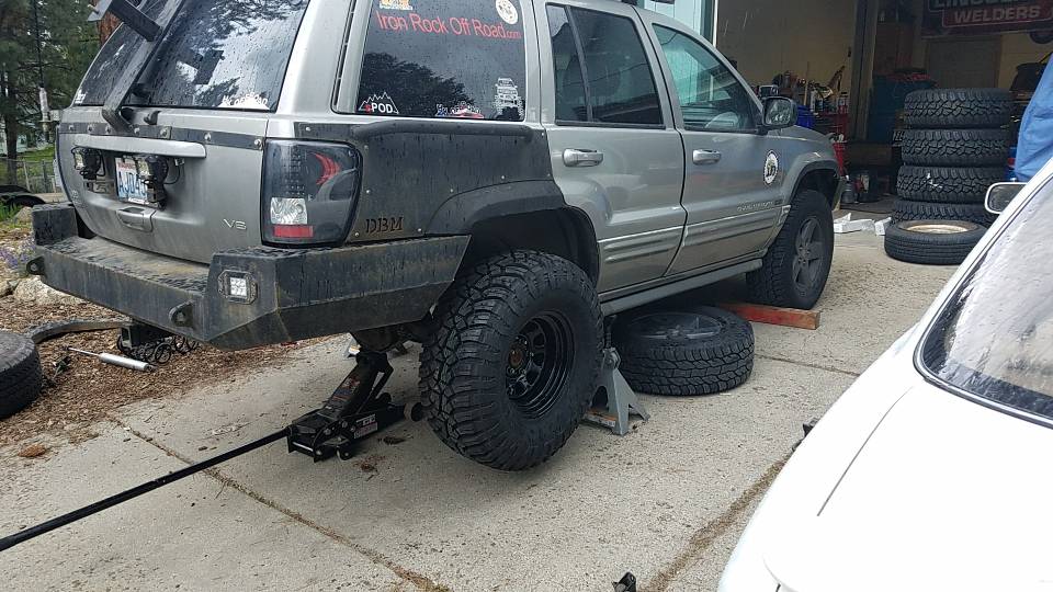

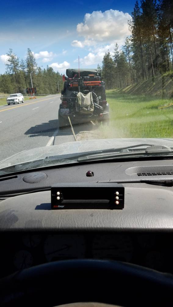

:/ blown power steering pump, exploded pulley, shredded serpentine belt, blown hydro line and a busted tensioner pulley ended the memorial day trip rather soon.

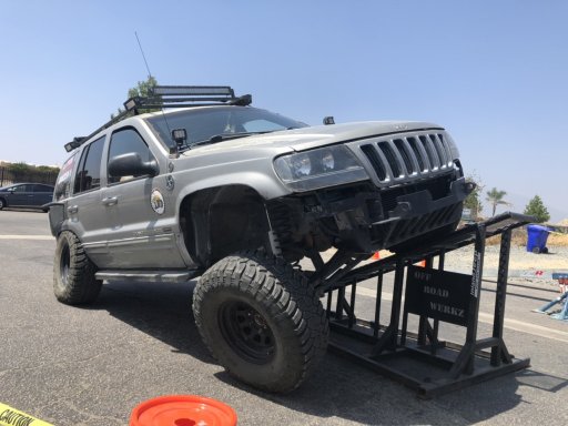

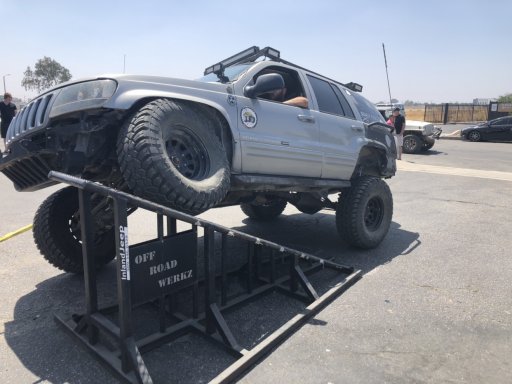

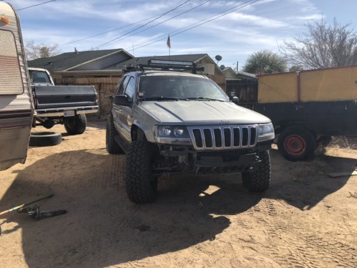

Just a few updated pics of the war machine
Since last post I’ve removed the front and rear bumpers. I added hkoffroads gatekeeper and hidden winch Mount, added their kick ass glissade rock sliders.
And here’s a couple flex pics too to show off how well short arms can really work on a wj.
