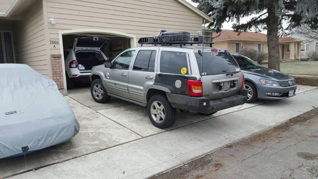

I really like the way that rack is done. Eventually I'd like to rip the Garvin off my roof and do something with a little more capacity, something that matches the lines a little better, and is a little more sturdy.

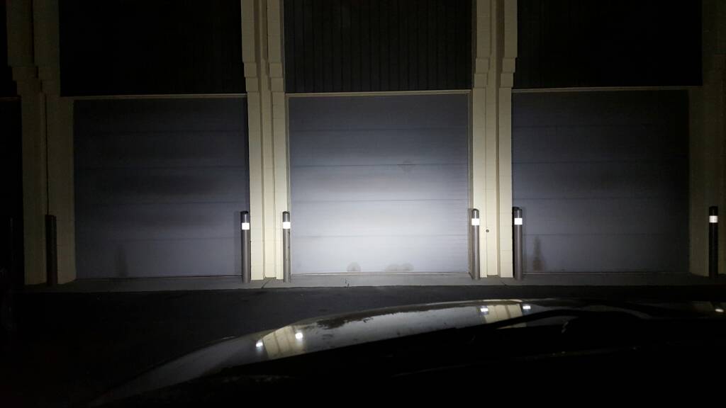

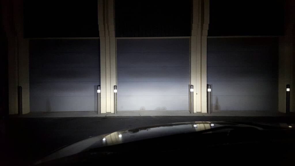

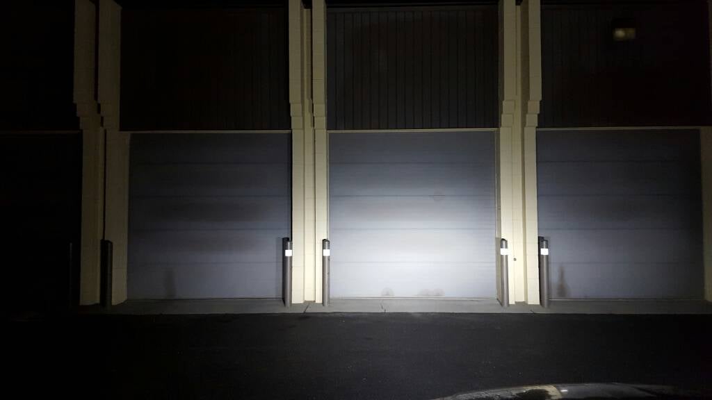

Got some pics of the output on my led headlights
Off (outside view)
Low beam
High beam
In cab view
Parking lights
Low beam
High beam

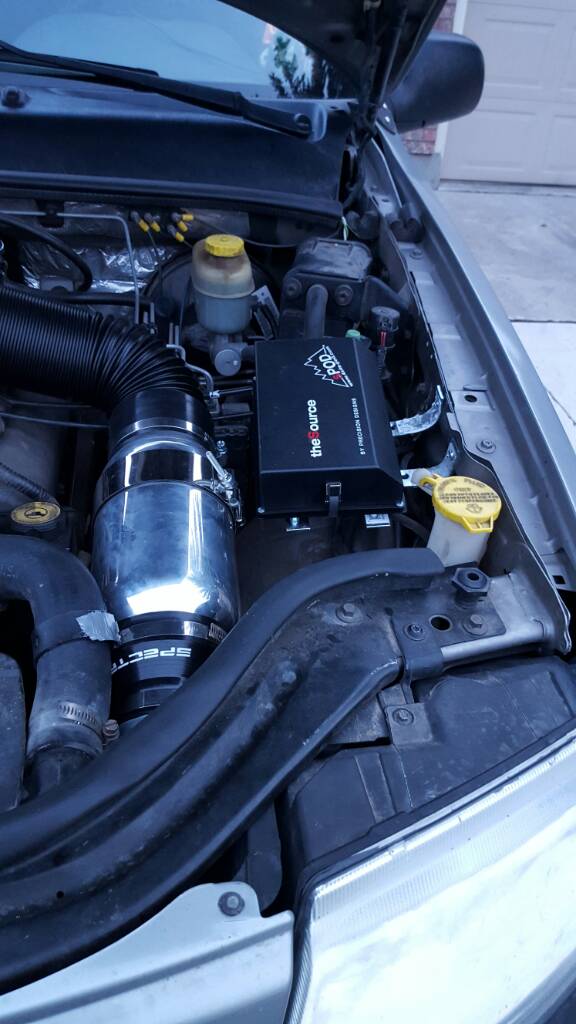

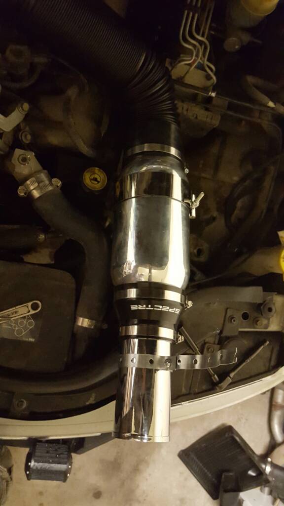

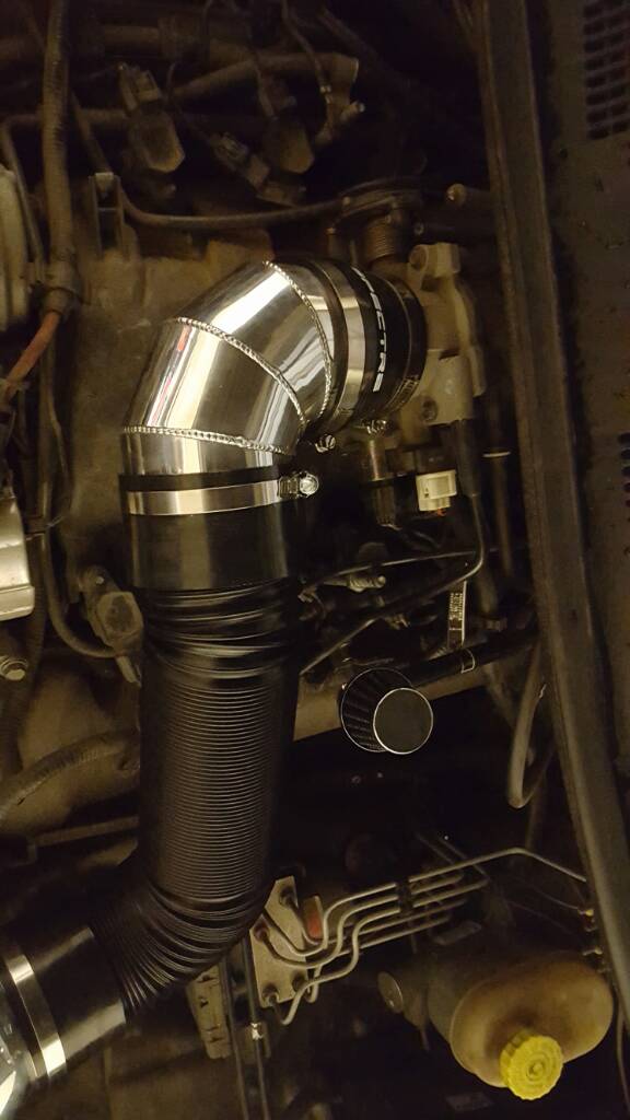

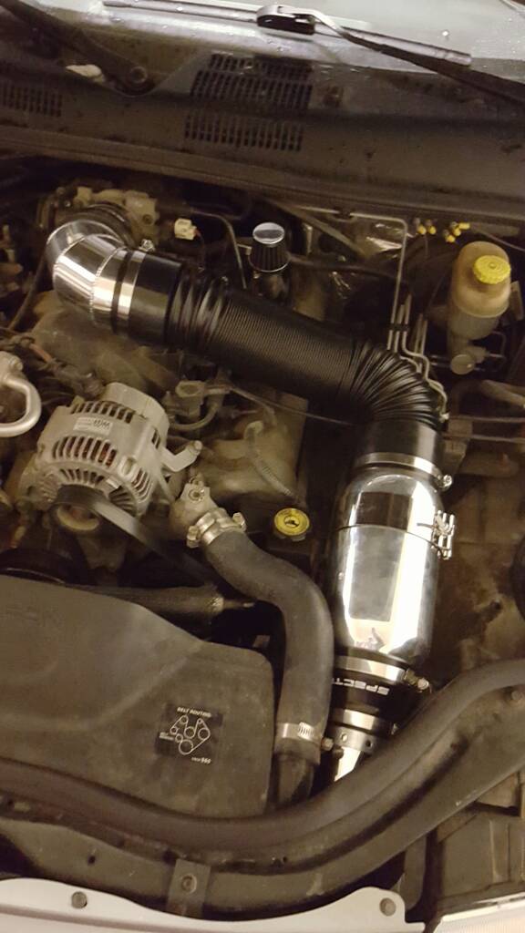

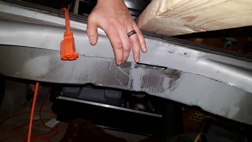

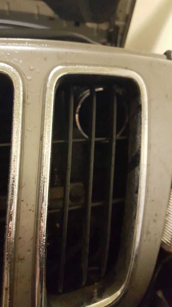

Finally got the intake system setup and mounted in.
This damn weather is making it a nightmare to do any work.

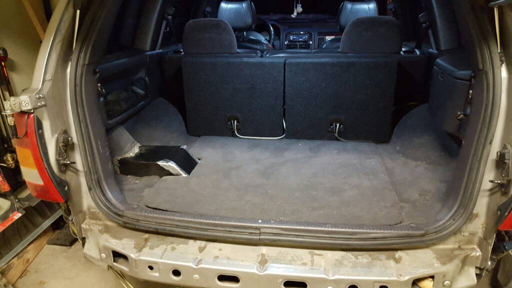

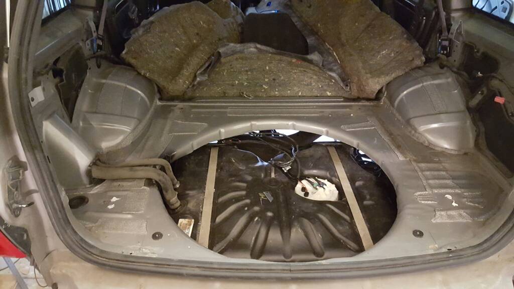

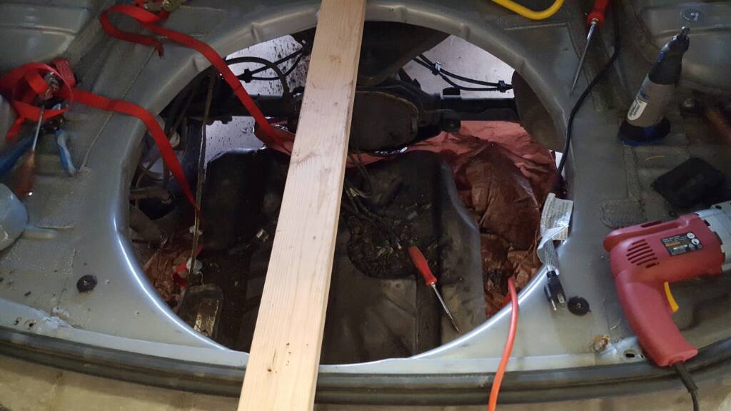

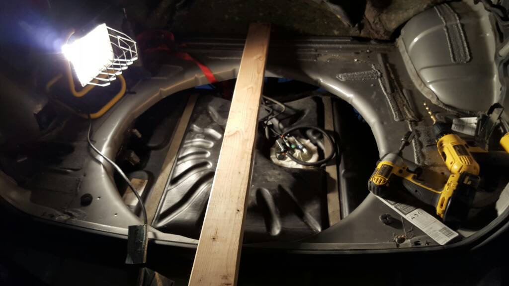

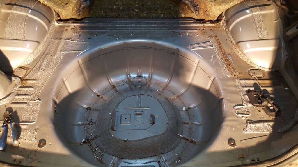

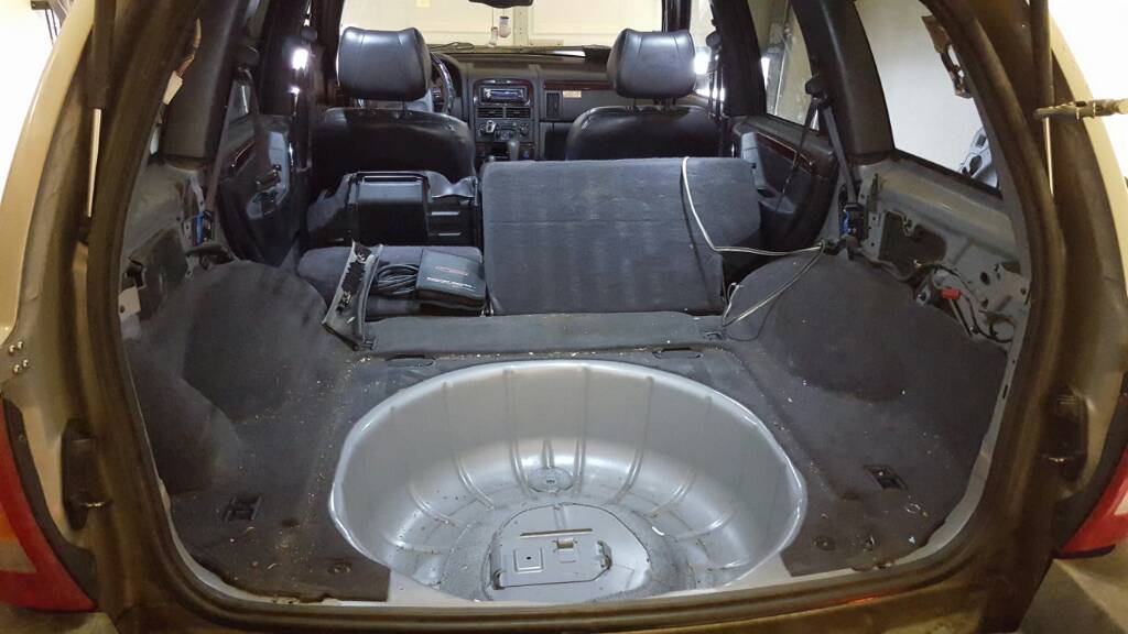

Well fuel pump is going out in the jeep so decided to just make things easy and tackle my tank tuck at the same time.
Sent from my SAMSUNG-SM-G890A using Tapatalk
Reactions: WJ - Firefly
Overland-Indiana
3,316
Kokomo
0750
Your a brave man!! The tank tuck, from what I have heard is well worth it though!! Gotta be honest, I love my XJ but i REALLY miss my WJ.. :disrelieved:
Reactions: timberwolf_120
timberwolf_120
3,059
Ridgecrest, CA
0115
Whys that? Lol
And yea I know it's gonna net me a ton of rear ground clearance. And I didn't plan on using the spare tire well for anything just gonna build something like this over it so a tank tuck was even an easier decision lol

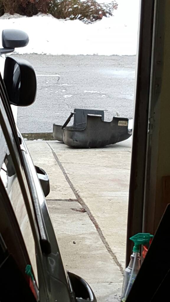

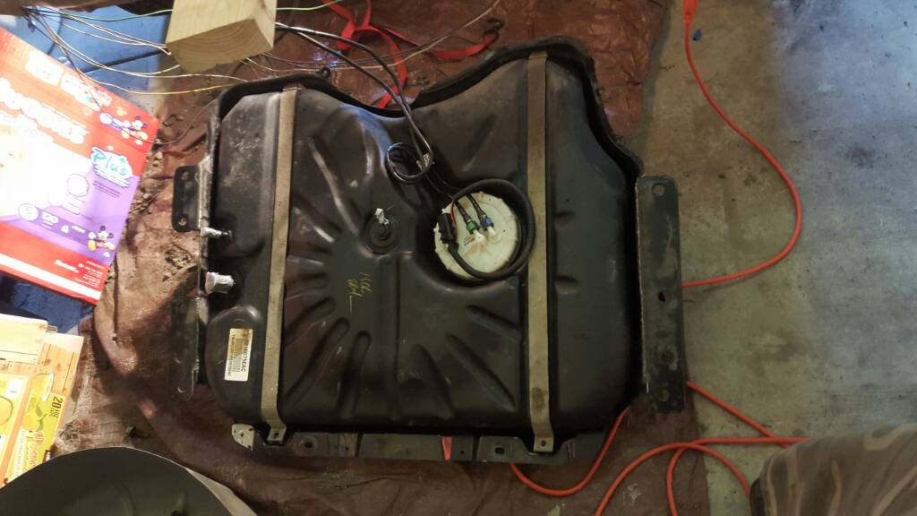

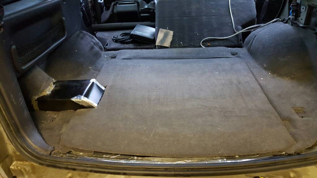

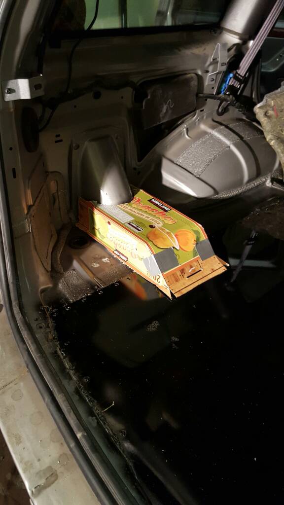

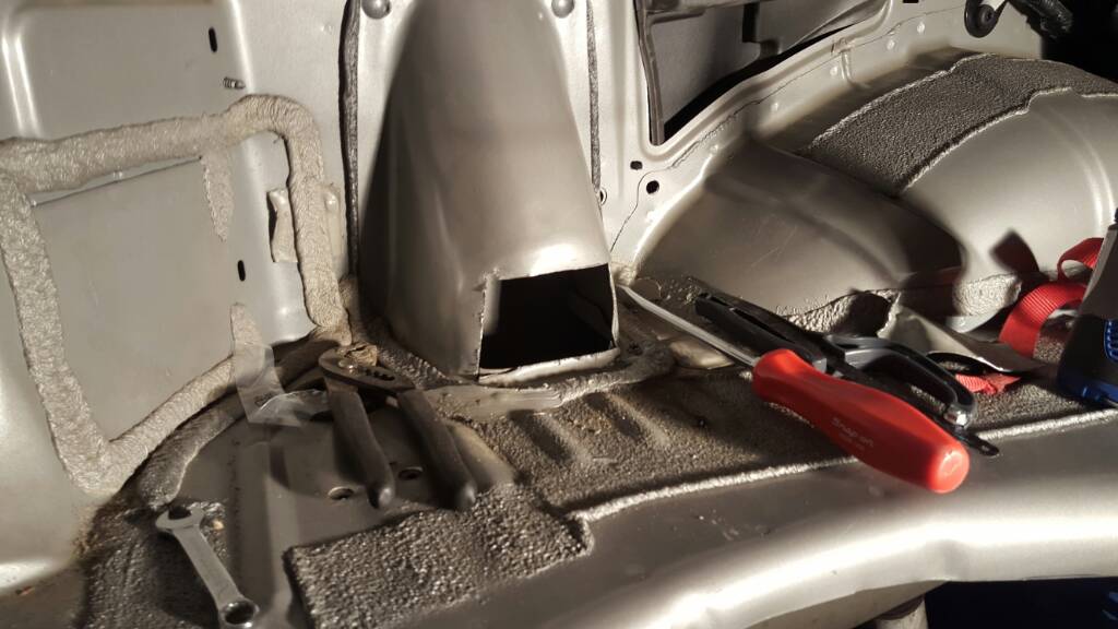

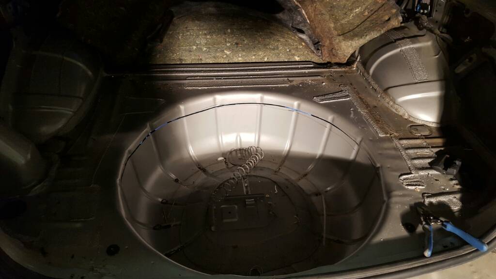

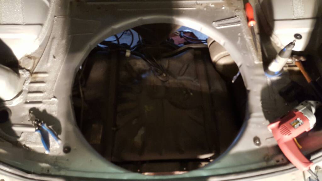

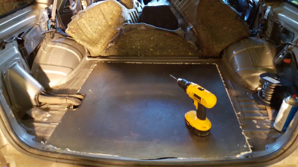

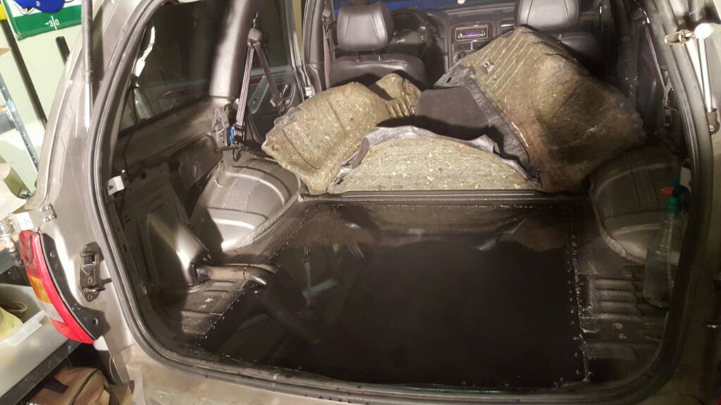

Tank tuck almost done. Here's what I have so far tho.
Already tested the filler neck and it fills just fine. If ya don't like it drill through the unibody rails. I didn't have a hole saw big enough for it nor anymore money to get one.
Have to cut the box template out of the steel I got and then seal that up, cut the carpet and it'll be good to go.
Cut 5.5" out of the skid itself and then 4 5/8" out of the filler neck.

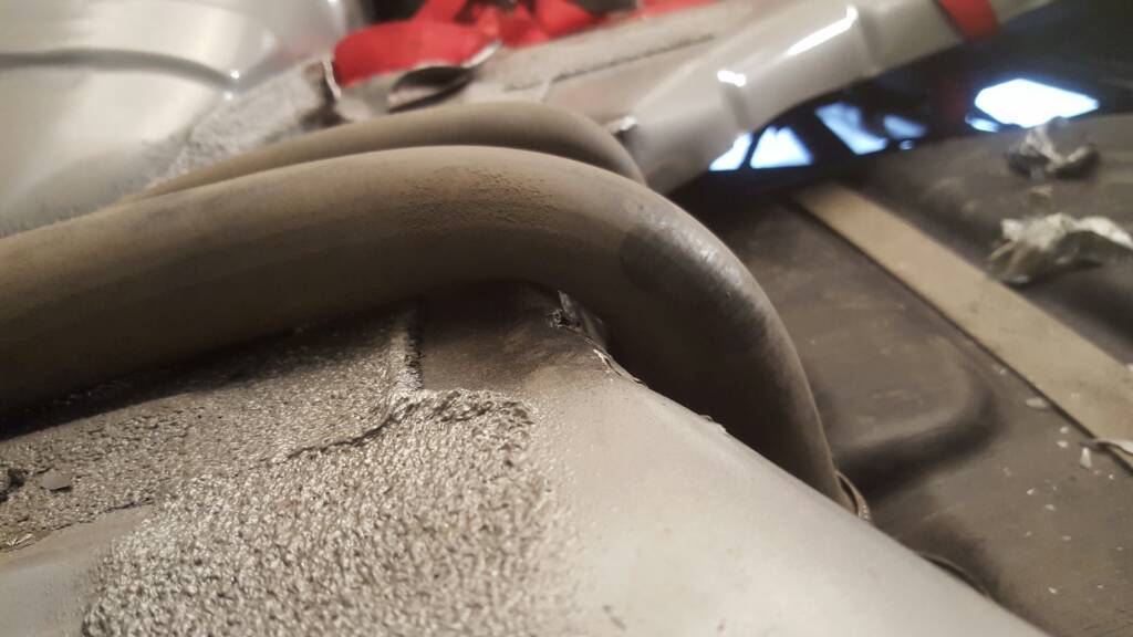

This pic shows where I was unable to cut with the metal sheers so I just cut it with my Dremel tool took a while but didn't want to have sparks by the fuel tank lol
Tank mounted back in the newly modified skid
Hole cut for fuel lines
Tank back in and checking clearance
filler neck is slightly more bent than I would like but it fills just fine no splash back or overflow issues.
lines installed
Don't have a before but this is after gained a ton of clearance

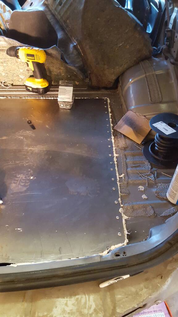

New plate floor (11ga steel) on and sealed with loctite weather proof that will stand up to 150° sealer
I like overkill lol 16 rivots per side
All painted
Used a peach box as a template for my fuel like cover

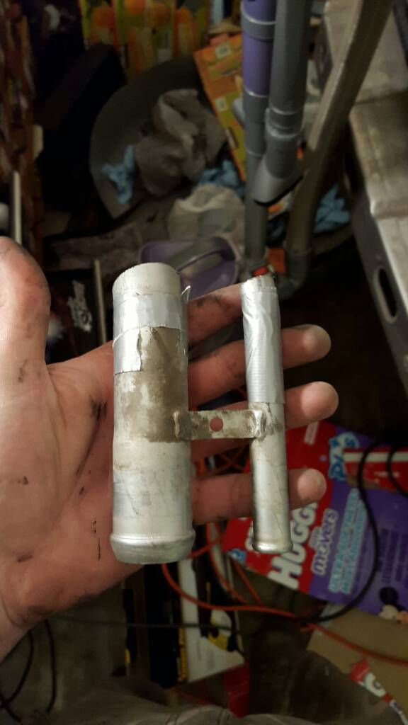

Piece of the filler neck I cut off.
The fuel line box will eventually be covered with this so not worried about damaging it

Tank tuck complete!

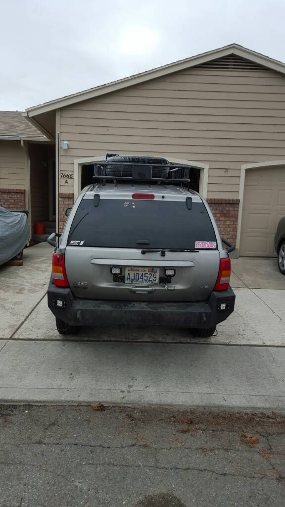

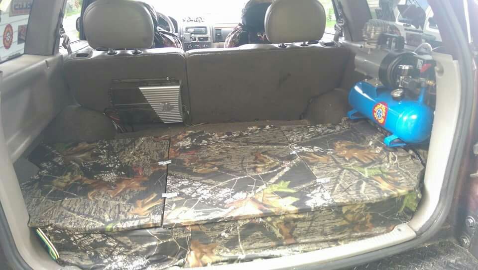

Finally got around to installing my rear bumper again and my recessed reverse lights.
Threw the spare tire on the rack till I get money to build my setup in the back.

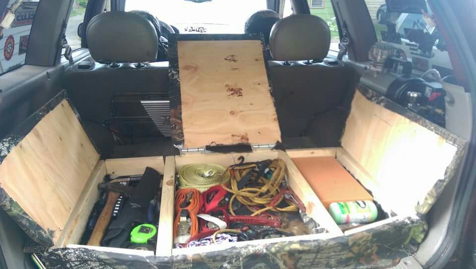

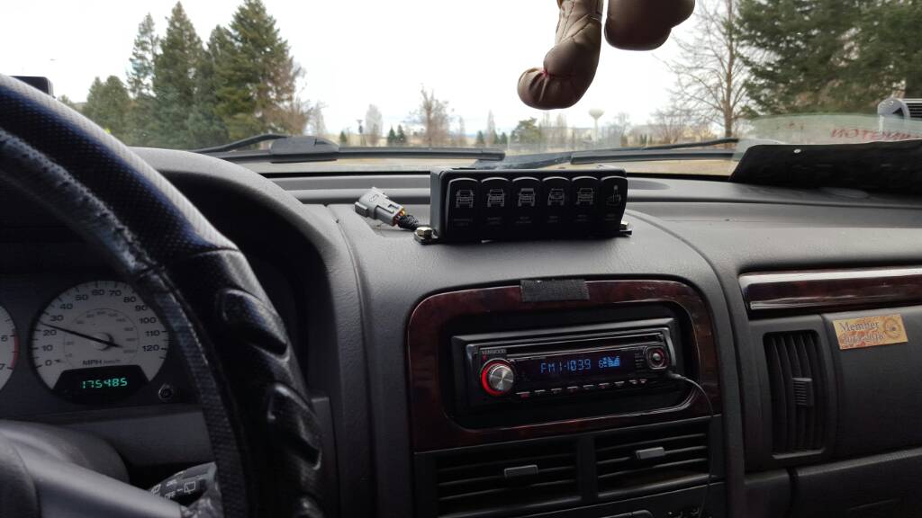

Got my spod switches mounted up. Not my favorite but I can reach all the buttons comfortably.
Also picked up the wood and hardware for my rear cargo area.

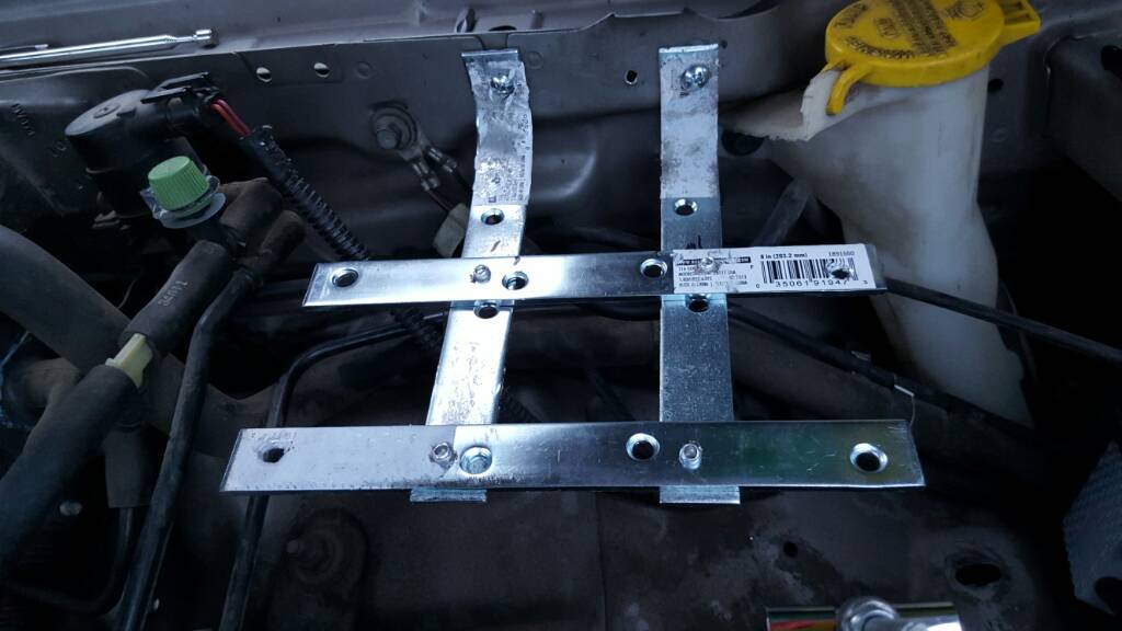

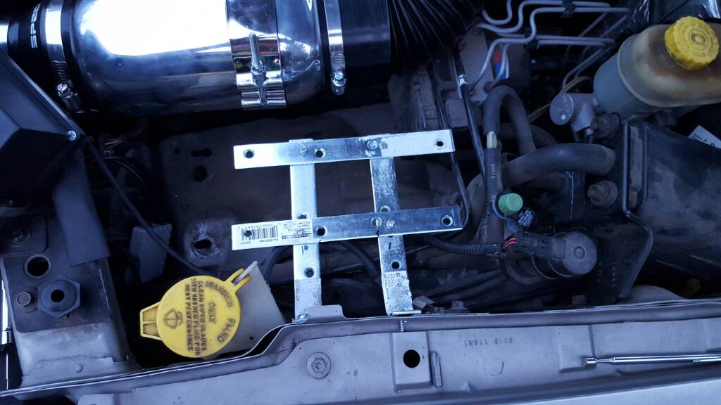

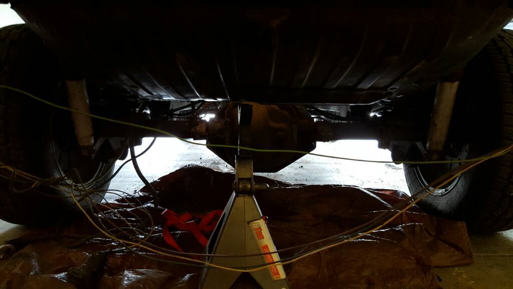

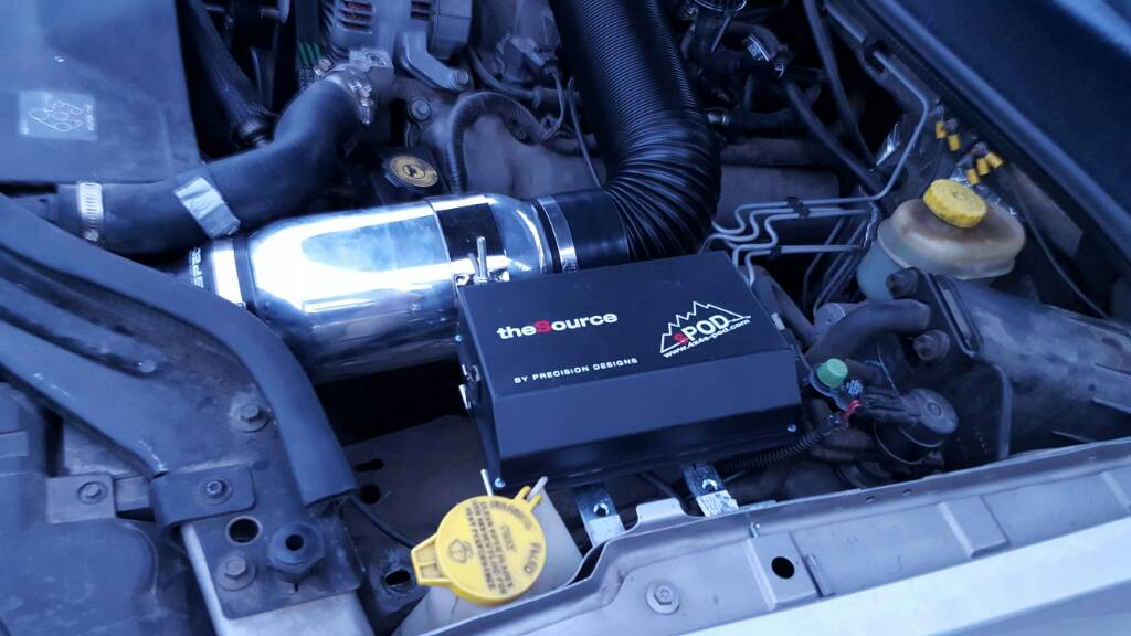

Worked on installing the spod today. Found out my cables are about 4ft too short so I got in contact with them to see about an exchange/purchase longer ones.
Anyways here the bracket I made up its kinda flex so I'd like to add some beefier bolts to it eventually.
Of course when I decide to do my snorkel I'll be moving this setup somewhere else lol
