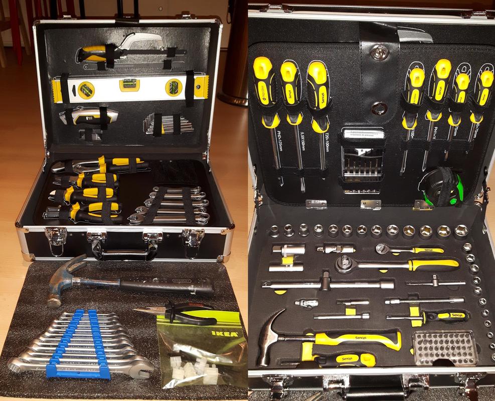

So browsed around a bit for a topic on tools but couldn't find it so fast.. I don't really mean recovery gear/tools but just your averange tools. Do you carry any in your vehicle at all?
I keep bumping into situations (at work as well) that I wished I had some more tools with me so I bought a pretty basic (and not to expensive) tool kit in a nice portable case. Added a few items in it that I already had laying around like good wrench set and a bigger hammer. Probably will add a few more things like good zip ties over time but this has to do for now.

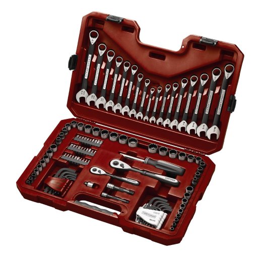

That looks amazing! Although, I think I'd prefer being able to take my tools to where the work is. I've been looking at this...
http://www.sears.com/craftsman-115-pc-universal-mechanics-tool-set/p-00932821000P
...and then a small Pelican Case with all the misc. stuff (larger sockets, pliers, vise grips, hammer, screw drivers, etc).

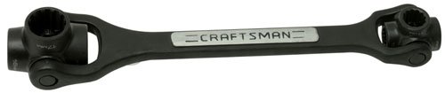

I also carry two of these (Dog Bones), and use them all the time...
