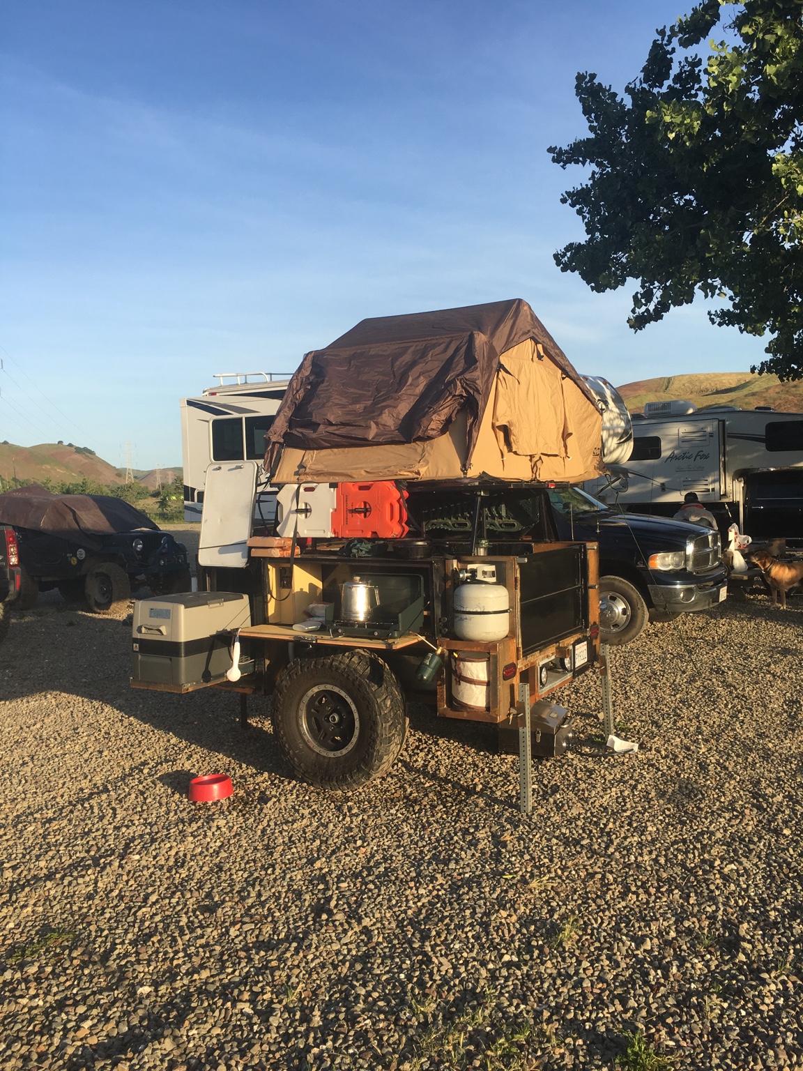

Been awhile since I’ve been on Tapatalk. Thanks for the compliments. Trailer did well last year with 9 days in Oregon and then 12 days in Colorado. It’s been sitting since. Got a new job and has taking all my wheeling away for the year. Hoping to get back into it. Short trip planned in late August and that is the only camping I can get in this year.

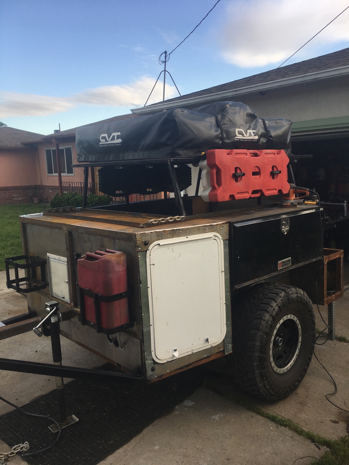

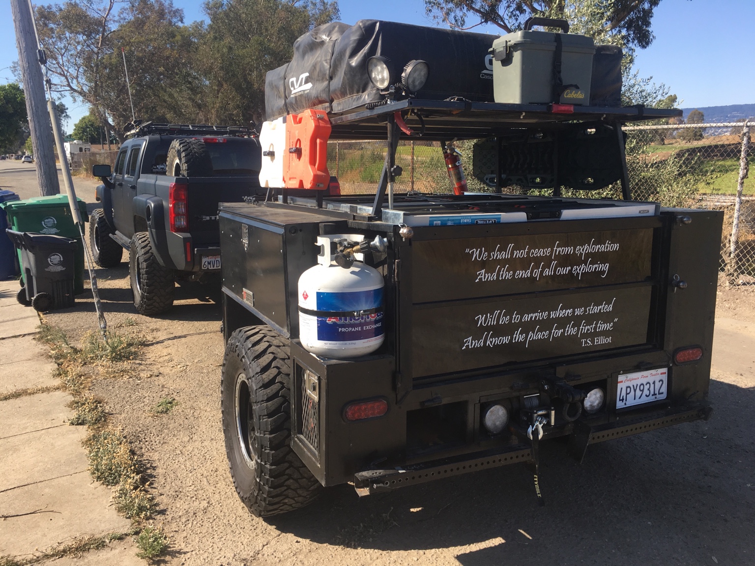

So finally getting a chance to work on trailer build. Interesting point I wanted to share. I plumbed the propane from tank/ regulator to a couple quick disconnects and then up front to water heater. When I altered my Coleman stove to plug into quick disconnects, it didn’t work. Turns out that the stove is a higher pressure usage than everything else. So found an adjustable regulator that I will put at tank and run trailer “system” at stove pressure, then have other items ( water heater, camp fire, BBQ), on their own regulator as well.

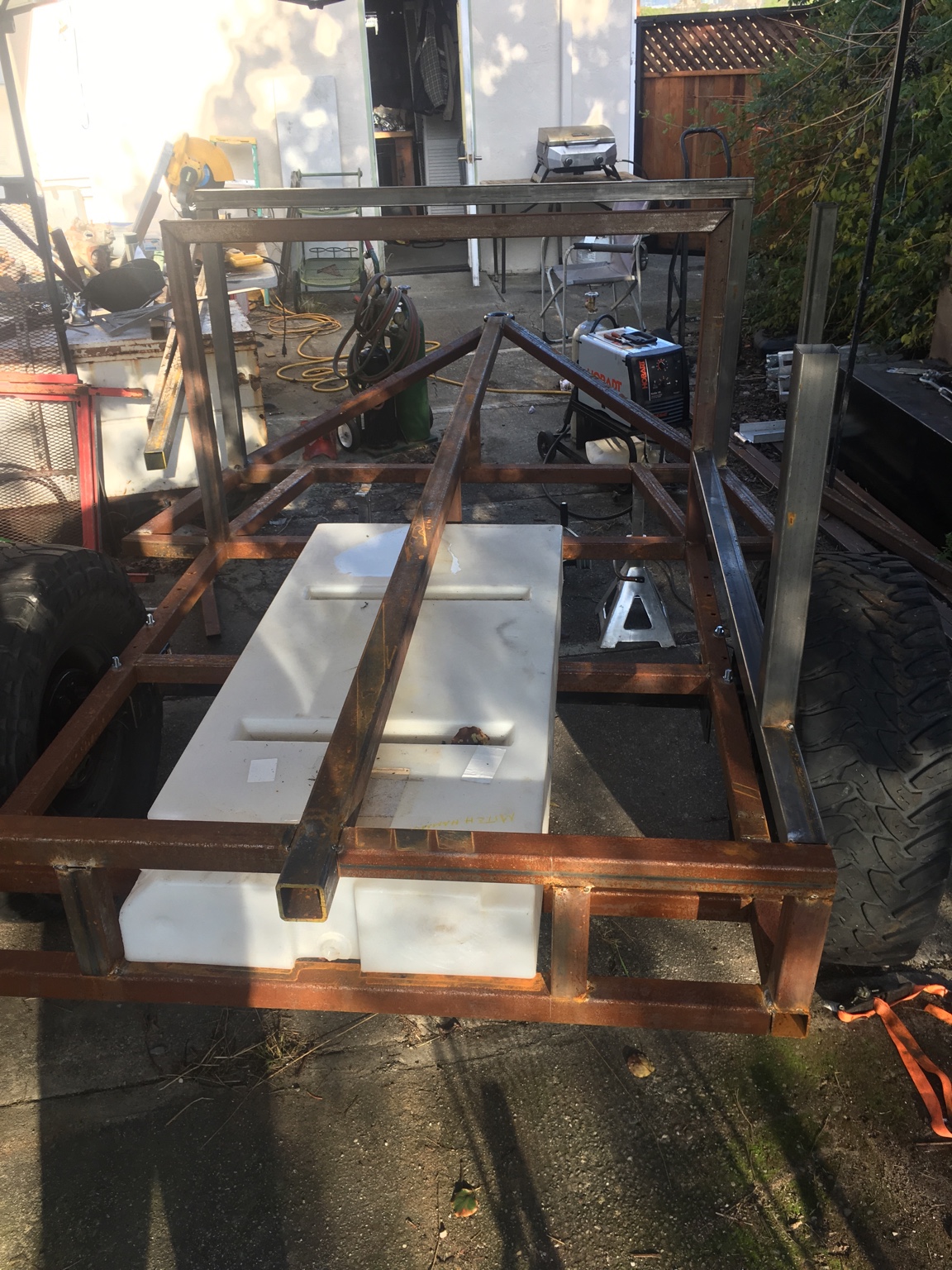

Finally got my "made from scratch" trailer out on its maiden voyage last weekend. Very happy with it

That appears to me to be 2"X2"X3/16" tubing?
Yes, 3/16” wall for structure and 16 gauge incorporated were I could save weight and not affect strength.
Then there is the monster “spine” at 2-1/2” 1/4” wall for hitch
