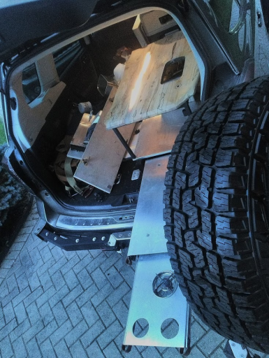

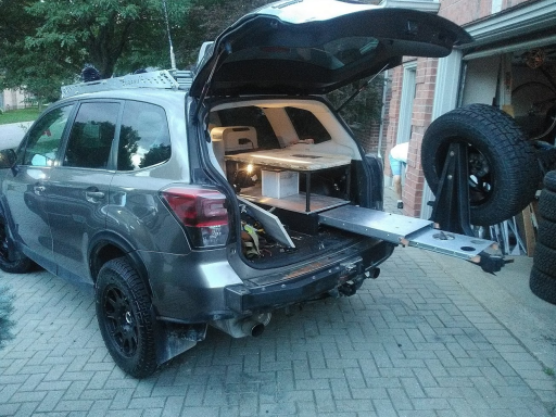

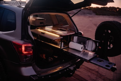

Changed up the camper cabinet a bit. The wood was cracking so I just went full-tilt and welded up a nice little tube steel frame for it:

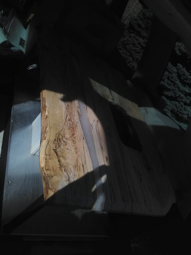

And also did a resin pour that doubles as a cabinet light + interior light!

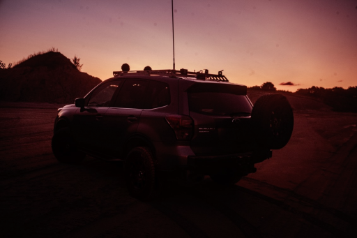

Also, new tires! As far as I know I'm the only SJ Forester running 235/70/R16 Pirelli AT+ and 16" Method 502's in +15. They're designed to fit over STI calipers (or in my case; the larger XT front brakes).
I'll get better pics another day. ;)

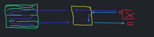

Oh, this would definitely have a thermostat to control it. The Derale one, like this thermostat. It'd be routed as follows:
Red is the OEM cooler/heater circuit. Normally fluid follows the light blue path. I would add a thermostat (yellow box) to keep it following that path if under 180F. If over 180F the thermostat would open and fluid would follow the purple path through the aftermarket cooler (green box). The aftermarket cooler (green box) would also have a fan, to further aid in cooling when at low speeds. Shouldn't that work? It would be mounted in front of the radiator. Yeah, I'd definitely monitor temps with an OBD tool, too!

Don't know if I see a reason to overthink or over complicate a trans cooler. Mounted in front of the radiator, like the stock one already is on the 5th gen Outback, will get air pulled across is when the fans kick on. The thermostat issue can be solved by a proper stacked plate cooler with multiple orifices that regulate flow based on viscosity. Here what I use..

Interesting.. I can see the preview and everything so I wonder why. Regardless its the B&M 70264 cooler if you can't see the details. Rated higher than what we should need but theres nothing wrong with a little overkill haha.

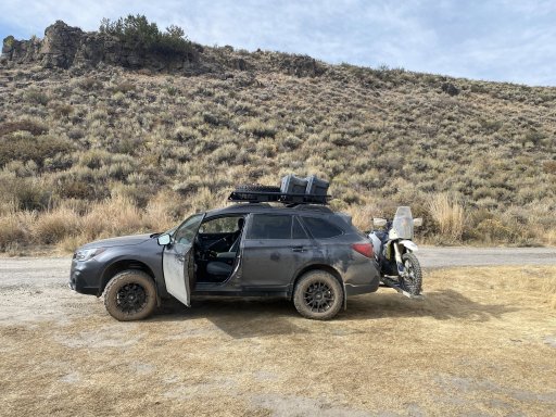

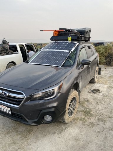

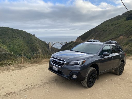

Hello all,
Finally getting back to this.
I have a 2018 Outback 3.6R with a 2" lift and RalliTEK springs:
0.75" Front Raised Springs
0.75" Rear Overload Springs
I sometimes carry a 400 lb motorcycle on a hitch carrier.
When I don’t have the extra weight I need to load a bunch of rocks in the wheel well.
I’m looking for an all in one solution to get the ride hight I want as well as adjustment for load when needed.
Someone mentioned Gorilla suspension.
They look great! Does anyone have experience with them?

That’s quite a load on the hitch but it’s looking good! How long have you had the springs? Still running a rear sway bar?
