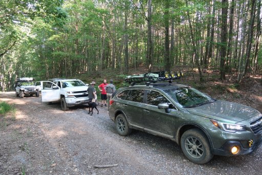

So things got real rowdy on the Georgia Traverse last weekend (but we did finish the entire 390 mile route) & we had a few deep water crossings. Luckily I was able to get in & out fairly quickly without any drama. I haven’t done the canister filter bypass yet, but I am ordering 1 this week. My question is - what is my estimated maximum fording depth as it is & what will it be after the bypass?
2019 Outback 3.6R Touring, 2” front strut spacers, 2.5” rear strut spacers & 2” subframe spacers running 245/65-17 AT rubber. It has Bilstein B6 struts & King Springs if that makes a difference.

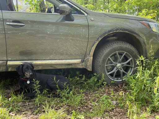

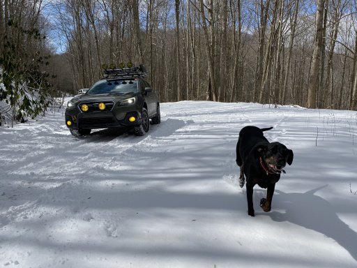

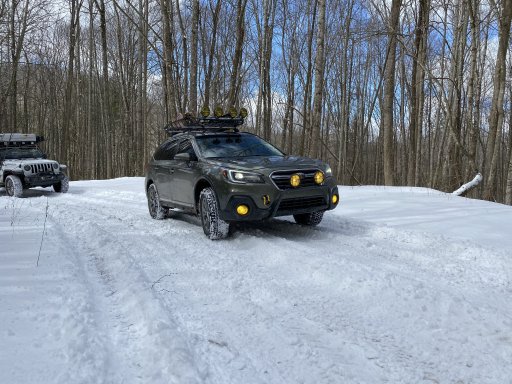

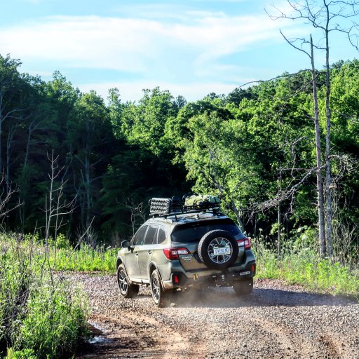

Let’s see...
  • I got rid of the ReadyLift strut spacers in the rear & installed the 2.5” spacers from ADF along w/ the 2” subframe spacers.
  • I got rid of the wheel spacers.
  • I did a complete delete of the rear sway bar.
  • I brought in Bilstein B6 struts paired w/ King springs.
  • I upgraded the ignition system, fuel system, & intake system to feed my internal Clarkson need for more power.
  • The Reese hitch receiver was recessed too far underneath under the rear bumper for the tire carrier so I swapped in 1 from eTrailer. Still a Class III. I sold the Reese to another Subaru Overland Bound member in Charlotte, NC for a bargain.
  • I bought a Wilco Hitchgate Classic from another Overland Bound member in Washington State for a hell of a bargain so I have an easy solution for carrying a fullsize
  • I still have my CB but it only gets used when I’m trying to listen in on truckers to find out what the deal is w/ traffic. I went w/ the Midland MXT275 GMRS base unit w/ a 6dB gain antenna. It is so much better in range & quality. The added benefit of the radio sharing some channels w/ cheap walkie talkies makes it so much easier w/ a spotter for short range, line-of-sight while they are out of the car
  • I extended my Thule basket for now but I want to eventually get a Prisnu
  • I made my own brackets to hold traction boards on the basket
  • I put in a front bumper rally bar from Rally Innovations.
  • I have a set of (2) Hella 500 lights w/ amber lenses on the bumper bar, another set of (4) going across the top of the basket, (1) Baja Designs S2 Sport pod in the basket facing port, (1) facing starboard, & (2) more facing rear. I call the rear facing set my F-You lights bc they make an excellent tailgater repellent.
  • I didn’t want to drop like $800 for a switch panel controller like the SPods go for, so I went w/ an alternative from Infinite Offroad. The buttons in the car are unobtrusive & convenient. The fuse & relay box took a little work to fit under the hood but it’s a solid unit. The company mainly markets products for those side-by-side ATVs so I have a lot of confidence in the box not getting anything nasty to rain hell on my electronics.
  • Primitive Racing engine, transmission, & rear diff armor
I don’t plan on fooling with a RTT. I would only want 1 if I could have a hard shell 1 & a good 1 is like $3k. I’m happy w/ my Gazelle tent & cot at 10% the cost. I also don’t have to sacrifice my backseat for a week long trip since I can load gear in my roof in Pelican waterproof cases.
I looked real hard at the Nameless Exhaust kit bc the 3.6L dual exhaust sounds amazing w/ it. But at $500+ for the dual exhaust w/ 5” mufflers there isn’t any performance gain, & the weight savings is nominal at best - the only benefit is the intoxicating sound of the boxer growl.
I want to get some vinyl done bc I hate the chrome. On my 2019, the folks at Subaru decided to put MORE chrome on the Touring package than the rest of the packages. Unfortunately, I don’t have the steady hands or the patience to do it myself so I am looking for someone to do it for me w/o charging me an arm & a leg. The search continues. I’m also considering changing the wheels to a matte gold to compliment the amber lights.
Here are a few shots from the last few months of rambling around the hills in the Appalachia Wander Wagon! There is a long, grueling lack of adventure between the last snow in February & more recently thanks to the stupid apocalypse. 97C76184-E1EC-4004-B474-A4607478914D.jpegCA8A5947-02D3-4A23-BF0C-83F9D46CAB8E.jpeg546CCCDB-F40E-4C18-8294-E50EB0389F95.jpeg739EF031-A1F7-4159-81E4-D177F7B53C60.jpeg8DCF8040-9D59-4599-B9A0-DFD115644218.jpeg

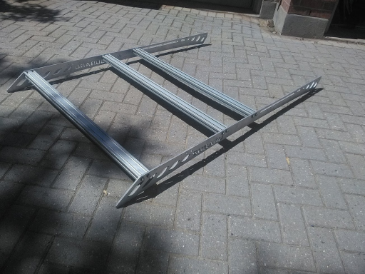

I've been working on a new roof rack these past few days. Lighter weight; more rigid, larger, and lower than the OEM room rails, so once finished with fairings, it should be a bit more aerodynamic as well!
Just roughing out the final position for it... I'll be adding a light bar and removing the two rally lights up top for a more finished look, and better aerodynamics.
So far, so good! If anyone wants the .DWG files to get your own side panels cut via laser or waterjet, I have uploaded them here: Gofile - you'll need 5" x 69" x 3/16 or 1/4 aluminum, minimum.

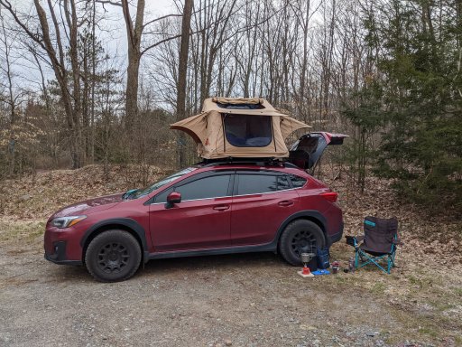

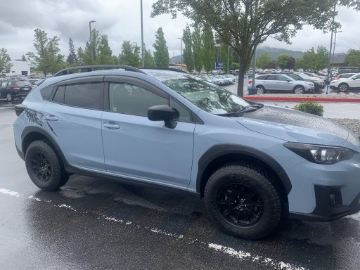

Hey! New member with a 2019 Crosstrek. My GF and I do a cross country camping trip every summer and the Trek is the prefect vehicle for us. We have no kids, and are very happy without them. We love to camp and travel. What sucks is our trip is seriously curtailed this year due to Covid, so I made a ton of upgrades I wont be using right away. So far, just the standard upgrades:
1" ADF lift (picture is before the lift)
215 General Grabber AT2
Motegi MR139s
Tepui Ayer Sky 2 (hate the look, but love to sleep in it)
Custom built folding spare carrier
Tyger Basket
LED bar in the grill
Upgrades on the way:
Smittybuilt Awning is in the mail
Warn Hidden Winch bumper is ordered but wont be installed till fall when I can afford the winch too.
Custom Topo hood blackout and chrome trim wrap (just gotta find a good shop)
Need to figure out an extra fuel can.... maybe a jerry can on the spare or a rotopax on the roof? I dunno...
Need to figure out a portable/solar? charging system for my 12v battery boxIMG_20200420_074156.jpgIMG_20190623_190746.jpg

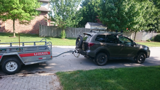

Times being what they are now, I haven't traveled much this summer this summer. Been doing a lot of gardening though, and the Subaru has pulled like a champ; even with 2 cubic yards of topsoil in a 5'x9' Uhaul, it didn't feel like I lost much power, and the big brakes on the XT handled it very well. I wonder how much that weighed? Rough estimates would put it around the UK Forester XT's capacity of 4400lbs.

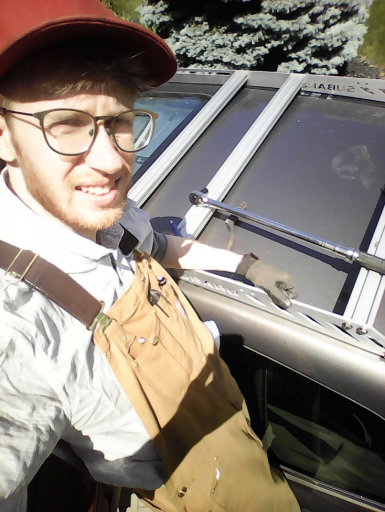

Also had a chance to finish that new roof rack I designed...
Really happy with how it turned out!

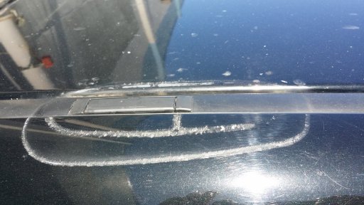

I took off my roof rack and rails last weekend since the rack needed to be painted, and I came across this issue. It looks like my "spirited driving" on the trails might have caused the rail mounting to rub through the paint in all four spots. Has anyone had this happen (2011 Impreza OBS for reference)? Any suggestions to remedy it? The paint on the car is shot anyways (most of those white spots can not be removed) so I'm not looking for a new car look, just something to keep it protected. I'm also considering a rubber gasket of some sort to keep the plastic from the rail mount from rubbing and causing more damage. OR, I can finally get off my lazy butt and make those low profile custom rails I always wanted...

I dont know if this is the stuff, but, i've seen people use something like this to attach like, a camera with a magnet attachment base that would go on the car, they just put this stuff on the car first so that the magnet doesn't scratch the paint. 3M Paint Protection Film
