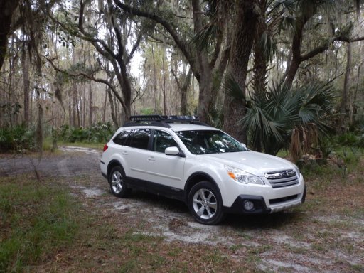

Time for new tires on my Wife’s Outback, Michelin Defenders are on the vehicle now. We run state and forest roads from Fl to NC,nothing close to extreme. Would like some input on the Yokohama Geolander ATG015. Her BIG concern is road noise. 60728264-477B-461B-9D86-5149708F60BD.jpegI read the reviews on Tire Rack and most say they are pretty quiet for an AT tire. Mileage and performance? Pre-Thanks for the input.
Time for new tires on my Wife’s Outback, Michelin Defenders are on the vehicle now. We run state and forest roads from Fl to NC,nothing close to extreme. Would like some input on the Yokohama Geolander ATG015. Her BIG concern is road noise. View attachment 149333I read the reviews on Tire Rack and most say they are pretty quiet for an AT tire. Mileage and performance? Pre-Thanks for the input.
I run the Geolandars and I love them. They're super quiet on the road and quite capable on the trail as well. I've got about 10k miles on mine so far and they seem to be wearing very well.
Reactions: Flipper
I went with the Falken Wildpeak A/T Trail on my Crosstrek and they’re very quiet . I have about 3k on them now.
The Kuhmo AT51's were moderately quiet on my '19 OB for the first 3-5k miles, but at over 15k now they do have a slight hum, but it isn't obnoxious like some of the more aggressively tread options like what you'd hear from the BFG's.
Thanks Jeff and the other replies. We chatted a couple months ago. Did you ever get out to Lake Fontana or the Ocoee River yet?
