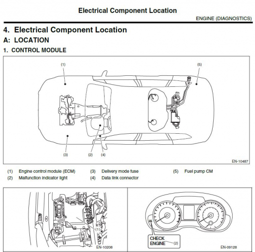

Inspired by @CurrentlyRockhoundin and his pursuit to waterproof a Subie, I've got a few questions...
What would be the best way to waterproof the ECM/ECU in a SJ XT Forester?
I was thinking that you could fit it inside a IP68 6"x6"x2" electrical box and put the cables through waterproof glands, or seal them up with silicone. Would that be an overheating issue? Alternatively, I suppose you could plastidip the terminals... :grin: is any of this really worth doing? Does anyone know if the ECM is already waterproofed?

Couple things. It’s above your intake so IP ratings may be a bit much haha. Curiously enough it’s also in the engine compartment so it has to have a water resistance rating. I could never say for sure in your case but the Legacy/Outback ECM is in a small closed off compartment under the carpet in the passenger footwell so I can’t imagine it breathes well in there. Heat may not be an issue.

I would assume that it's already very water resistant. Like wawa said for the Outback the issue with the ECU being on the floor in the cabin so if you flood it your SOL.
If you want to make it bulletproof, assuming the bullets are made of water then put the ECU in a pelican case with waterproof glands.
People on www.subaruforester.org mentioned the follow for waterproofing.
"The floor has a couple of holes in it for some reason. There are about 6 very small ones under the back seat, and a few more in various places throughout the center driveshaft tunnel. They aren't "direct" holes to the outside, but they aren't completely sealed either. So if you sit in deep water like a re-re (as I did), you will get water under the carpets. I was VERY lucky I didn't get water in/on the ECU or I would have been screwed (as the ECU sits in the passenger footwell about an inch off the actual floor.)
There is no way to make it completely "waterproof", but you can make it as water-resistant as you can.
- Silicone and fill in the holes that you can find in the floor and underneath the chassis.
- Extend the "breathers" for the front and rear diffs.
- Put an "extension" on the front diff filler neck. (I put a rubber fuel line as an extension, but I can take it off to put back in the dipstick to check levels)
- Check firewall for any holes or areas where water could possibly get in.
- Tend to all the electrical connections under the hood with dielectric grease.
- If you want to go extreme, move the ECU higher up the firewall to avoid destroying it if some water does get in the car.
Now, this snorkel is for added benefit when crossing water and such, BUT I mainly want it because of the dust. Snorkels serve two purposes, water protection and to prevent high dust inhalation. I had a brand new air filter in the car, and after only about 30 minutes of following a buddy down a very dusty road, my filter was completely packed full of dust, the MAF was covered in crap, and the intake to the turbo had a thin coating of dust as well.
The snorkel gets air from above the "dust line", and keeps the air going into your engine cleaner than if you are still sucking in a great deal of dust from behind the headlamp in the engine bay."

Personally, I would think doing anything to try to waterproof it would be unnecessary. Considering how high the ECM is in the engine bay, if you ever have water up to that level that would warrant better waterproofing, the ECM is probably the least of your concerns because you'll be floating. :laughing:
Baipin
You make a good point. I'd probably be looking for my window breaker if it got that high - hah!
I guess the only thing that concerns me is water intrusion from quick immersion (say, hitting a rut while fording and having water splash up onto the electrical contacts). I'll take a look and see just how waterproof they are. I covered a small part of exposed wiring leading into in the DT connectors at the back, near the backup sensors, with silicone. That's been fine so far. Long story short; they lead to a blewn fuse and some major headaches looking for what was ultimately a simple fix.
Right on. As @Wawa Skittletits and @CurrentlyRockhoundin already mentioned, anything in the engine compartment should be sufficiently capable of handling a hefty water splash.
