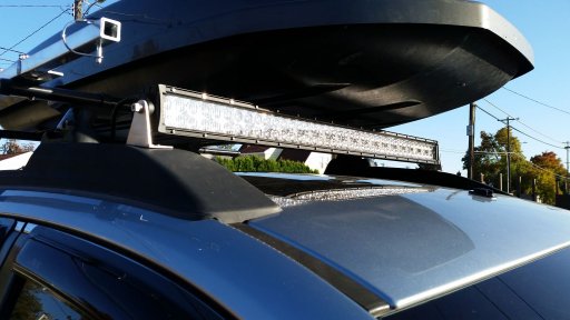

Got this guy installed today, had to make up some brackets cause the ones it came with were just a little too tall and wide cause at 42" the light just barely fits.
Any suggestions on how to make entry with the wire?

Lookin' good! I routed mine down from the front lights - similar location to this setup - along the inside of the roof rack bars to the back of my Forester, and in through the tail gate. I put a hole in the rubber grommet that the tail gate's own wires run though, then sealed it with "spray-on electrical tape". Plastidip would do too.

Thanks ill likely run it like that as well.

For my CB antenna, because it's on the front of the roof, I came down in the roof rail gutter, then in a gutter that runs down the side of my windshield (I can't tell from the picture if your windshield has the same), then into the engine bay, then through the electrical grommet in the firewall. For my Ham antenna, which is mounted on my back gate, I ran the cable above the roof liner, then behind the plastic piece covering the pillar between the front and rear passenger seats, to come out under the front passenger seat (where my base unit is located).

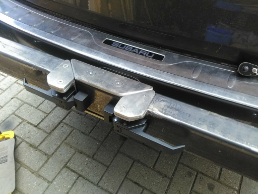

Finished the structural bits and the latch on my bumper build:
Very happy with how the stainless sill plates turned out. All cut, ground, and polished with an angle grinder and a handheld belt sander in one afternoon!
All that's left now is paint, a few weld-nuts for the jerry can holder and spare tire carrier, and to make some wear surfaces for the swing-out. I'm thinking of using Kydex for that.

That looks so clean!

Looks great! would love to see a build thread on this. How do you have it attached? Do you have a receiver hitch below the center mount/latch point? I was planning to build a tire carrier myself, and would like to copy your design.

Thanks for the nice words! You can find my build here. I really need to update the bumper photos, because a lot of changed or been added, but nevertheless... Subaru Forester - '18 XT

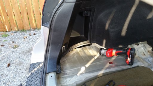

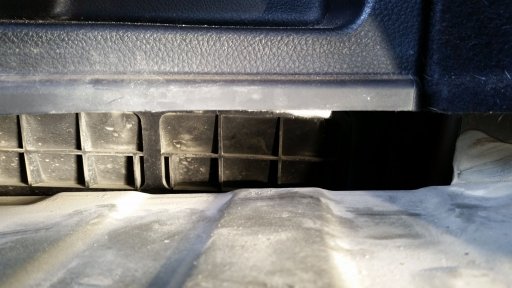

Well this is disappointing a little bit. As I make attempts to waterproof my 2012 Outback I see it has rear vents on both sides which I assume are to aid in closing the doors. Do you think it's worth it to take off the panels, remove the vents and seal them up from the outside?
Option B would be to glue them from the inside so they could never be stuck in the open position.
Thoughts?

I can say from experience, having forded this...
...that even when the rear-driverside vents went underwater each time I exited a puddle or hit a rut within them, I did not take any water in. My SJ Forester has vents in the same location behind the rear wheelwells. As long as you're moving, you shouldn't be bringing anything in. I'd assume that, because of how the vents are designed to open outwards, a little bit of water splashing against them would force them to seal. That said; always better safe them sorry. So maybe work on waterproofing more critical and vulnerable parts of the vehicle before you worry about this.

Thanks! Ill keep these on the to do list but hold off for now.
