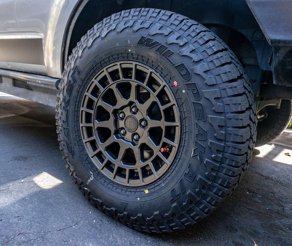

Got the new wheels and tires mounted up. Love the fact the my FXT is able to fit 15" wheels without any issues when compared to thew newer SJ Forester XTs (2014-2017). Also who says you cant run 30" tires on an SH Foz. This size is almost the exact same as my previous setup. My old setup was 29.5" Wildpeaks on 16" Sparco wheels. This setup weighs exactly the same as my previous setup with the benefits of more meat/sidewall. 30" is the absolute largest tire I would personally fit on a Subaru without the option to regear. I was also able to remove my ISC 25mm wheel spacers due to the +15 offset of the wheels as well.
Wheels: Black Rhino Boxer 15x7 +15 offset 5x100 (15lbs each)
Tires: Falken Wildpeak AT3W 30x9.5 (43 lbs each)

Very Nice.
How is the 4" lift doing?

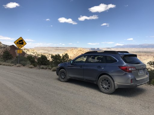

New here to OB, and I am tickled pink to see Subies well represented in the overloading community.
Here's my year-old Outback 3.6R:
This is taken from the Wedge Overlook Trail in Utah.
And this is taken just before plunging down the Burr Trail switchbacks into the Water Pocket Fold.
While I'm impressed by the ride and creature comforts, there will be things that need to be done. I need to increase approach (especially) and departure and breakover angles, and to that end I will eventually add a lift and perhaps a spring change. I also want metal bumpers to help achieve those angles, but that of course entails a holistic approach to modifying the rig: steel bumpers mean weight, which means sag, which means spring rates and lift heights . . . I get the feeling I'm about to dive into a rabbit hole! To add protection I also want to look at how feasible it would be to add rocker guards in place of the plastic cladding. How to do that with a unibody design may get interesting.
Monday I have an appointment with the good folks at Leadfoot Racing (the guys who did Fozroamer's bumper build) to talk Outback. They say they're interested in getting into Gen. 5 Outbacks. I'll report back afterwards.
Love the Methods, though, and the G015s have been great. I swear they're quieter on the highway than the OEM Duelers, and I have not noticed one single fraction of an MPG drop in fuel efficiency.

It sure does look right at home sitting on those Methods and covered in dust/dirt. Definitely curious to see where your adventure into the rabbit hole takes you.

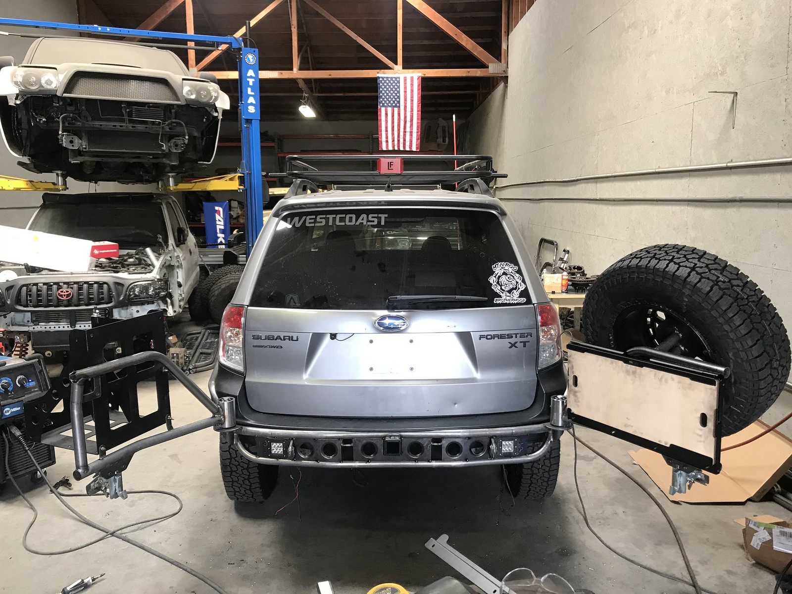

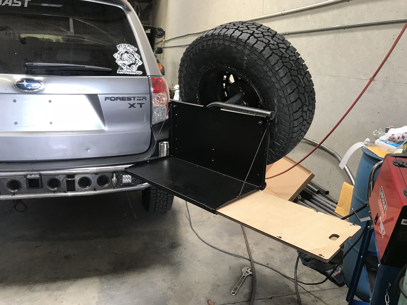

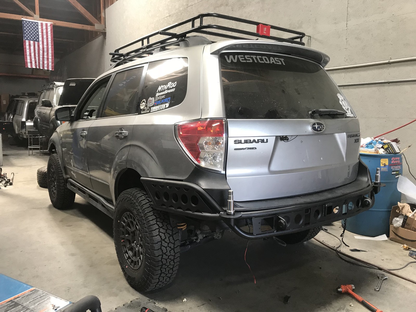

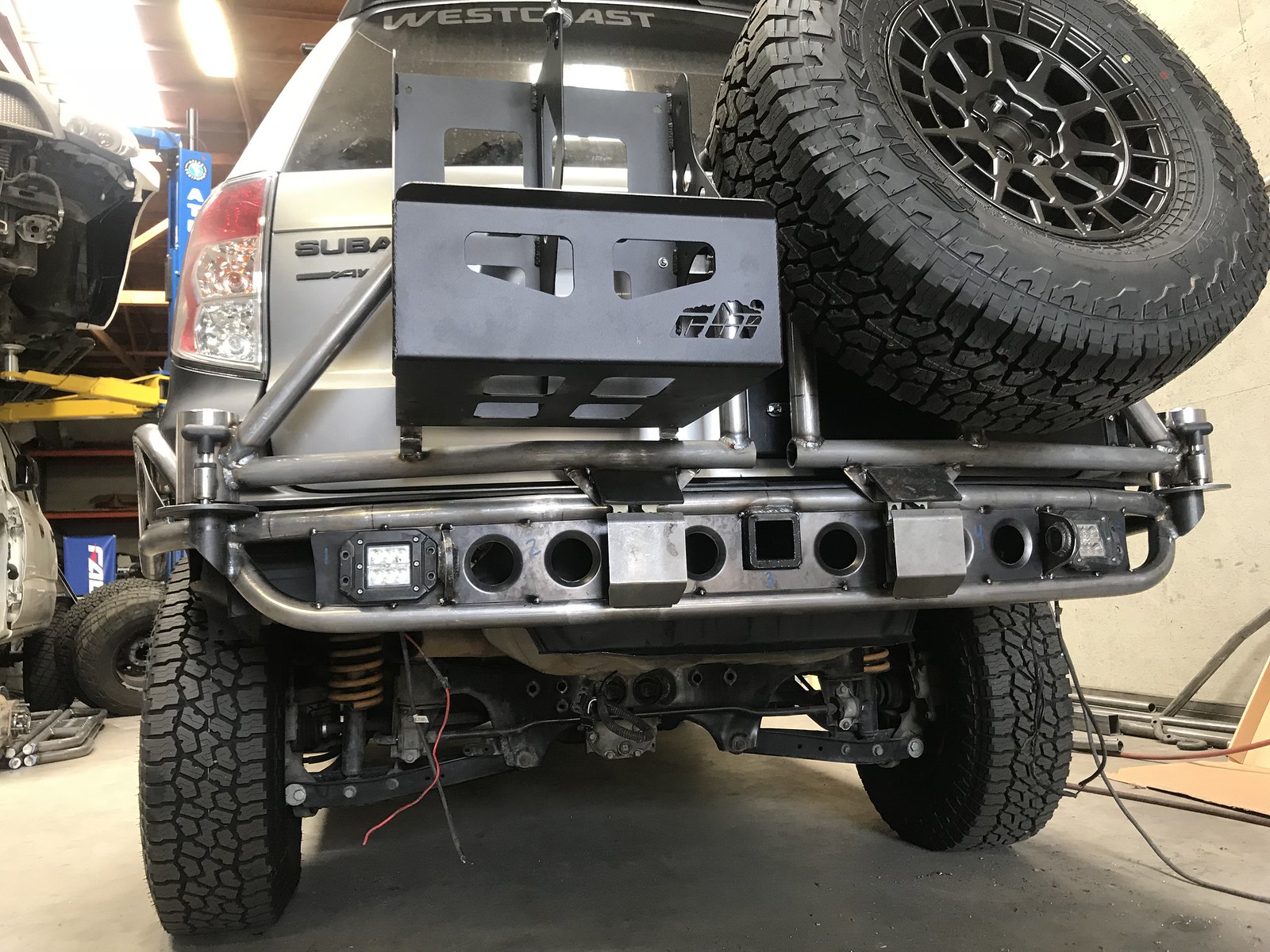

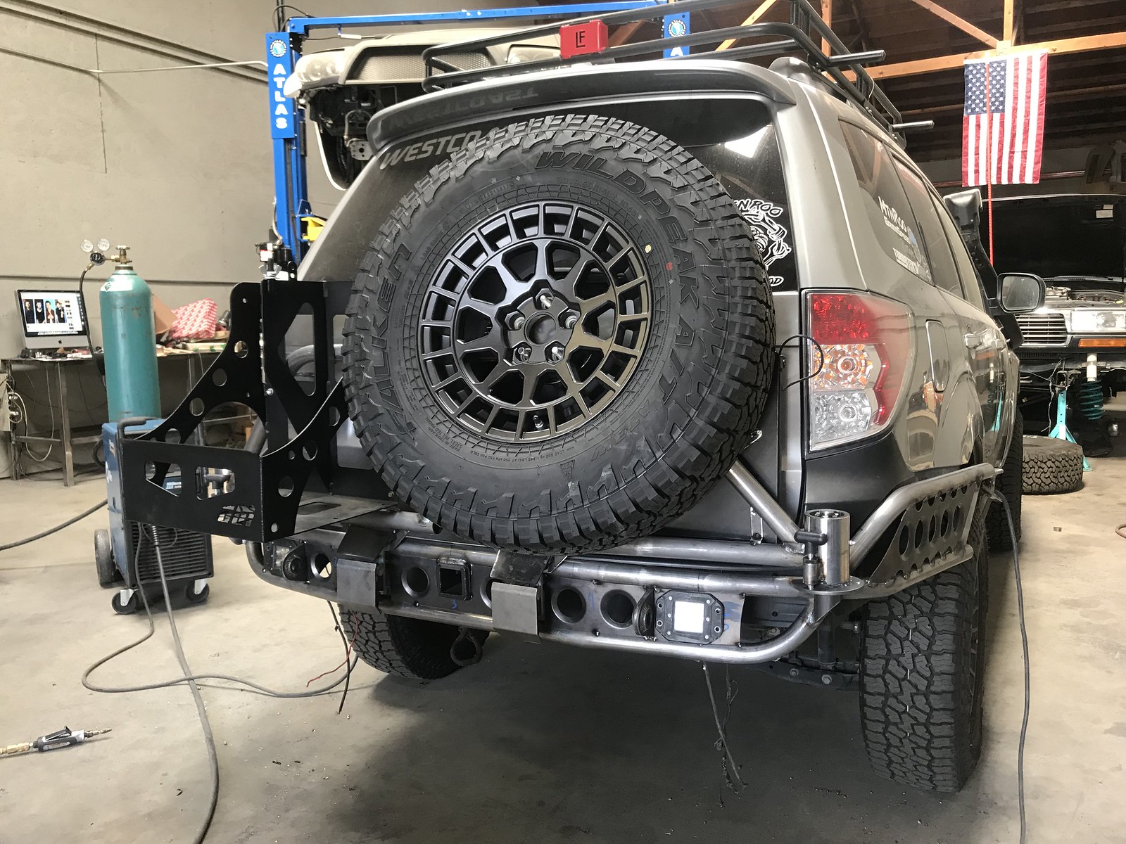

Yes I am alive... Just made a big move hundreds of miles away and been dealing with life stuff as of late. I had a new bumper built by Stellar Built in Sacramento. Finally got everything painted just gotta do some wiring cleanup. Dont have a total weight for it yet but by my rough calculations is that its about 40%-ish lighter than my previous bumper, which was 1/4" plate steel. Below are some pics and I am really happy with the design. I mainly redesigned this bumper to cut down on weight and to have a dual swing arm setup so that I can get into my rear hatch when towing my trailer. With the previous bumper the one large swing arm would hit the trailer so I would have to disconnect it to get back to the rear hatch area to access the fridge, gear, etc.
Includes Expedition One latches (patent pending) CBI dual jerry can holder, FrontRunner Outfitters Drop Down table, and Synergy heavy duty spindles.

Very Nice, your latches are pretty sweet.
Do you have any pictures of how you have it bolted to the Forester?
Again, very nice.
