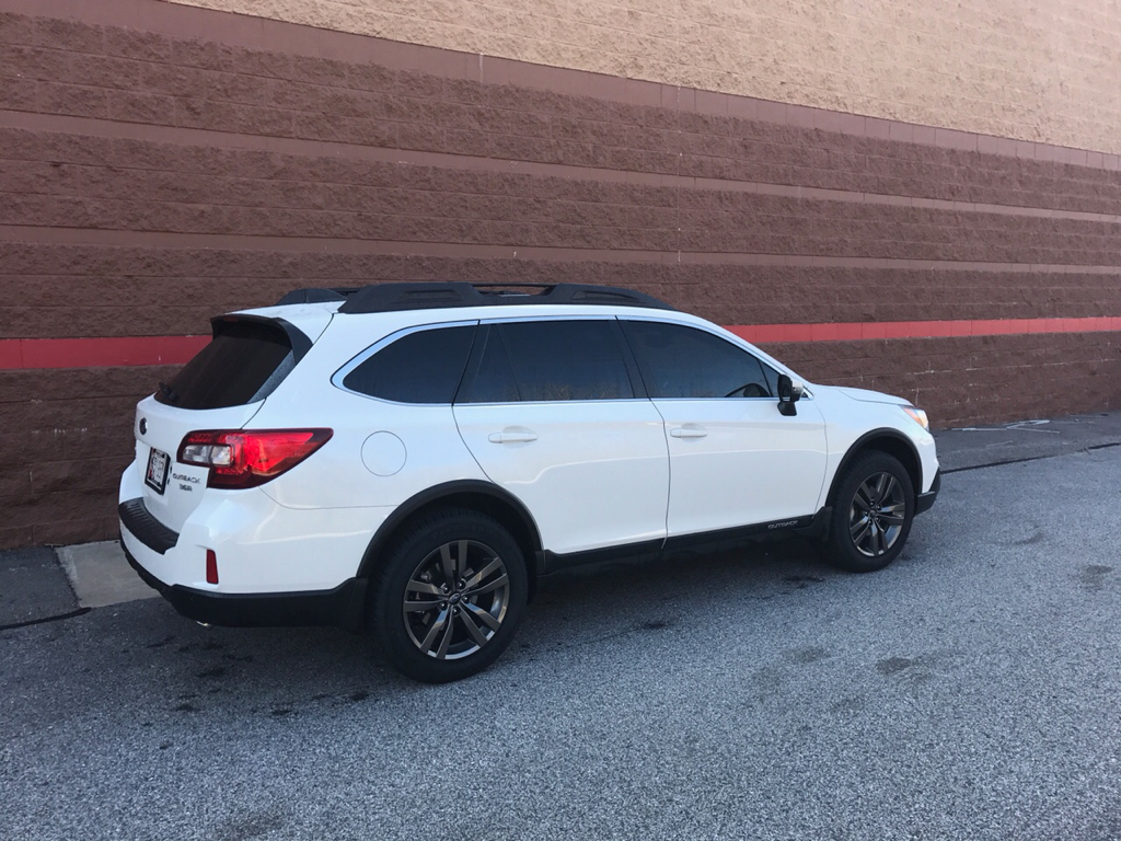

This is our (my wife's daily) 2017 Outback 3.6. Our 4Runner gets used for anything rougher than dirt or forest roads but for most of the state forest roads in PA we take the Outback. It's a 2017 Outback 3.6. We have a few sets of tires and wheels for it depending on the use (Geolander's, Blizzak's, and Firehawk Wide Oval's) but other than that it's mostly stock. My wife does want to mount some awning mounts to the factory tie down points on the OEM rails so that we can move our ARB awning over to it for the Subaru Trips.

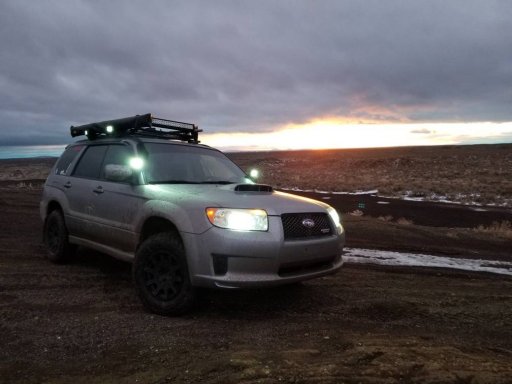

Hey, i'm late to the party! I'm Tyler. Wr are from Rexburg, Idaho which is in the south east region of the state. Some of you already follow me on IG, but for those that don't, it's @tyleromyah. If you ever find yourself out this way, give me a holler!!
Here is out 2007 fxt..
Invidia downpipe
Prodrive turboback exhaust
Drop in k&n air filter
Cobb tune (once the motor needs rebuilt, i will have it correctly protuned)
2" adf lift
15" methods
215/75/15 bfg a/t ko2
Reese cargo basket (it has impressed me)
Smittybilt 6x6 awning
2 led pods mounted under the awning for camp light
Axe/shovel mount
32" light bar
Led pods/custom mounts for brush lights (mounted to side mirrors)
Adf molle racks
Fully functional kitchen
Just purchased a 23zero RTT, haven't thrown it on yet. Purchased at CBI Offroad fabrication in Idaho Falls.
Soon to come..
Rock sliders
Skid plates

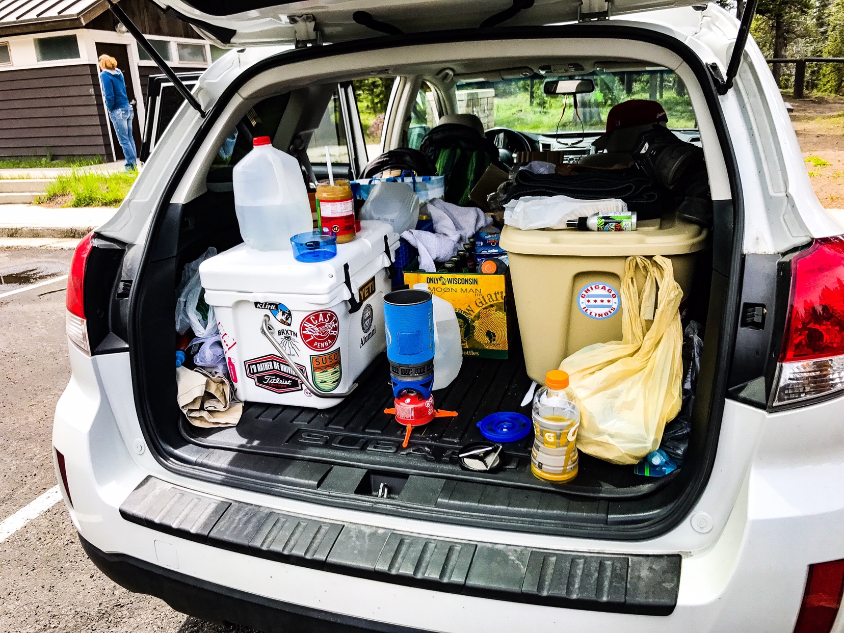

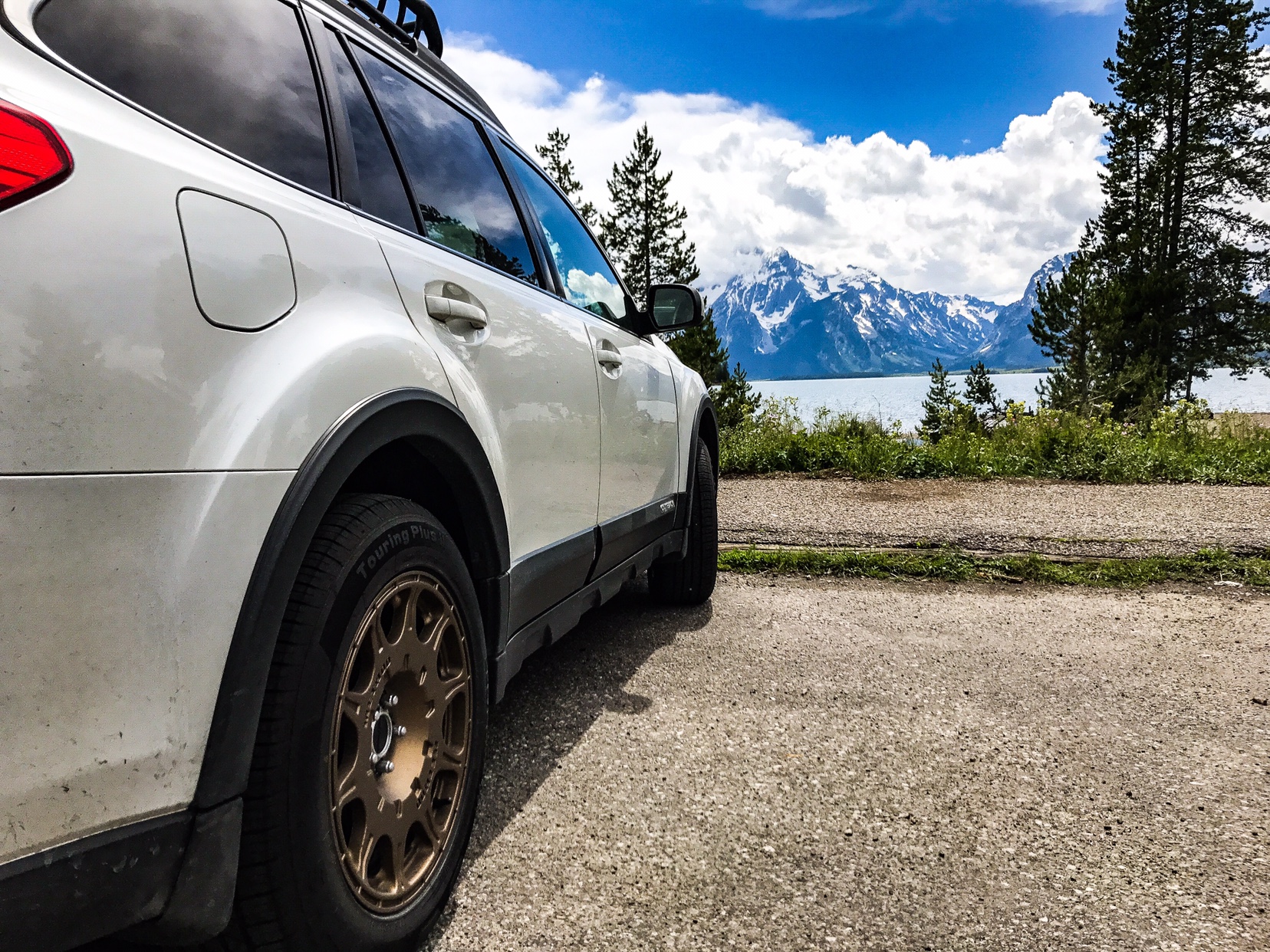

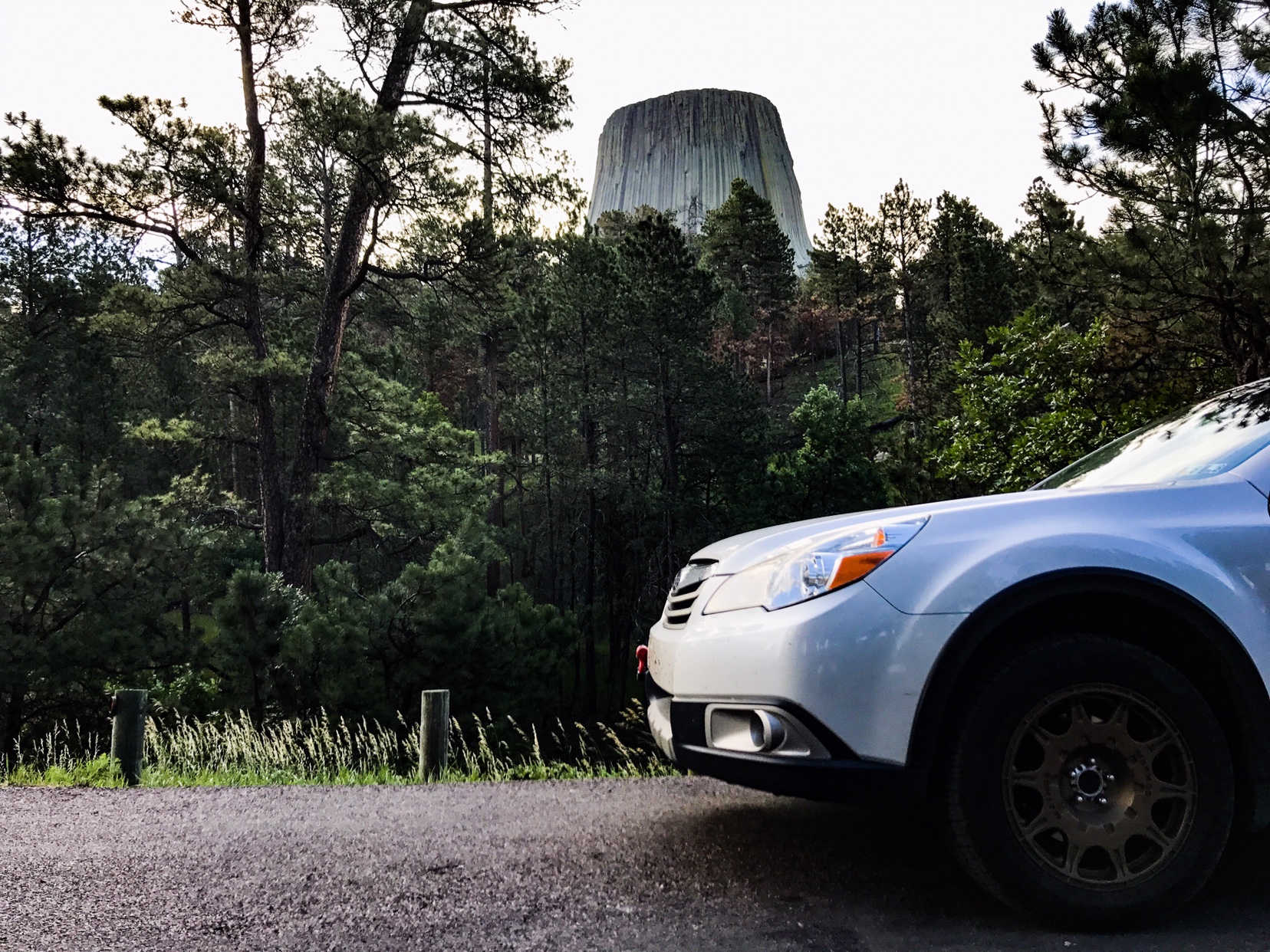

So I guess this is really here nor there, but I had considered keeping track of my most recent trip on here.
Over the summer, from early June thru mid-July, I spent 40-some days making a 7,250 mile loop across the country and back...camping most of the way. I documented most of it on instagram (n8.leonard if you care...), so you're welcome to look.
I've loved Subarus forever, but this new-to-me 2010 Outback has been a dream come true. It's a high (ish) mileage 3.6R, yet it's a complete road warrior.

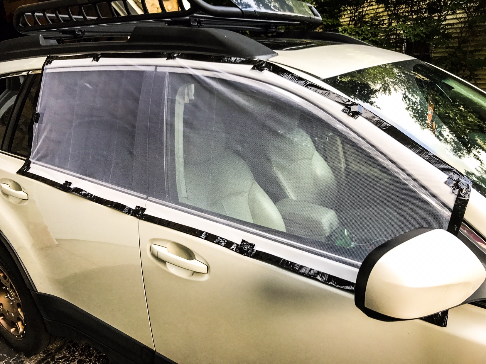

Here are some highlights...including a little bug netting ingenuity for the nights spent sleeping in the car. Around the Great Lakes, it was a total necessity...haha.

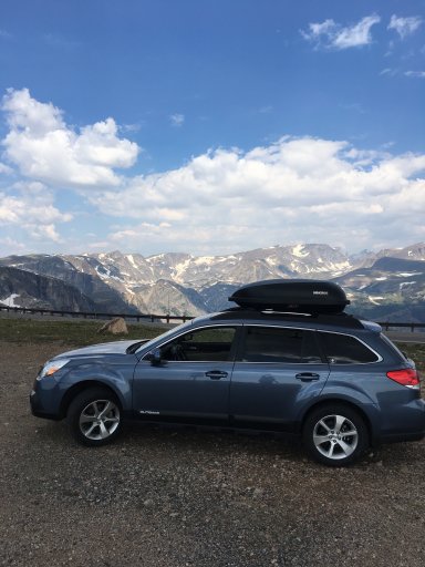

Love your pics! I think we did a similar trip. I was out mid July through the end of August. 7020 miles through Badlands NP, Wind Cave NP, Mount Rushmore, Custer State Park (Sylvan Lake), Devils Tower, Little Big Horn, Yellowstone NP, Grand Teton NP, Rocky Mountain NP, Palo Duro Canyon. My 2013 Outback was perfect!

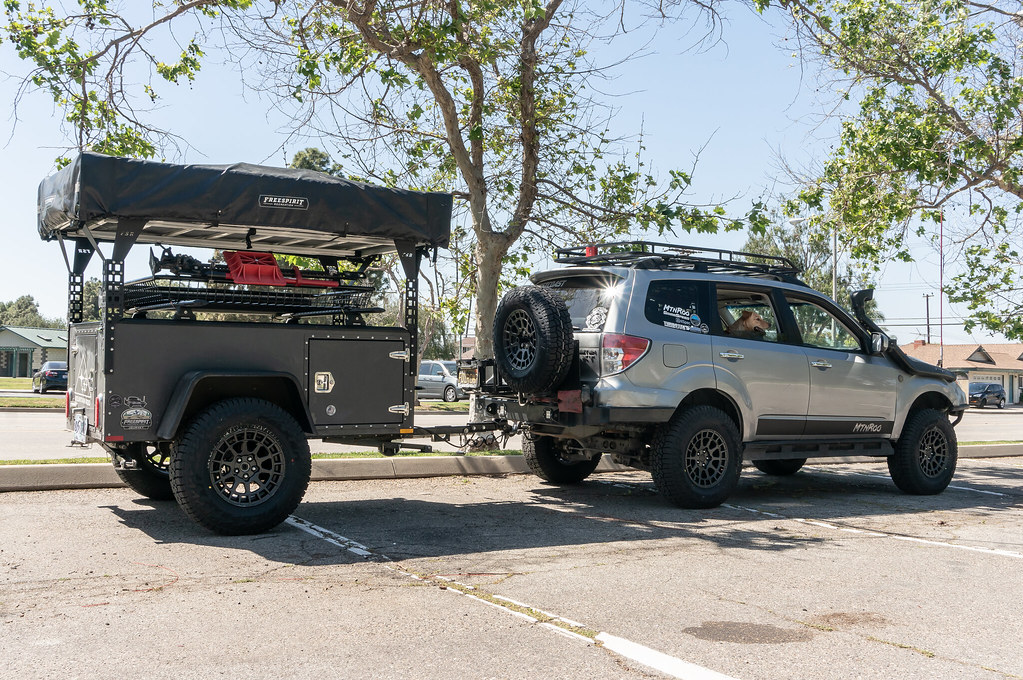

Got the new wheels and tires mounted up. Love the fact the my FXT is able to fit 15" wheels without any issues when compared to thew newer SJ Forester XTs (2014-2017). Also who says you cant run 30" tires on an SH Foz. This size is almost the exact same as my previous setup. My old setup was 29.5" Wildpeaks on 16" Sparco wheels. This setup weighs exactly the same as my previous setup with the benefits of more meat/sidewall. 30" is the absolute largest tire I would personally fit on a Subaru without the option to regear. I was also able to remove my ISC 25mm wheel spacers due to the +15 offset of the wheels as well.
Wheels: Black Rhino Boxer 15x7 +15 offset 5x100 (15lbs each)
Tires: Falken Wildpeak AT3W 30x9.5 (43 lbs each)
