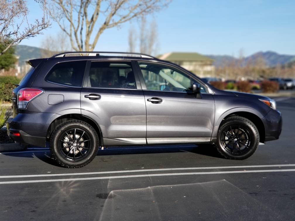

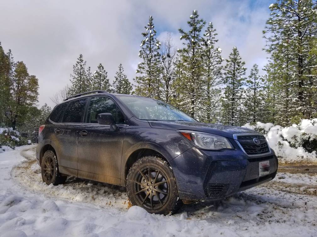

Hello Subaru enthusiasts. Here's our first Subaru, a 2017 FXT, purchased a month ago. It's my wife's daily driver. I'm thinking about getting her a membership and getting her badged. We still haven't taken her on her maiden adventure yet, but it's coming soon.
So far we have 235/60R17 Cooper Discovery ATs and a K&N air filter.
I'm loooking forward to seeing you all on the trails and at the meets.

Sweet!!! My old Outback’s wheels came from an FXT. I sure miss that OBXT some days. And the WRX Wagon, too!
You and Mrs NCC can share a member number if you’d like. All you would need then is a duplicate badge in the Member Store.

That's what I'm thinking, because she probably wouldn't be active on the forums as much as me.

Looking good! Try not to fall in love with the Forester when you learn how much fun and versatile Subaru's are off road hahaha!

Welcome to the reason we call it Subaru weather @NorCalCrisp haha.
