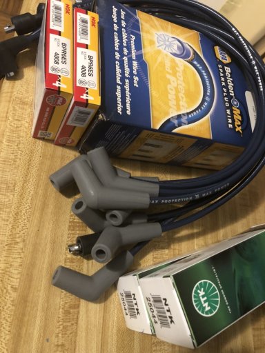

Where are you getting these parts . How many sensors are involved. When you change one is it necessary to change all (wise decision). Did your diagnostic devise tell you they needed to be changed ? Why can't ordinary Auto Lite spark plugs be used, same question for plug wires. What about the coil and distributor parts, will they need to be changed as well ? Because the engine is supposed to be a Buick design, cant GM parts be just as good ? Dont you just love talking to a dumbo ?Got another order of parts placed over the weekend. New O2 sensors, plugs, plug wires, and bearings to do the rear.

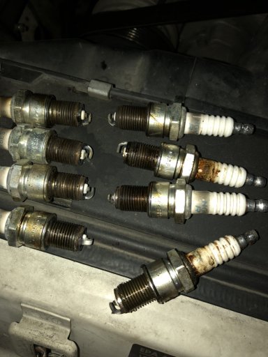

The plugs are just copper NGKs iirc the factory champions were minimum order of 24 and I’m not that committed to one plug over another, just didn’t want to spend $30 on plugs atm. No distributor, and the coil packs are working well looking at their waveforms. The injectors on the other hand are whooped, but I’m researching replacements atm. The O2s I ordered were the front pair, the rears don’t effect fuel trim only emissions compliance(so long as they aren’t setting codes at least). The plugs in the engine were run full rich for a while while the truck had the major exhaust leak, but I wanted to be sure it was all happy exhaust wise before I poured money into replacing the simplest of ignition components. The plug wires on it are some expensive aftermarket set that the LR forum guys swear by but I can’t stand the terrible fit and routing of them.Did your diagnostic devise tell you they needed to be changed ? Why can't ordinary Auto Lite spark plugs be used, same question for plug wires. What about the coil and distributor parts, will they need to be changed as well ? Because the engine is supposed to be a Buick design, cant GM parts be just as good ? Dont you just love talking to a dumbo ?

That's okay, I too would have expected more. I had to buy a plug set, spark plugs and inline gas filter for my old international this week and was surprised they only came to $60. ($33 for wires-$24 for plugs) Then my handyman charged me $60 to put them on.View attachment 134736
Parts came in, can’t believe the spark plug wires were only $12, ended up being $135 for the whole tuneup including spark plugs, plug wires, air filter, and front O2 sensors.
If you're curious what your plugs are saying about how your engine is running, I wrote something up on it previously: Spark Plug Reading... - Dune and DirtView attachment 134922
Got the plugs in, no idea how long they’ve been in but they are cheap enough to replace rather often if need be. I did find the new plugs off a few thousandths in their “pre-gapped” condition so I set them all to the factory gap, this has really smoothed out the cold idle.
Appreciate the post, though not too curious on this vehicle at least. It runs closed loop since repairing the exhaust leaks, keeping the fuel air within an acceptable range given the operating conditions. Unfortunately with the GEMS fuel management the fuel injectors are banked 4 to a side so the fuel being off on a single cylinder would generally point to a failed injector, plug, or cylinder loosing compression due to some mechanical issue. Compression and leak down were verified when I first obtained the vehicle and the injectors were monitored with my labscope before I ordered parts to triage what would be most effective component wise to replace first.If you're curious what your plugs are saying about how your engine is running, I wrote something up on it previously: Spark Plug Reading... - Dune and Dirt
If you can provide a few close-ups I'd be happy to give my $0.02 too.

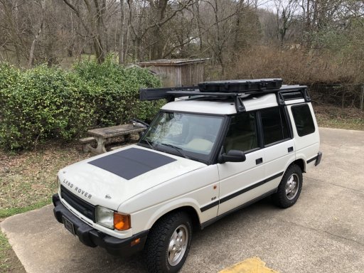

That awning is awesome! [emoji7]All the bits came in this week to get my roof rack and associated bits mounted on the disco. Much better than tripping over them in the garage. Very happy with the clearance with my storage boxes mounted. I’m only around 2.5” taller than before I removed the factory roof rails.
