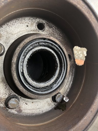

Between the loose caliper brackets and the loose rotor bolts, I made it a point to tear into the front hubs before my holiday travels and install the new rotors, seals, and bearings. Glad I did. I found the previous bearings had been overtightened and under lubricated. Looks like they were just beginning to fail.
MAJOR JUNK AT THIS POINT. I've thrown away better. How many miles do you think it had on it before you got it ? Is this the outer bearing ? Does the race show the same kind of damage ? I bet the rear bearings are just as bad. Good you are so thorough with this rig.

Found out through carfax the PO owned the truck for around 4 years and 16k miles total. The last “maintenance” he did before he parked it was the brakes, then it wouldn’t pass emissions so he couldn’t renew the tags and he stopped driving it. It had been sitting for over a year when I got it judging by the tag’s expiration date.
That’s the inner, but the outer was very similar. I didn’t look at the races other than to check the brand as I knocked them out, the races at least were timkin. I put a full matched set of new Timkin bearings and races in up front, with new rear seals. I’ll put a few hundred miles on them this weekend then pull them down and re-torque them after they are broken in. Then I’ll dig into the rear one weekend soon.

Well took the truck for a test drive this morning and it’s WORLDs better under braking. Seems the damaged rotor had tons of runout(I was intending to check it but I had lent out my dial gauge), often pushing the pads back causing more pedal movement than necessary.
One bolt holding the rotor to the assembly backed out, at speed at some point. The inertia broke the head off of the next bolt over, then it found anchor and began punching holes in the rotor until it escaped. Leaving part of the bolt imbedded in the assembly.
No more inspection holes!
