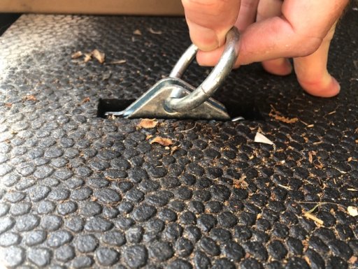

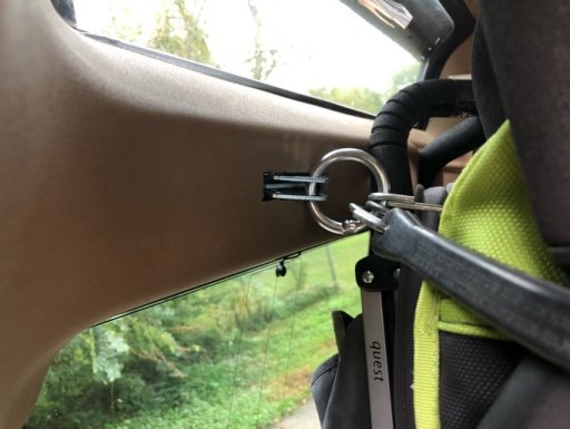

Continuing the rear cargo modifications, today I mounted the first upper cargo mount. For now they will hold strollers upright to free up room in the rear from day to day. I planned the locations out very carefully to support using them for future cargo shelf/cargo net options in the rear.

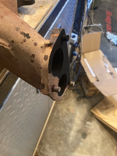

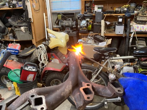

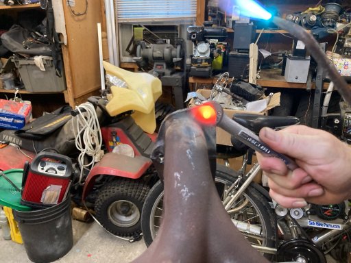

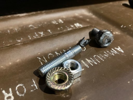

Well as usual small tasks tend to ballon, replacement of my catalyst after the attempted theft had left me with a minor exhaust leak. The next oil change I tried to “snug up” a loose collector bolt which of course turned it into a major exhaust leak. Rather than try an repair it under the truck I snatched off the manifold and went to work blowing out the broken studs with an acetylene torch so I could install new studs.
