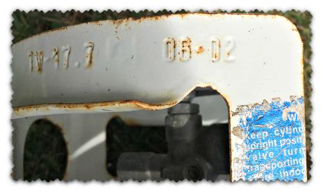

Did you know that Propane tanks expire?
Federal law requires tank re-certification after 12 years from the original manufacture date. A coded date is stamped into the carrying handle of the tank. The tank expires at the end of the month of the date stamped. Propane dealers are required by law to refuse to re-fill an expired tank.
Check out the date stamp in one of my propane tanks:
propane3
The first 2 digits represent the month. In this example 06 is June. The last 2 digits represent the year of manufacture. In this example 2002. This tank expires the end of April 2014. You can no longer refill this tank. Needs to be re-certified or replaced.

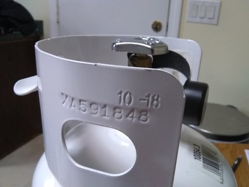

So I just received my Manchester 5# mini propane tank from Amazon......A day early I might add!
But it is already a year and 4 months into its expiration date. Ugh!

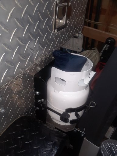

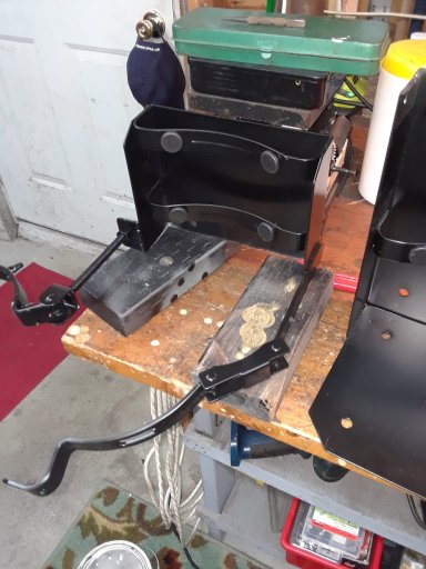

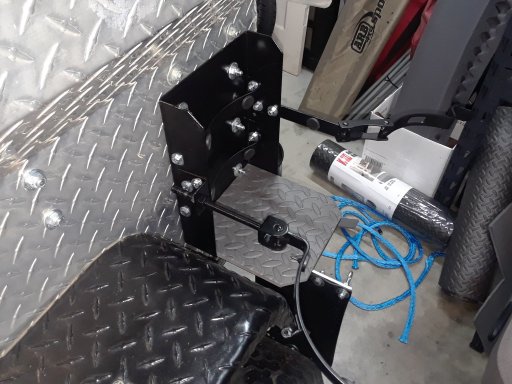

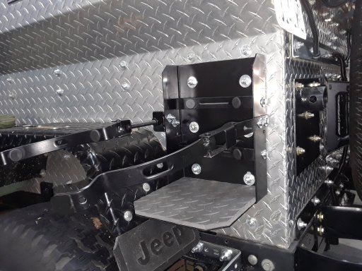

I bought a 5lb propane cylinder, and modified a fire extinguisher holder to make it work as a mount (the mount is larger than a 10lb CO2 cylinder mount). I cut the top off the mount, and drilled out the spot welds on the straps and inside attachment pieces and remounted these pieces back to the bottom part with 1/4" bolts. And then bolted it to the side of my trailer. Seems like the fire extinguisher mount was $50-something. I put a small piece of padding on the base of the mount for the cylinder to rest on. You can adjust the tension on the strap to make it nice and snug.
I've been looking at doing the same. I can't justify $120 to hold a bottle I bought for $39.

Here's a link reviewing the Overland propane tank mount, and further on I come in and describe how I modified the fire extinguisher mount to work for my 5lb propane cylinder. Also includes links for purchasing one of these fire extinguisher mounts (or you can take the model number and see if you can purchase one locally).
And it really was just a cut/drill/bolt together affair; no welding involved.
Since the tank is mounted on the outside of my trailer, I wanted to get something to cover the valve and such to keep it clean. What I discovered was a "faucet sock" is inexpensive (about $8.00) and does the trick. It was even the right color!
