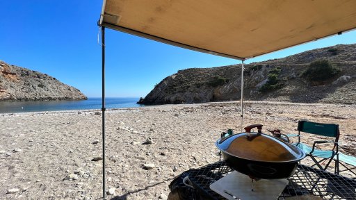

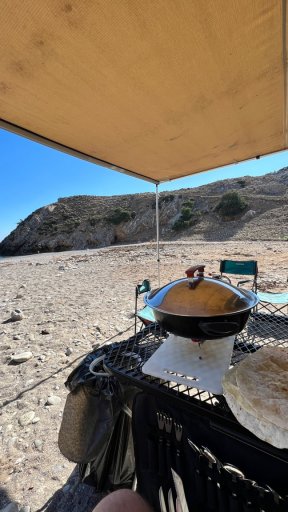

It’s my best friend in winter days. ThanksI like that little stove.Here is my setup. Modular depending on the event and the weather.

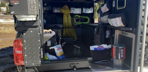

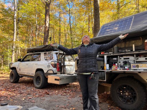

What is that solar setup you have there? And where are your panels?Love all the great ideas here...really amazing!
Definitely has me thinking I need to make some improvements. Most of our overlanding is done at 5 - 6 month intervals...and some camps can last up to a month. I think the most important item is replenishing the kitchen...sometimes not an easy task.

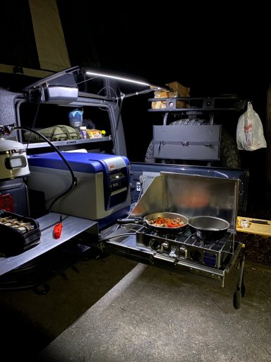

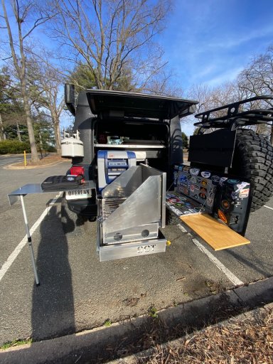

Digging your pair of sous chefs.I got around to building my Snow Peak kitchen drawer a couple of years ago. Here's how it turned out.View attachment 250471
The above is a more recent picture after I fitted 1/2 of a Partner Steel 9-inch kit into the 6-unit IGT. Using the house propane tank up top is much easier in the shoulder seasons because butane will barely boil water on a 28 degree morning.
During the hotter months I drop in Snow Peak Baja burners that use butane.
I like how it turned out. It's a set of 60 inch, 500 lbs.-rated drawer slides that house a 6-unit Snow Peak IGT table. Had to have the windscreen made by a local sheet metal shop AND...had to sacrifice my passenger seat to make room for it.
Nothing easier though. Park the Jeep, pull out the drawer, make lunch, roll in the drawer, drive on!
Edit: I just realized that the seasons in these pictures are backward. They were from year one before I figured out that I needed different stoves during difference seasons.
hi...been off comms...just saw this...solar system is something I threw together myself...have 2 x 50w panels permanently on the roof fwd of the RTT...also have 2 x 100w panels I store above the roll bars inside...gives us plenty of powerWhat is that solar setup you have there? And where are your panels?
Also, nice kitchen setup. I especially like your pantry in that second photo. (-;
