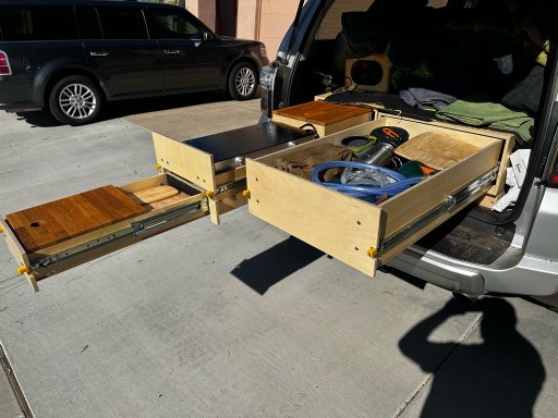

My buddy and I designed a custom drawer system for the back of my 4Runner. It turned out pretty cool, all Baltic birch with some heavy duty drawer slides.
love it!
looks very well built and definitely loving the drawer in a drawer...excellent use of space

love it!
Thanks so much! It's been really useful, I've been enjoying using it the last few trips. Really nice to have all of my stuff in one place.
