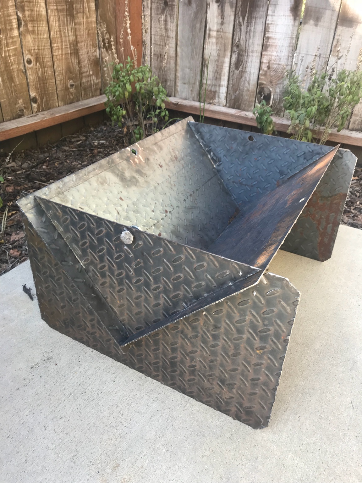

I like the idea of the solo stove bonfire but the size turns me away. I wish it would split into 1/2's or 1/4's so that you could slip the pieces apart/together for storage. I don't see a reason why this would not be feasible. I currently don't have the tooling to make one but I have made small hobo stoves out of tin cans with holes in the side that work very well, seems like scaling it up would be simple. BTW if you steal this idea please send me one!
000
1,423
No

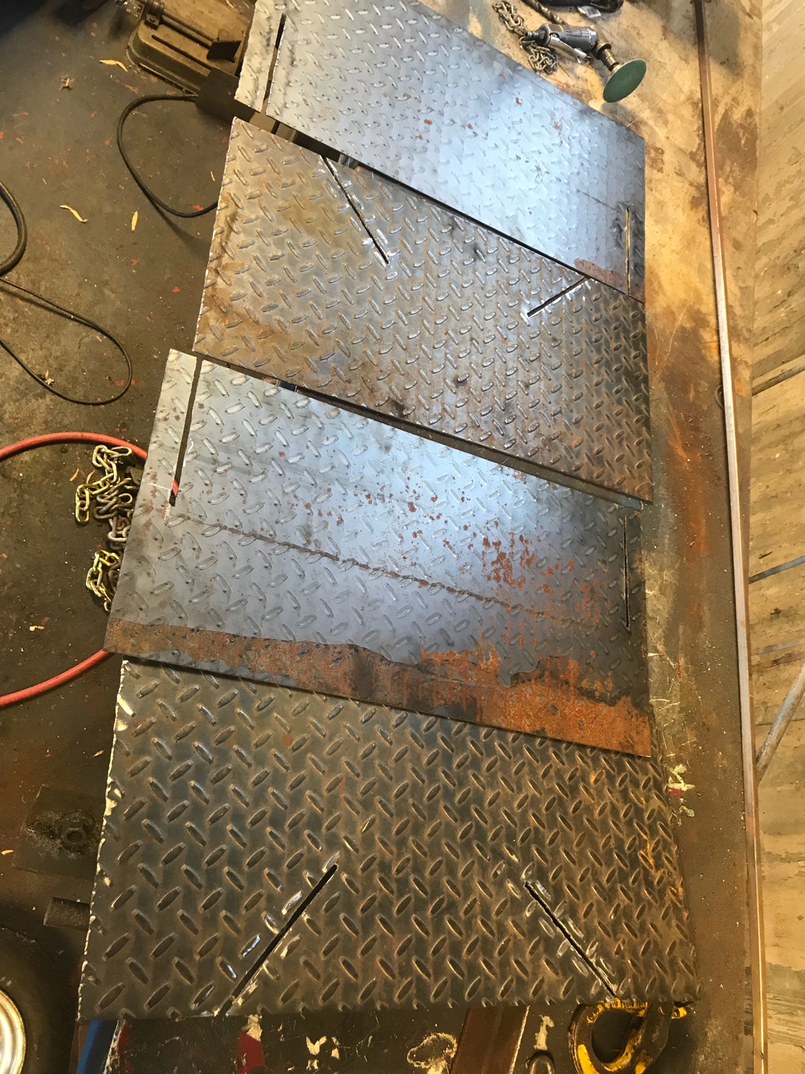

3923
I made this from some scrap 1/8” diamond plate I had laying around. It slips together and supports itself with no hardware and no welding required. I used a plasma cutter, but it could easily be made with a $10 harbor freight grinder with a cutting wheel. It all lays flat and I drilled a hole in the top of each piece and found a large bolt and nut to keep it all together when stored. I’m going to cut a piece of expanded steel to lay in the bottom to keep the coals directly off of the plate to reduce warping. I haven’t tried it yet, but it looks like it’ll do the job and it was free...
