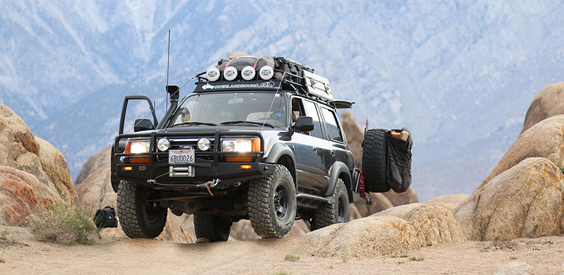

cool. I think I'll call them for my rig too. How much more extra weight will that full tank add to your GVW? Will we see a V8 swap in the future?
Yeah that’s going to add some weight! I think most of the time I’ll keep 5-10 gallons in it, which I hear is not noticeable. I think my next engine will be Diesel!
