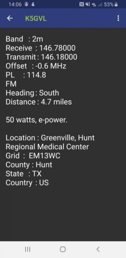

There's a GMRS repeater in Greenville thats pretty active. Should have no problem hitting it from Wolfe City. I hit it from Rockwall pretty regular.
Theres a few HAM repeaters that are fairly active. One ontop of the hospital (primary skywarn unit) and two (a paired VHF and UHF repeater that are secondary skywarn units) at Majors Field. Any of those you should have no problem hitting.
If youre monitoring simplex its pretty dead haha.
Youre not going to hear much off roader traffic. Theres no trails around us and Most are going to be using theirs for trail comms not daily talking.
The Jeep club in Hunt County is mostly running CBs, ive had a little luck converting a few to GMRS but even the ones with radios installed (CB or otherwise) never turn them on.
If im in my Jeep its am automatic reflex at this point to power up my radio. I monitor 2m call and the UHF repeater at Majors Field.

Try these. You're going to hear a lot more constant traffic on fire/police for obvious reasons. Im not typically making calls in the blind when traveling. I may not even use the radio if im on my own and just passively monitor the call frequencies. Even still these are still mostly line of sight limited so unless youre pretty close youll never hear someoen on a trail a ridgeline over when in Arkansas. Or they may be on some race radio illegally using business band frequencies that you arent monitoring. There's just a ton of variables and unless both parties are actively trying at the the same time on the same.frequencies more likely than not you wont reach anyone. This is why comms plans are so important.
GMRS repeater Gville
462.550 output
467.550 input
CTCSS 141.4 on both xmit and recieve
Owner's name Charles. Older fella but pretty laid back. Cant rember his GMRS call. Semi active. Usually not an issue getting contacts on it. Im typically monitoring if im mobile.
Hunt Regional Medical Center. Skywarn primary. On and off traffic throughout the day. Again not typically an issue getting contacts on this unit. Really active during bad weather due to Skywarn activity.

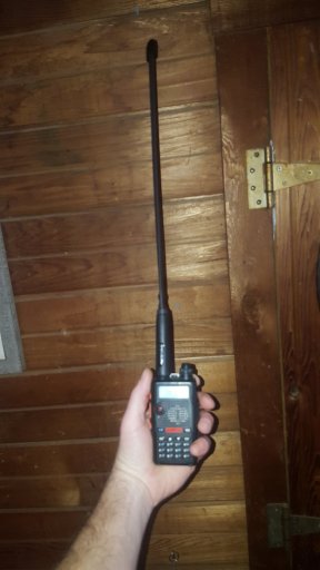

My ham is baofeng uv-5r ex with 18 inch abbree antenna im on top of a hill with nearly no trees to the south.
My gmrs frs is crappy uniden handhelds.
My cb is a uniden bearcat pro505xl with a tram center load antenna.1571860632897922537410.jpg

Are those Uniden even capable of repeater ops?
You're certainly going to be range limited with HTs and those antennas. Cant say for sure on CB without knowing antena location and what youre seeing for SWR readings.
You may not have the oomph to get into the repeaters with the HT but if you're outside i dont see why you wouldnt be able to at least hear them. The HAM repeater on the hospital transmitts its callsign and time at the top of every hour so you should be able to check that way.
That Abree antenna is about the right length to be half wave on UHF should get great transmit and recieve on it for what it is.
Do you run an external antenna for the HT when you're mobile? I wouldn't say youve wasted your time or money on comms but you're equipment may be hamstringing you a bit.
