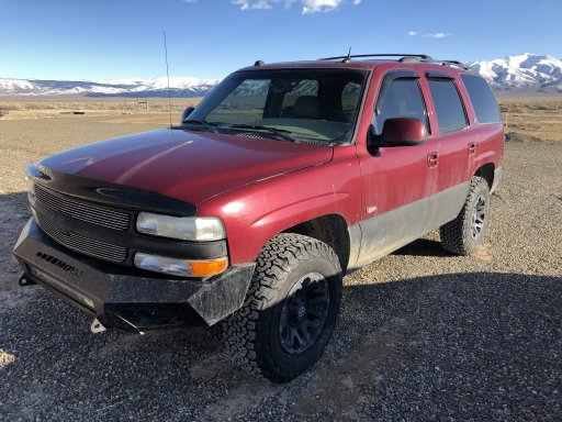

The road noise doesn’t seem to exist on my Tahoe. I can’t say I’ve ever heard them. They handle awesome. Just seem to grip the road and go.

Road noise is not as bad as the set of mud tires had on before. Over all I am very pleased with the handling and feel they have on the road dry and wet/ice/snow. Have not had a chance to see how well they will perform on two track and muddy two track. Summer is coming!!

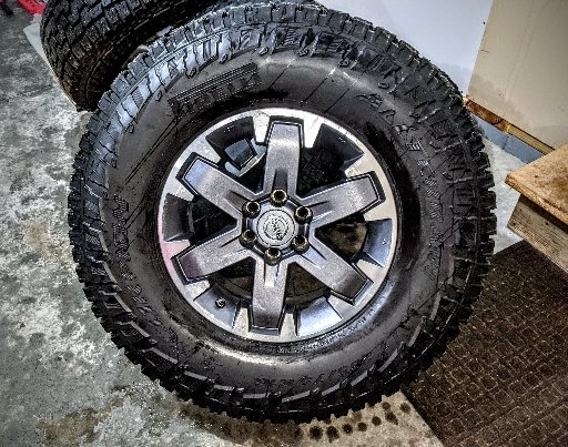

Currently running Achilles Desert Hawk ATs. They were great in the snow we got recently. They don't look the coolest but they seem to get the job done for daily driving. For trips away from home where I'm going to be off pavement a bunch I'll swap over to my SE wheels that have a set of Achilles Desert Hawk MTs on them. They're a little noisy but ride decently and seem to hook up well.
