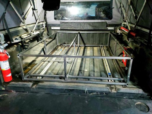

Loved watching Michael and Parnell build the drawer system on youtube, and had to build my own version. My old setup was made from a combination of 2x12's, 3/4" plywood, it was HEAVY. I have a lot of work to do yet but this thing is a feather compared to the old setup so far.
Behind the fridge will be my 2 125ah batteries and solar controller. The drawer will run on 54" full extension sides with a stove on another set of full extension 24" slides that will come out the front of the drawer. Can't wait to get more work done on this, and thanks Michael and Parnell for the idea!

More progress on the build! Got everything welded, painted, drawer slides installed, and side panels cut. Need to buy more hardware, some stain, more wood, etc. Not sure what I want to do for the top panel, I wanted a piece of 3/8" baltic birch but I'm having a hard time finding it (Covid...)

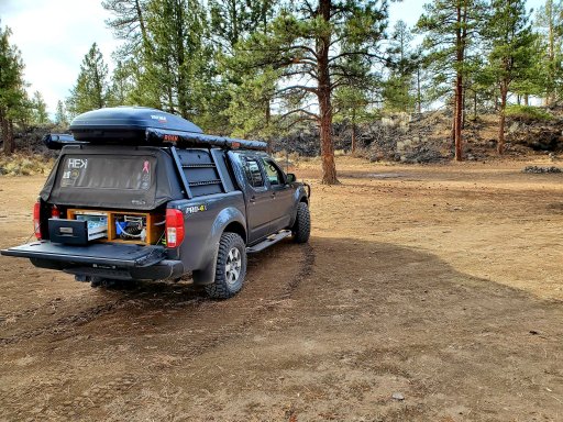

Almost done! Got a few more things to make, like a door to cover up the drawers, stewing on a fold up table idea, and still plenty of wiring. I did a lot better mounting the little drawer for the stove, it's actually straight whereas the big one is crooked and not the right size. Definitely will be building a new big drawer next winter. Also need to brainstorm organizing everything so it doesn't get thrown everywhere on the trail.
