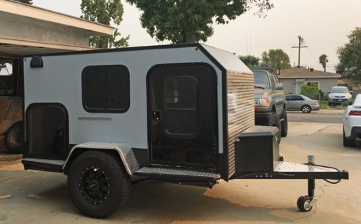

Well, I had planned on finishing the outside this weekend but, my dumb ass didn't order enough angle to do the trim. Sigh.
Next week i'll pick up two more pieces and finish it. What I was short would have done the driver side rear vertical and the rear center. The rear compartment doors have to go on after the trim.
I don't like my steps. I left the diamond plate shiny and I think it clashes with the black . I haven't mounted them yet and don't really want to paint them black. I left them shiny so they wouldn't be hot. Not sure what i'm going to do there.
What I completed this weekend.
1.paint. I wanted something more "blue" what I got was a kind of blue/grey and it ended up more grey than blue.
2. mount windows and doors
3.install most of the aluminum trim
List of things to do
1. buy two more angle, paint them and install.
2. mount rear compartment doors.
3. mount solar panel. I cant mount until both roof/side trims are on.
4. wire front box
5. do spring over and get my height back
6. Buy black screws for doors
7. uhhh. things i forgot?
Im still trying to figure out my bed/couch. I may get two narrow tri fold beds. That way I could have a couch and bed open at the same time. If I needed more room, i could fold the second down. I want to complete the box first though.
Here's my latest pictures.
Here's what its going to look like on both sides. The bar under the window is a mount for a removable table. The rear vent is for the fridge. I have an intake low in the back. There is a large gap next to the rear shelving. Hopefully the heat from the fridge will have a chimney effect and go out the upper vent. I have a power wire there in case i need to add in a thermal switch and fan to help it.
When I do the spring over, it will get me 4 inch's more height and that will put my clearance back to where I want it.
Just doesn't look right without the trim done. I'm also considering a bold stripe, diagonal from the fender to the rear upper corner. Something to break up the rear, maybe something in blue.
That's all for now.

Well, its done except for some finish work and figuring out my couch/bed. I have all the rivnuts installed in the roof for my roof rack. I'm going with a low profile T-Slot aluminum. That will be in a few months.
Here's some pictures. Oh....I still need to wash it.

Decided to update this.
1. the test "drive" was good, the test "stop" failed. The brakes were barely engaging, even with the override lever pulled. Long story short, the new brakes were actually used damaged brakes. I don't know why I didn't notice this in the beginning when I assembled them. The trailer shop is making good and my new ones should be here by tomorrow.
2. Note to self......test water system before final assembly. Fortunately, I made everything accessible. I just had to unbolt a bunch of panels. I used "push in" water fittings. I use these on all of my builds and I have never had one leak let alone all of them leak. The difference was, these were bought from Home Depo and not my normal place. Terrible quality. I replaced them all with barbed and called it good. no leaks.
That's it for the failures.
I mounted my porch lights. They are solar, led, motion sensing. I saw these on a rig back in December and I liked the way it worked out. I used 2 on the side with my kitchen and one on the other side. They are set up so I can remove them easily and I hope they work well.
My bed/couch foam is suppose to be here soon that will finish the interior and I need to finish my propane tank mount. Unless something else happens, its done and ready for camping. I'll take some more pictures this weekend.
