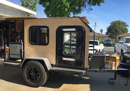

Got some more work done today but only got two pictures.

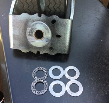

In the beginning of this build, I wanted to try out one of the Ark XO trailer jack's. The jack on my M-100 is a standard one wheel jack. Off road it was a struggle to move it around on the jack. I had read alot about the Ark jack and ordered one for this build. While I was shopping , I saw one that looks just like it for cheaper. I've been burned by copies and didn't go that route.
Today I finished modding my Ark jack. I'm not too happy with it overall and needed to make it work properly. The sloppiness is about the same as cheaper jacks and it was too short. Those are easily dealt with or ignored. My big issue was how poorly the wheel turned. I had already extended it 4 inch's and today fixed its poor turning. If I knew I was going to have to mod it, I would have gotten the cheap one.
I drilled out the wheel hub and installed a bronze bushing. Removed the plastic washer and installed thrust bearings. The original design used a plastic (teflon?) washer in between the jack and wheel hub. It didn't like changing directions and was a bit sloppy. The thrust bearings can handle several thousand pounds but will have to be cleaned and re-greased occasionally. I can do this when I re-grease the hubs each year. Now it turns very easy.

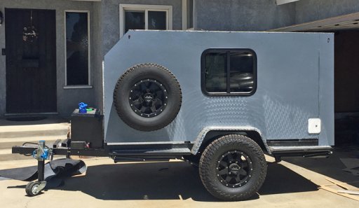

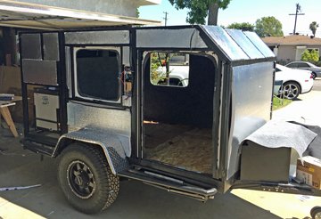

Got driver and passenger side's, inside and outside cut out. I only had time to get the door and one window installed. These are in temporarily and will be removed so I can add in some bracing and prime the wood. I didn't get a pic of the other side when I completed it, just this side.
Looking at this picture, you can see that my fender is almost hitting my tire. The springs should have been more than enough. I believe the company that sold these over rated them. This is something I will deal with after i'm done.

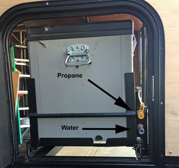

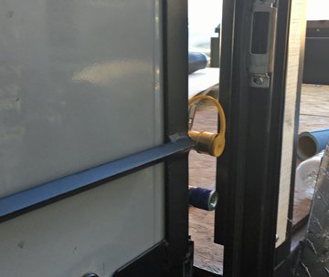

Here is how I set up my water filter and my quick disconnects for propane and water.

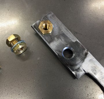

One thing that always bugged me was how most people mount quick disconnects for their an board air systems. They make some very creative mounts to hold the fittings. I don't like complicated and what I do is use a brass pass through. It is simple and strong. You drill a hole and mount. What could be easier.
Here's how I mounted my fittings for my water and propane.
Here are the pass through's and mounting bracket. The inside hole is 3/8 thread. Outside is 5/8
View attachment 163699View attachment 163700

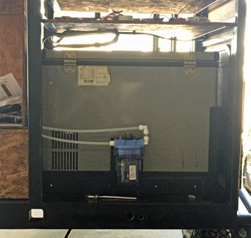

When the door is shut, I have 1/2" clearance. They do not slide out with the fridge.
The water filter will be behind my vent. Remove vent panel and access filter. I went with the 4" housing.

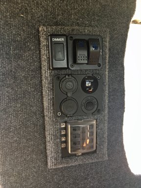

I got as much done this weekend as possible. The heat was killing me.

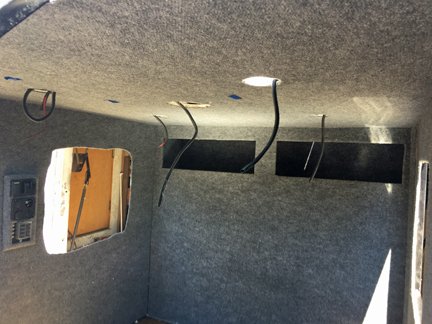

I changed my mind again on the interior. Instead of painting the inside i decided on outdoor carpet. I had bought a good quality paint and didn't waste it. I painted front and back of all the interior panels before carpeting them.
What I accomplished was, install all but the front interior panels, installed my insulation, finished my water system, got most of my propane line run and mounted my switch/fuseblock mount.
View attachment 164411 View attachment 164412
Here i'm gluing the carpet to the headliner and the next pic is the interior so far. My rear cabinets need to have doors made. I will probably just use nets to cover the openings. In the left corner you can see my switch panel. I wanted to be able to just reach in and hit the light switch without fumbling. Hanging down are my overhead light wiring and fan wiring.

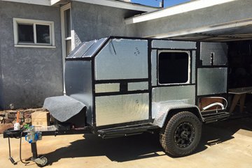

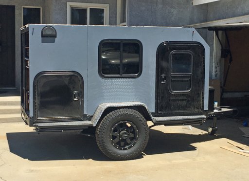

This weekend I primered the sides, bonded all but the rear panels and test fit my doors and windows for the final time.
The check list is slowly getting smaller.
Major items left and do are, buy diamond plate for the front and sides. The sides and rear will have a 10 inch strip along the bottom and the front will come up half way. Need to buy the aluminum angle to run along the edges, fill the small holes and seams then paint.
Plus a never ending list of small things.
I think i'm going to fix my suspension issue with a spring over. My shackle is in a good spot and ill gain 4-5 inch. That will put me where i wanted to be anyway.
I got two pictures of the test fitting of the driver and passenger sides. Unfortunately, everything comes off for final sealing and paint.
