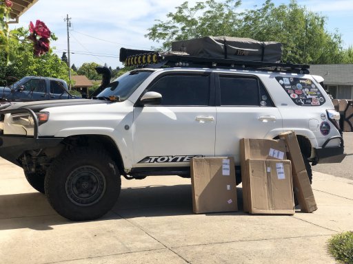

How long did it take your mechanic to do both front and rear axles ?
About a week, would have been done sooner but Revolution sent the wrong gears so they had to send them out again. Dan over at Taylor Axelworks was awesome...

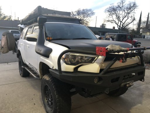

Well here is the finished product. Did the install of my Safari snorkel. The funny part is that I was really apprehensive about this install. I must have watched six install You Tube video's on this process. In everyone of them the people talked about how hard, time consuming and frustrating the install had been. Also everyone of them talked about the inner fender liner being impossible to remove.
After watching each of the video I noticed that all of the people were trying to remove the liner grommets intact. When they couldn't get them out they merely fought with the liner, until the install was finished.
Next, I researched the fender liner removal using the 4Runner repair manual and found out that the grommets are not re-usable and are meant to be replaced. The manual stated there were 6 bolts and 14 grommets. I went to Auburn Toyota and bought 14 grommets for $14.00, was the best money I've spent. This one decision made the entire install super simple.

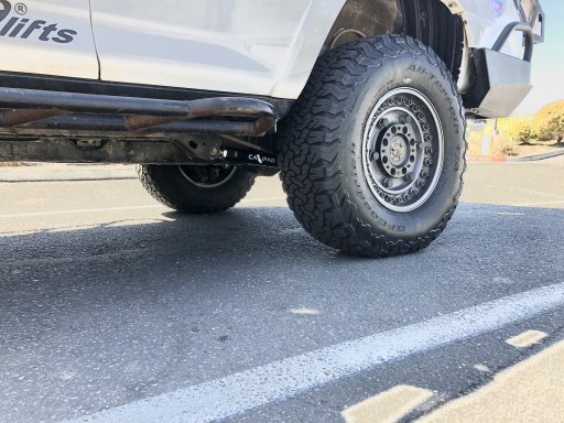

Had to go out and do some essential vehicle maintenance, went California Fabrication in Carmichael, Ca and got my baby new shoes.... The rubber was toast, but now she's on 35's! If you live in the Sacramento Area, or within driving distance go by and check Chance and crew out they do awesome work.IMG_0224.jpgIMG_0226.jpgIMG_0229.jpg

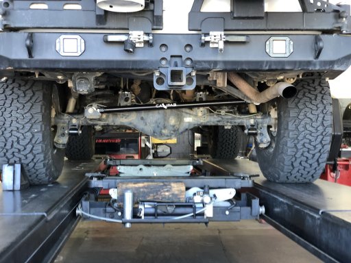

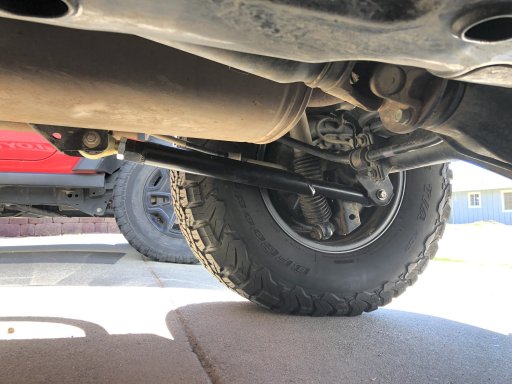

Newest addition to my girl, California Fabrication rear upper, lower adjustable control arms and adjustable Pan Hard bar.. I love these things, super stout and no worries about bending them...

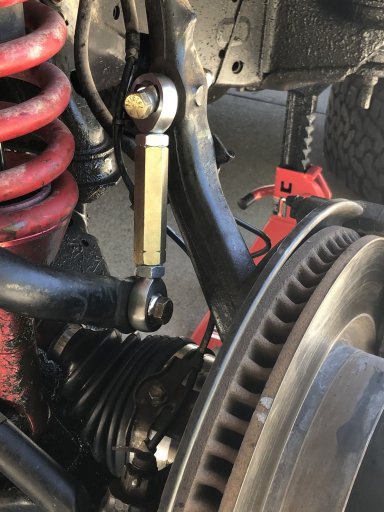

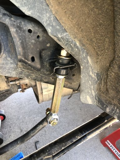

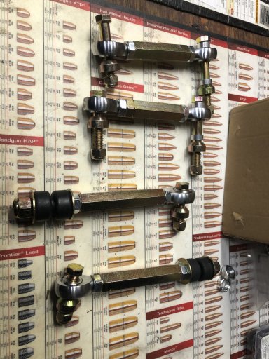

Since I ended up folding the stock Toyota sway bar end links here is my solution to that problem... New heavy duty, adjustable Overland Custom Design sway bar end links. Mike (the Owner) rates them at 150,000 PSI and so far I love them....
BC79CFE1-6312-4F0E-9AB3-2CC55AFF77FF.jpeg6A91B1A8-67E5-4A0F-B4CE-2D8F54A5A75D.jpeg37B92617-D374-42F9-8A7E-8FF025992120.jpeg7787DBF8-5284-407F-8A8D-F40BB827B21A.jpegD4A53AFC-4C4E-4E57-8FD3-CF6A8358C7C2.jpeg62BFCDA2-AA31-4C1D-B8C2-DCC98C07AB1A.jpeg
