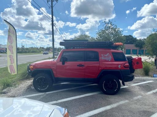

So in August I bought a stock 1 owner, 55k miles, clean car fax Toyota FJ Cruiser. Went all out spent a bunch of money on an overland build. New bumpers, winch, tent, roof rack, custom cabinets, dual battery, fridge, skid plates, custom cabinets etc. Truck is completely done. I killed myself in terms of gas mileage. I will be lucky to get 220 miles to tank.
How bad did your build set you back in MPG? I know that with what we are doing that isnt a priority, but I dont want to have to worry about my fuel constantly

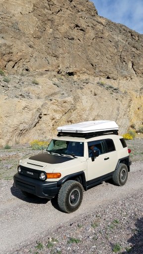

Yeah, that's why I intentionally left off the aftermarket bumpers. I put on a 3" OME lift, Aluminum skids and a RTT with an Aluminum Front Runner roof rack. I also run the stock Trail Teams 265/75R16 tires. I managed 300 miles on a tank of gas on a recent Fly Fishing trip.
Weight kills gas mileage, regardless of the "brand" of truck, diesel powered trucks are typically much better in this regard, and Yes, Toyota trucks have never been known for great gas mileage.
The 19 gallon tank is the killer. The FJ's sold overseas have an auxiliary gas tank option. The US CAFE standards played into a lot of this., resulting in "one" of the reasons the FJC was discontinued in the USA.
With that said, I'll never sell my FJC.
