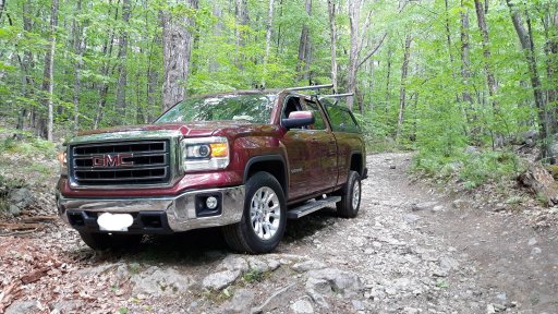

Good Lord, that's some scary mileage if you are talking highway. I checked my v8 2014 GMC Sierra z71 Double Cab against the much smaller, by Chevy Colorado and found that my truck is rated slightly better fuel mileage -probably due to the Active Fuel Management/ cylinder deactivation that cuts it down to 4 cylinders at highway speeds, not under load.
On the highway I can get 450 to a 25 gallon tank fairly easily. 500 if I lightfoot it. I'm talking about me, the lady, my dog and all our luggage and gear in the back under the Leer cap. I've seen averages over a 25 mile stretch where I get 23 mpg if I'm gentle. Right now I have highway tires on it, though. If I switch to some mile AT's, I imagine I will lose anothe MPG?
Yes it's a large truck at 19 feet. Parking can be tricky in the city. I try to stay away from the city anyway. But aside from large tires and added weight, anything hanging on the outside of the vehicle is going to dock your fuel economy on the highway.
As a result, I opted for a Leer 180 truck bed cap. Nice and smooth on top, no need for a RTT. Everythin, and I mean everything is contained in the bed, under the cap. Sure its 150 to 180 pounds, but also provides a bit of aerodynamic savings, so it's a wash. The spare is under the bed of the truck, so no disruption to the backdraft as if it were hanging off the tailgate. Keep it as stock as possible outside, and you will save a lot on fuel economy.
Having said that, I did add Trac Rack truck Cap roof rack system (now owned by thule) on top of the Leer, but I really only use that when I want to bring my kayaks. When empty, the rack has virtually no effect on fuel economy or noise.
I did level out the front with Bilstein 5100 series shocks, and before that, I removed that chin strap of a front air dam from the bottom of the front bumper. That combination was probably what cost me the most, and that only clocks in at robbing me of maybe a whole mile per gallon.
I cant complain when I'm in a slightly raised, 19 foot truck with a bed cap and roof rack, and I still get as good or better fuel economy than a Toyota Tacoma, Jeep Wrangler, Jeep Grand Cherokee, or Chevy Colorado.
