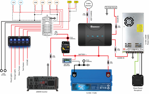

With all of the rain we've gotten here in Arizona this year (NOT complaining) it gave me plenty of opportunities to find leaks in my side mounted tool boxes. I finally tracked down the last few areas to seal and can begin mounting all of the electrical hardware around the rig. Working through a preliminary electrical schematic, if anyone has any feedback I'm not sure if I'm being too fuse happy or if this is the right way to make sure everything is protected.
I also have a Sailrite LSZ-1 Sewing machine on the way so I can finally start fabricating the fold out shower enclosure. Which means after the electrical subsystem is finished it's time to mount the water tank, pumps, filters, and figure out the plumbing!
I love me an electrical diagram!
A few things I've noticed:
The renogy charger isn't designed to be used in this fashion. While you could theoretically set it up this way, you'll probably have to combine you shore charger and vehicle input, as that model only has a solar and vehicle side input. I'd honestly recommend getting something like a noco battery charger/maintainer, and just wiring that in.
I'd also recommend using a relay box instead of wiring your switches inline. There are a few reasons for this. First of all, you only need to run a single power and ground wire to the switches, then return wires to your relay box. This also puts less strain on the switches, and let's the relays switch the power to your accessory. Water pumps can draw up to 10A (most are in the 5A range), and depending on which heater you're using, those can pull ALOT of juice, and potentially burn your switches out faster. A relay in a relay box is MUCH faster to switch out.
Other than that, looks like a pretty solid setup.
Reactions: Phillysteak

@reaver Very good points on the Relays and the Noco. I was originally going to wire the power supply and the vehicle-in port together but the Noco battery charger is reasonably priced, so it will be replacing the AC-DC power supply altogether.

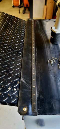

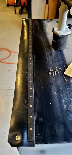

Before the electrical subsystem gets installed, it is time to seal the enclosures once and for all. I stripped out all of the factory-installed foam seals and re-applied seals with good quality versions. I also added a rubber "roof" flap to seal up the main source for water ingress. The tool boxes have weathered two storms since perfectly, so I feel comfortable adding the electrical system finally.
P.s. - A pneumatic rivet gun is worth every penny
