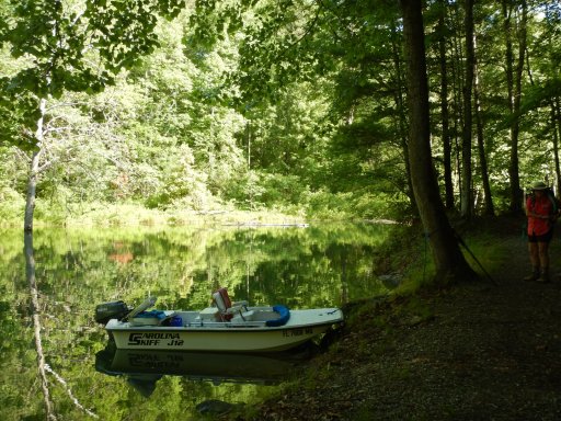

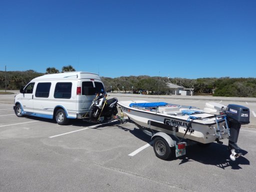

We have a 12’ Carolina Skiff / w 25hp Yamaha 2 stroke, I usually carry 2- 6 gal tanks which give me a range of around 100-110 miles. Its rigged with a Raymarine Color Sonar, Standard Horizon VHF radio and Garmin GPS. It has been thru the Everglades on the Wilderness Waterway. Lake Fontana in N.C exploring the lake and hiking into the Smoky Mountains N.P. traveling up Hazel and Eagle Creeks. Lake Watauga in Tenn., Lake Jocassee in S.C, this is where they filmed Deliverance. All thru the Keys and backwaters. Almost every lake, inlet and river in Florida. Even on the reefline in the Keys thats 5 miles out in the ocean. 4k miles logged on Gps. Never a mishap or breakdown, its been a great little boat that can get us anywhere and back to camp.

Lots of factors, RPM, wind, current,tides, load, even prop pitch,draft, hull type. You shoud be good but I would take extra. I would fill your tank with a premeasured amount, run the boat in normal conditions, measure your mileage and do the math, then I would factor in + or - 5 miles.When I plan to go into territory where rescue would take more time, like the Glades, I always go by the rule of thirds with the fuel. 1/3 out, 1/3 back, 1/3 backup.Safety gear and a FAK, extra prop, tool kit. Always extra food and water. The Radio has DSC, distress hailing and location feature, and I have a 2m handheld in each backpack. Deep trips, I will leave a float plan in the truck.

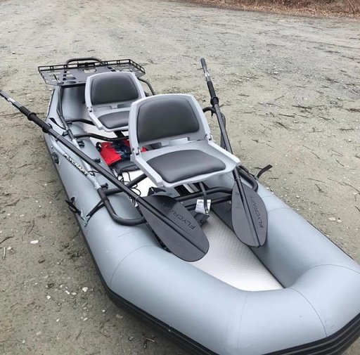

Out here in the Pacific Northwest we live by our Aluminum sleds and drift boats, but with most of my overlanding I find myself off grid, sometimes by several 10's of miles, so dragging a drifter or sled just isn't feasible. Being primarily a fly fisher these days, I set out to find a solid inflatable choice to accompany me on my overland excursions. After much research and a few test floats, I settled on an inflatable called the Fly Craft. It's 12' long and 48" wide, handles up to class 3 water and is an extremely low draft boat. Out here in the summers, rivers can get pretty low and this thing will float on 3-4" of water, so all of the headwaters of say the Clackamas, Rogue, Deschutes, Ollalie are perfect summer waters to tackle in this boat. I can portage this boat over trees and root wads super easy too which is often necessary out here. While not a cheap option because of its solid durability and features, it does only weigh about 100lbs and fully deflated, will pack into a standard Plano sportsmans' box (minus the seats). It will re-inflate the four seperate compartments within about 8 minutes all in using my ARB pump. This is an awesome fly fishing platform as well as any gear fishing you might want to do. What I love about it is that I can keep it inflated and strap it down to my roof rack while out n about. So if I find a particular "fishy" looking spot I can just rope it down to the water and hop in, row down river, try to land something, then go get my rig and rope it back up. At a 100lbs, I can manage it all myself.
blackntan
2,271
Uk. 53.4084 N 2 .9916W.
Black
Tan
2385
Boys brigade
Looks a cracking bit of kit what is it’s weight

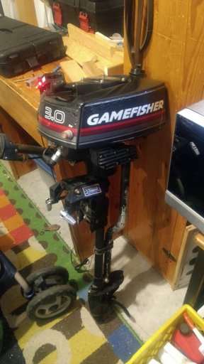

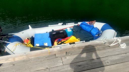

Realized I never updated this thread. I ended up buying an old Sears Gamefisher 3Hp air cooled outboard for my Intex Mariner 3, and it's perfect.
It looks a little rough, it's loud and rumbles around a bit, but I'll tell ya, she starts right up and seems to run with no hiccups so far. The motor only weighs 25lbs or so, and it's the perfect length of shaft for my boat (with a minor modification to the motor mount that raises it up about 1 inch). I can actually carry the motor, all parts of the boat including the mount, and a 20L jerry can of fuel all at once (bloody heavy, but I can lol)
I recently loaded up my eldest daughter and a bunch of gear, 4x4'd up Harrison Lake and launched to cross over to Long Island. The boat ran without a hitch and even handled some rough water at the outset.
