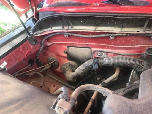

You need to locate the coolant hose that comes out of the car’s heater core. In the FJ that is the lower of the two hoses you see on the firewall:

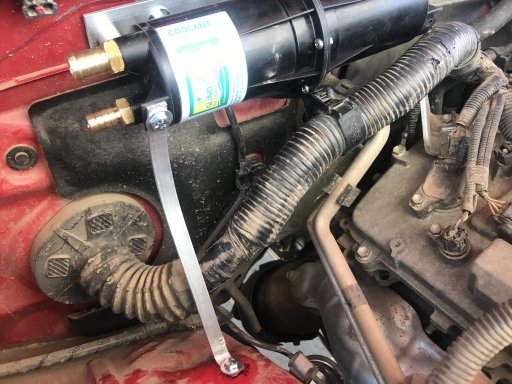

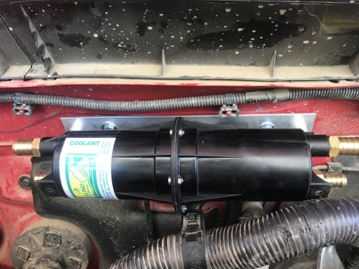

Where you install the heat exchanger will vary for each vehicle. You want to find a location in which it’s safe, and minimizes the length and bends of the hoses. In the FJ I mounted it to the firewall using two rivnuts.
Because this car is going off-road I wanted to strengthen the heat exchanger mount, so I added a bracket for support just in case. It probably wasn’t necessary, but just to be sure.

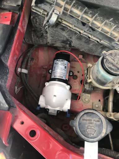

I put the water pump in an empty space in front of the engine bay. Again, your vehicle may be different. The pump can be mounted vertically or horizontally.

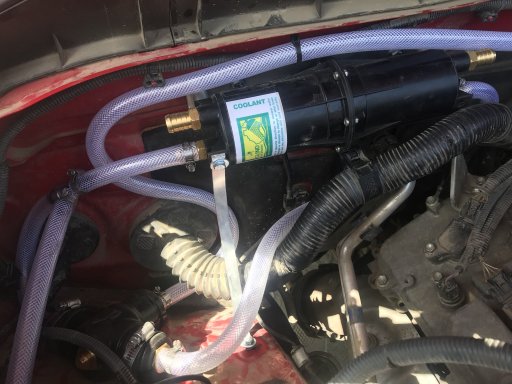

In essence, the way this works is:
1. Cold water is sucked in by the pump. The source can be a jerry can, a permanent on-board water tank, or even a river or lake if you carry a long hose. For the sake of simplicity I chose to use a jerry can. You can install the inlet anywhere in the vehicle. I am going straight into the pump.
2. The pump pushes the cold water into both the cold water inlet in the mixer valve and the cold water inlet of the heat exchanger. You use a T connector to split that source into two. Pay attention when you install the mixer valve to see which of the two inlets is the cold water inlet, and which is the hot. In the heat exchanger photo earlier, the cold water inlet of the heat exchanger is the bottom one, in either end. It doesn’t matter which end you call “in” as long as you make the inlet above for coolant fluid be the opposite, I.e. “out”. This is because the two liquids must flow in opposite directions inside the heat exchanger.
3. Next, connect the heat exchanger’s fresh water outlet (hot) to the mixer valve’s hot water inlet. Notice how I routed this hose to avoid being above the engine block and also to make it look neater.
4. The last fresh water hose is the lukewarm (mixed) water coming out of the mixer valve (the bottom outlet) and that hose ends in whatever termination you want to connect the shower head to. I routed the hose out of the engine bay all the way below the driver side by the frame rail and terminated the hose with a quick connector. The hose is held in place with zip ties and some hose brackets along its path.
5. The other part of the plumbing is for radiator hot coolant. You want to tap into the hose that comes out of the heater core. Depending on how the hoses go in your vehicle and where you installed the heat exchanger you may want to disconnect the coolant hose from where it goes in back into the engine block. In my case it was easier to cut it close to the heat exchanger’s hot coolant input, and splice another hose from there (or directly if it’s long enough) into the heat exchanger’s hot coolant inlet. In the picture you’ll notice the splice on the hose above and how it goes into the heat exchanger.
6. Lastly, you need to go back out of the heat exchanger into the other piece of hose that goes back into the engine. The kit came with hoses with tight bends, so it was easy to connect it to the outlet and splice it in to the engine’s hose.
