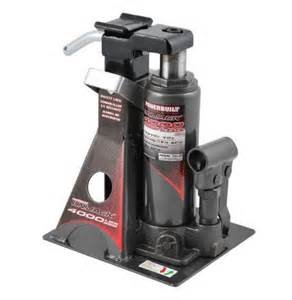

When I'm on the trail alone, I carried jack stands, in the past. Now I carry this two in one devices: Powerbuilt Unijack in the 6K veriety. Depending on terrain, I often will leave the Hi-Lift home now. The two Unijacks I carry, are lighter then the Hi-Lift. Probably much safer in many situations. I bolt them down in the vehicle, so they are easy to get to, but won't fly around in an accident.
I like! would be nice to have when working under the vehicle with jacks and safety stand all in one nice find...

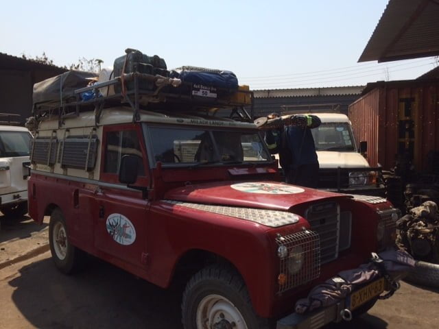

Although you all have good alternatives for the Hi-Lift jack, I consider it a very worthy tool to take on an longer overland trip.

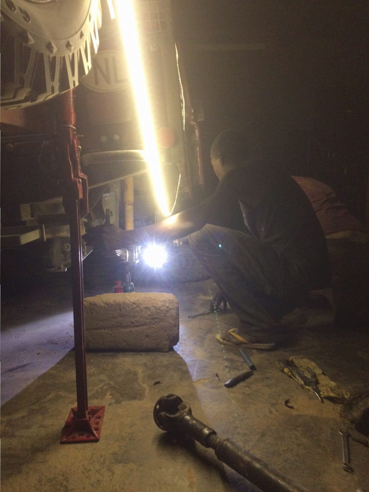

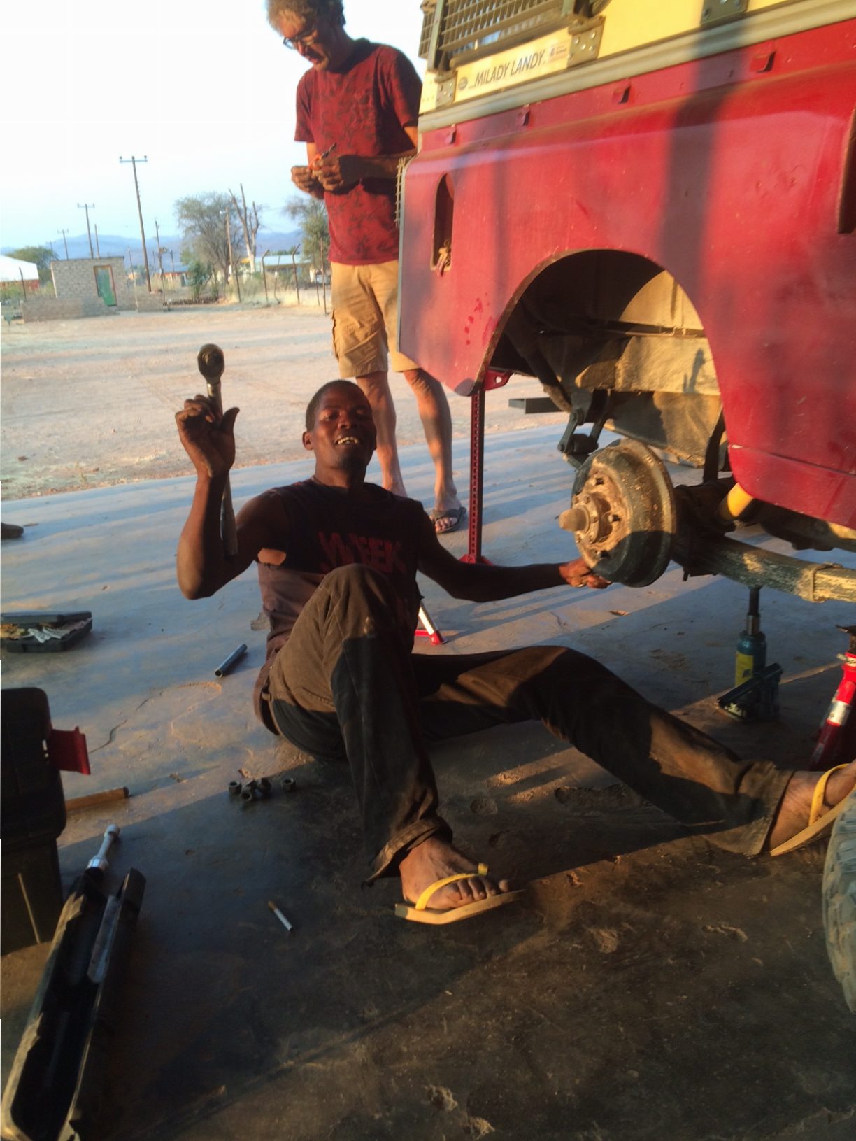

During our travels with our Series 3 Land Rover, Milady Landy, I used the jack many times to jack up the vehicle and do the uncountable repairs that were needed to do our 16.000 miles on African roads. Yes you need to be very cautious with it, so I also carried and used my bottle jack and two axle stands, but it is a fantastic tool.
Apart from jacking up for repairs I also used it to jack up the car one end when I got stuck and the left rear and right front wheel started to spin.

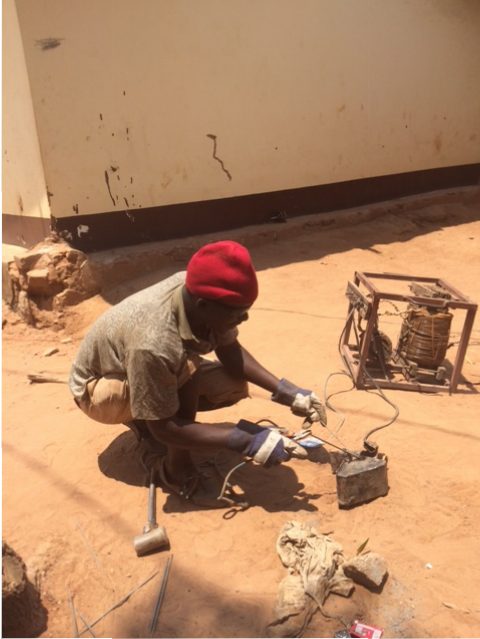

The other occasion was to repair the broken chassis in a tiny village in Tanzania where tools were limited to my tool box and the welding station of the local blacksmith. Here we used the jack to push the chassis back together in shape and then weld it.
All in all I wouldn't have wanted to left the Hi-Lift home, it was fantastic!
The Hi-Lift was always wrapped in canvas stored on the front bumper of Milady.

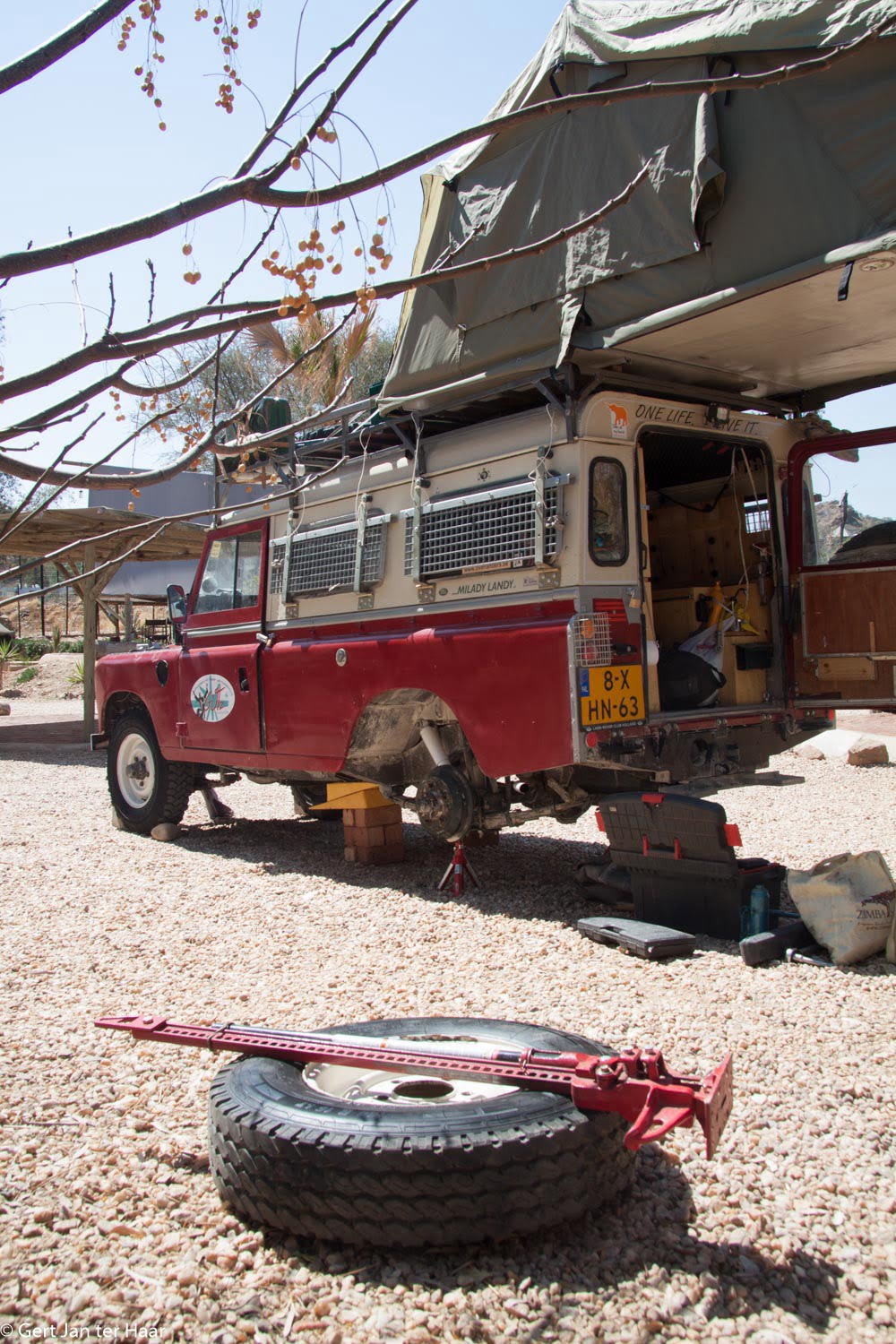

Hi Jeff,
No, jacking up a high car like the series land rover just with the bottle jack is merely impossible. As you can see in the pictures above I already used stones and the likes to get sufficient height for the stands etc.
Yes, the car was heavy-ish, but being an old (1980) series Land Rover, it doesn't have superfluous equipment like an airconditioning or other car electronics or a heavy winch. We managed all terrain quite well with just the hi-jack, an air compressor to deflate and inflate the tires and a shovel to dig away sand or mud. As a matter of fact the total load was less than 2.5 metric tonnes (2.75 short tons).

I agree that the factory jack doesn't work for modified vehicles. My UniJack can easily lift my Jeep with 3" lift, and 35" tires. I carry two of these, because they are also jack stands. Add a Air-Jack, and I'm much lighter then a Hi-Lift (Hi-lift and Jack Stands versus UniJack and Air-Jack).
