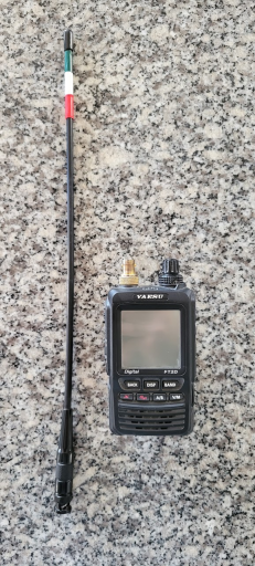

If you're only going to invest in one to start - go portable. Much more flexibility, here's some points to consider.
  • Identify your portable. I'm personally a Yaesu fan, hard to beat the quality (ICOM, Kenwood, etc. are all great). I'm just not a Baofeng guy. They work, yes; but you do get what you pay for and comms isn't an area I like to skimp on. You can snag a nice Yaesu FT65R or FT4XR typically for under $100.
  • Purchase an SMA to BNC adapter for use on the portable, which allows for easy antenna swaps (going portable or using 'mobile')
  • Install an external antenna on your rig, terminated to BNC on the interior. Focus on high-gain if you can muster the length. I recommend a proper NMO or permanent mount, this typically results in the best ground-plane. Higher-gain antennas will 'amplify' (of sorts) that 5W portable to a higher effective radiated power (ERP).
  • Purchase an aftermarket BNC antenna for the portable.
  • Snag a nice clip mount for the interior, RAM makes a nice portable mount you can use the belt clip with. This is what I use on my F800GS, but it's a typical RAM ball-mount and can easily be used in a PC.
  • Additional items for use in a vehicle to consider; snag a power supply of some kind and RSM. I found a USB adapter for my FT2, with a powerful enough USB port I can run this portable entirely off USB, I can also charge the battery. Other options include battery eliminators or 12v AUX to radio adapters. Another item is a remote-speaker-mic (RSM) for the portable so you aven't having to articulate the portable itself to transmit.
    With all these items you now have the most flexibility for your money (in my opinion). Use this radio on a hike, around camp, in the rig on the trail, in a rental on a trip outside your normal rig, in the house, etc. All told I still have dedicated radios in my vehicles (FTM400XDRs) but this portable is part of my EDC, I run it on the bike as my primary and I know I can always use it portable if need be for in-camp or if I dismount from the rig.
