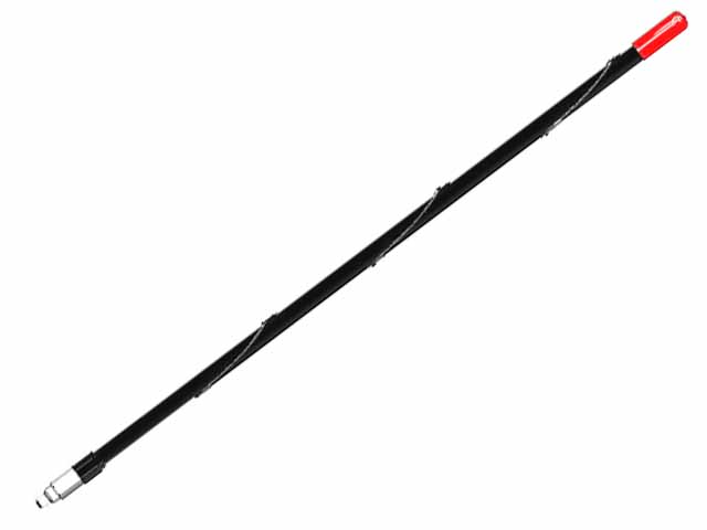

Can you attach a HAM to a CB Firestick for better distance?
1Louder
4,187
AZ
K
1437
K1LDR
Antennas are not the same. Firestik does make a ham antenna though. It’s also not that simple. Like any antenna location is everything. The higher the better. Some may argue the coax cable is different for HAM and CB but I have not had any issues with using the same mount with the different antennas.

I am going to muddy the water a little bit.
Can you use a cb antenna for ham radio? Sure.. it's just not as easy as plug and play.
It's typically a 102" whip (really a 10m antenna but commonly used on CB) and requires an antenna tuner or loading coil and is used for HF frequencies.
But it won't necessarily improve the distance over any other mobile HF antenna.
I've cut down a 102" whip for a 6m antenna before. It worked good but 6m isn't useful mobile (at least in this area).
Now, to further confuse this issue, it's possible to build a matching circuit to get the antenna to "look" like it's tuned. It's hard to say how it'd work though. Probably some odd radiation angles coming of that sucker. The little coil type dummy loads for 11m (Looking at you Firestik) would be a nighmare of reactance and might even serve to short themselves out or appear as an open circuit depending on the inductance in those coils at those frequencies.
Let's say for the sake of simplicity, DON'T DO THIS. Can it be done? Probably. Is it going to be anything other than a convoluted mess of circuitry that only serves to lower your ERP and turn your output power into a heater in the back of your rig? Probably not....

Just because the cable and connector is the same does not mean the antenna will "work" If you learn the info in the test instead of doing a cram session, you will learn that antennas are very frequency specific. CB antennas are designed for 27mhz normally. While that is close to the 10 meter band and can be tuned, it will not work for 2 meters and .7 meters and the mismatch can damage your radio.
He wasn't saying the antennas would work, just that the coax would work for either.
It was in response to 1Louder's comment that some may say the coax is different.
