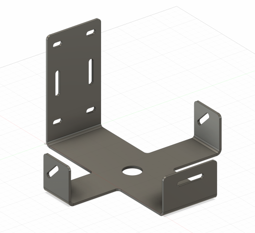

In additon to the various door panel and brackets, I have now also designed a bracket to hold our "trash container". We are going to use a large Bear Vault as our trash can. This needed a way to attach to the outside. Goals were easy removal and secure mounting.
Here's the sketch:
There won't be much if any weight on the rear bend, since the container will be held against the camper with a RokStrap attached to this little bracket:
So, I'm not concerned about stability. The flanges are mostly to conveniently hold the container in place while mounting/unmounting it.
This will all be mounted to the molle panel on the driver's side. The mounting holes are optimized for the hole distances and can be moved slightly left and right for individual adjustment. I've made sure that we can also mount it to one of our own door brackets if we ever wanted to.

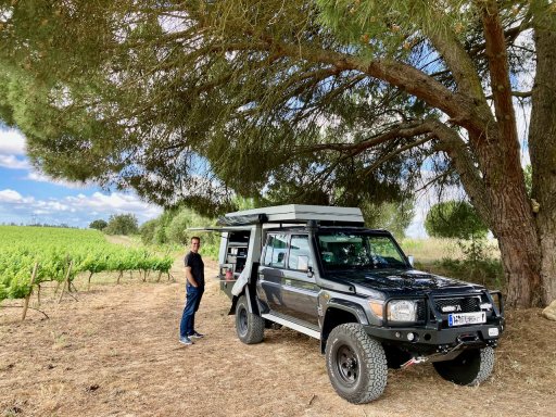

It has it's downsides. I'd prefer a Troopy (78) for lighter weight and smaller size, but the 79 is what we have. It's been a good rig so far. not nearly as comfortable as the Jeep, but we didn't have to build it either ... ;-)

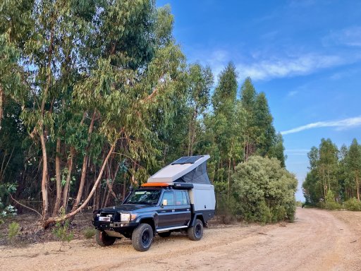

We've been traveling around Portugal last summer a bit:
Some fun trips, mostly in the Southern half.

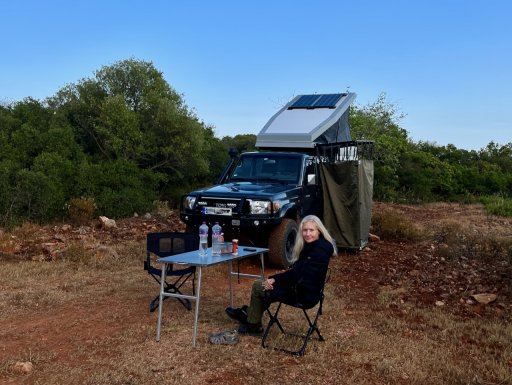

Mosquito tent done:
Big enough for two people to sit comfortably at a table and eat or just relax. Set up is about 3 or 4 minutes for one person.

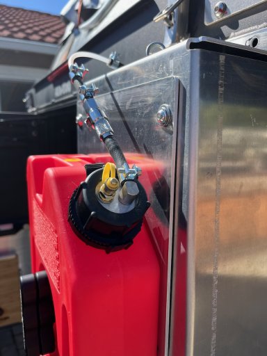

And the last few bits for the Webasto install:
Proper venting also through the cap:
UV protection for fuel line and rubber fuel hose connectors:
This is a velcro close neoprene strip. Likely not the final verison of this, but it'll do.
Thursday all the new metal parts to to the powdercoater.
For the fuel pickup and venting through the Rotopax cap, I made a prototype in aluminum I had here, then designed these quickly in Fusion:
When I went to order them, they were so cheap, I had to order a whole bunch of them to get to the minimum order value since I had no other ideas for metal parts right now.
So, if you want one, they're very cheap, let me know, I'll have plenty. They work with a fuel pickup and vents from Amazon, so not just for Webasto, but all kinds of diesel heaters, just as long as you provide fuel from a Rotopax.
