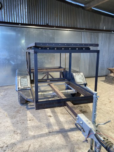

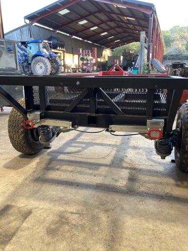

The departure angle is high on this design-it always looks like the axle is a little too far back though? I’m not sure how it will feel when it’s loaded. I half half a plan th put a removal mounting on the back to take my sons crf125-that will surely add some weight to the back- do you have a build thread for your trailer?
No thread yet but will try to get that going soon...
I don't think your axle is too far back. Not much worse to tow than a tongue-light trailer. Of course keep your GVWR in mind, but I can't imagine the tongue weight on your trailer being more than a few hundred pounds.
And I can affirm your thought that putting a dirt bike hitch-hauler on the back will balance things. I did that on my first teardrop build and it worked well. Let's just pretend I did it intentionally... :)

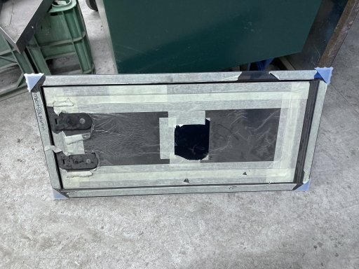

i have been pricing up some pre-made locker doors-for the 5 I need I will have to spend about £3000, so I think I might make my own

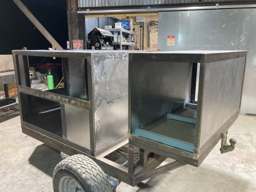

I have skinned the boxes with sheet steel- leaving gaps for the doors. I was offered a much better price on the pre made doors,so I bit the bullet-now have 5 doors ready to go in .
Next job will be getting some undercoat on to stop the rust.

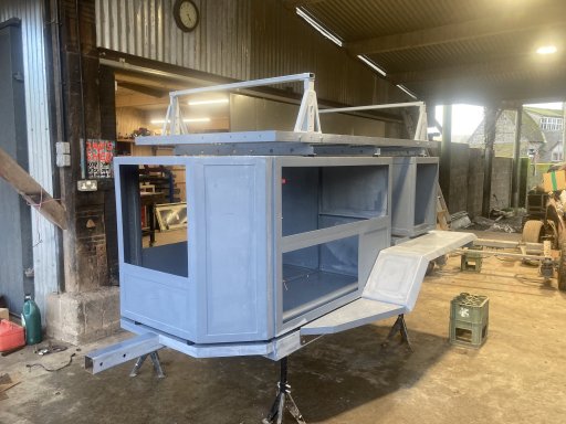

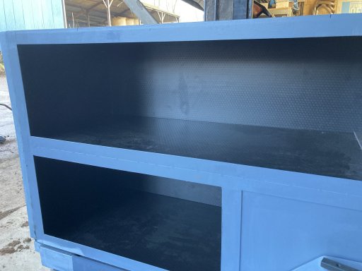

Got some paint on it now-next is a test fit of all the parts-I’m thinking to use rubber spacers to isolate the boxes from the chassis
tyndall
I’ve decided to use phenolic ,it’s more expensive,but will save the time and effort of treating it. I like the finish albeit a little dark.
