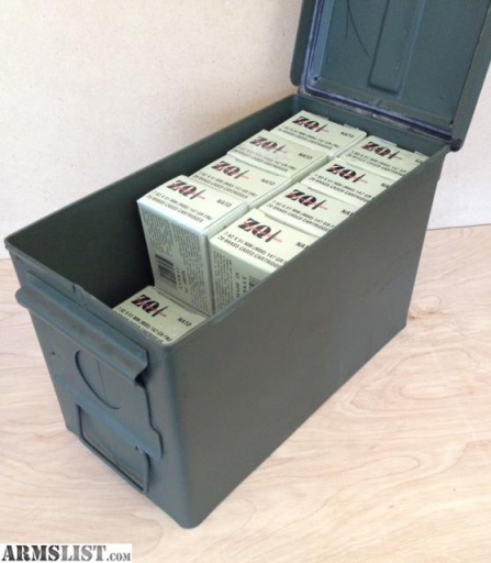

I also have bought this model (88 P). Did my research, and it received good reviews for price and function. Found this thread only recently, and glad others here have seemed to like it. I put mine in a 400 round Military steel ammo can, Being sealed (rubber gasket/waterproof), and protected in transit, it keeps it safely stored and has room for the optional extension hose and accessories, so it can reach my trailers tires. Makes for a more robust storage option over a bag. I have 285x75x16 tires (33 Inch), so it is nice that this compressor is adequate for my tires, without spending a fortune on a ARB Single or Dual.1566325456492.png
