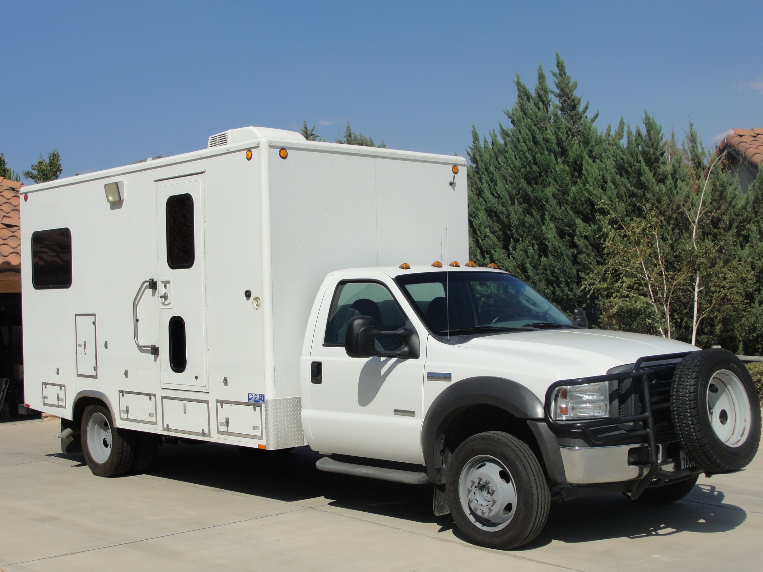

For a permanent box type camper, like the earthroamer turds that you posted. Get a 4wd F550 flatbed work truck, as long as you want. Add a Composite Designs box kit. You can also pick out super single Brush Truck Firetruck off road wheels and tires, but regular DRW work trucks are actually pretty capable. At least as capable as a camper needs to be. The box SHOULD NOT extend over the cab, that'll prevent cab off engine repairs.

Personally my game plan is a Ford F250 4x4, cc, sb, Fx4, e locker rear, $38,000. Add a front Yukon Autolocker, add 35" tires, maybe regear to 4.88.
Put a Bundutec Roadrunner on it's back, $35,000. For now, I'm camping in tents, and sometimes in my crew cabs back seat. Not sure if I'll stick to overlanding, so I'm ''roughing it'' on a budget for now. Honestly though, the camper will be mostly for travel, not overlanding. We'll see. Overlanding doesn't always have good bang for the buck, per day spent.
