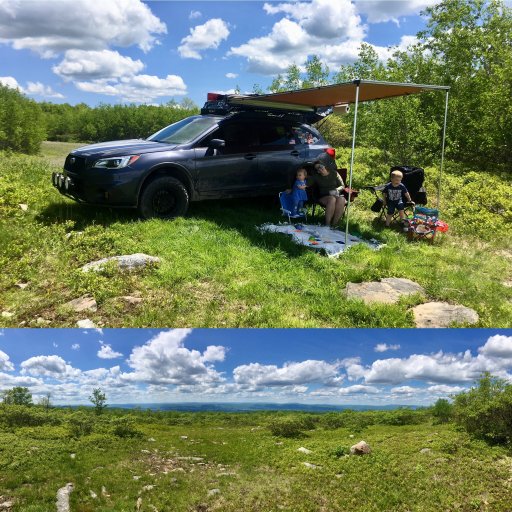

After actually picking it up the first time (3rd time they said it was done) I loaded it up and took the family for a remote barbecue. Had to test the drivetrain of course haha.

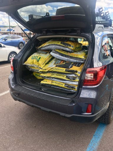

Next up was a suspension test haha. Threw 15 large saturated bags of mulch in the back and she rode like a Cadillac with no sag.

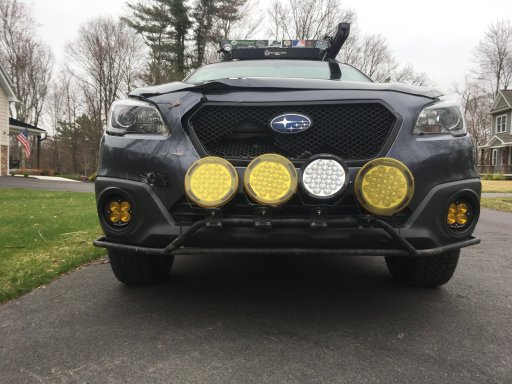

Went to aim the of road lights one night just to learn that the primates at the body shop managed to strip the heads of 7 (SEVEN!) allen bolts. Here’s the final result at 3 in the morning once I managed to get them all out and replaced.
The new look stealthy light covers.

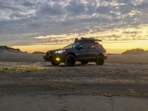

Most recently we loaded up the Outback for our annual family vacation to the Outer Banks. Managed to get out on the sand 3 days which was awesome. It had been so hot and dry so the sand was super soft. The first day I was out there were dozens of stuck vehicles all over the place. The 3rd day was after some rain and the beach was absolutely perfect. Perfect temps, tide, and a sunset over the dunes.
After 11 miles of soft 106 degree beach here’s the NC/Virginia border.

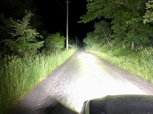

The night I aimed my front lights I snapped this picture. Not the best but it may give you an idea. I went with wide cornering to cast light at a wider angle but am a big fan of work or scene lights for area lighting. That’s what I have on the back and sides.
